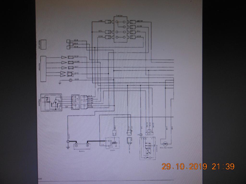

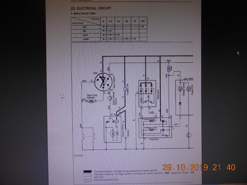

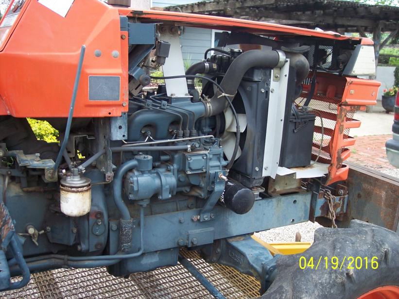

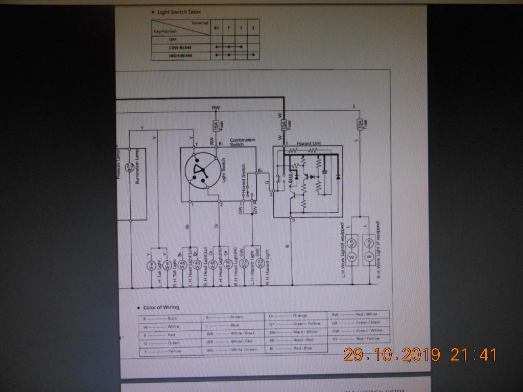

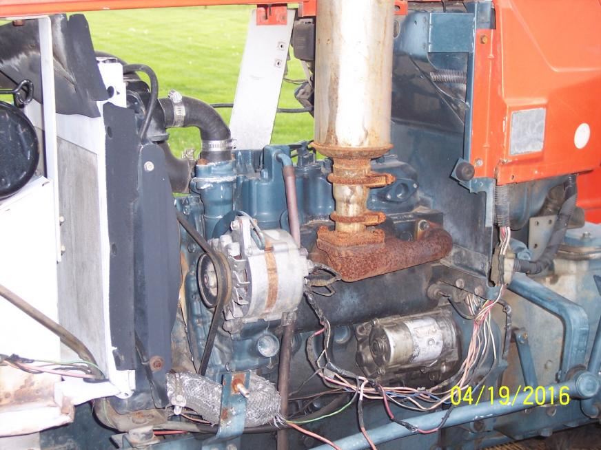

Thanks D2 those pics almost show what I needed. Did you end up getting rid of it? Wish I had that front grille looks way better than mine at the moment.
14,490
6,871
Thornious, I no longer have that tractor. I'll look and see if I have any literature with wiring schematics. Are you needing just the wiring at the alternator?
thornious
L2050DT
Mar 20, 2019
Zanesville
Yep for the alternator just need to know if the 3rd wire is hoked up if so to what, if possible to tell. Also if the negative on the battery is hooked to anything other than frame ground. Thanks again R
