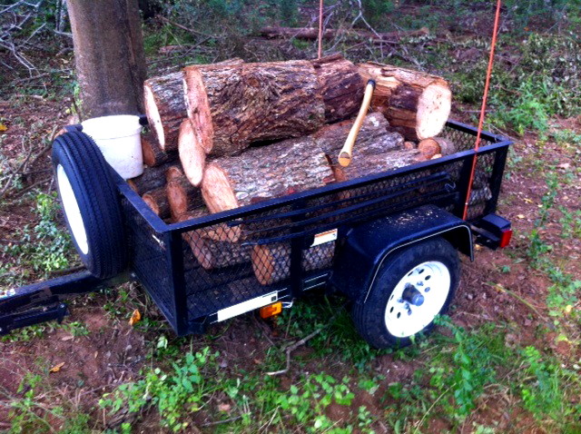

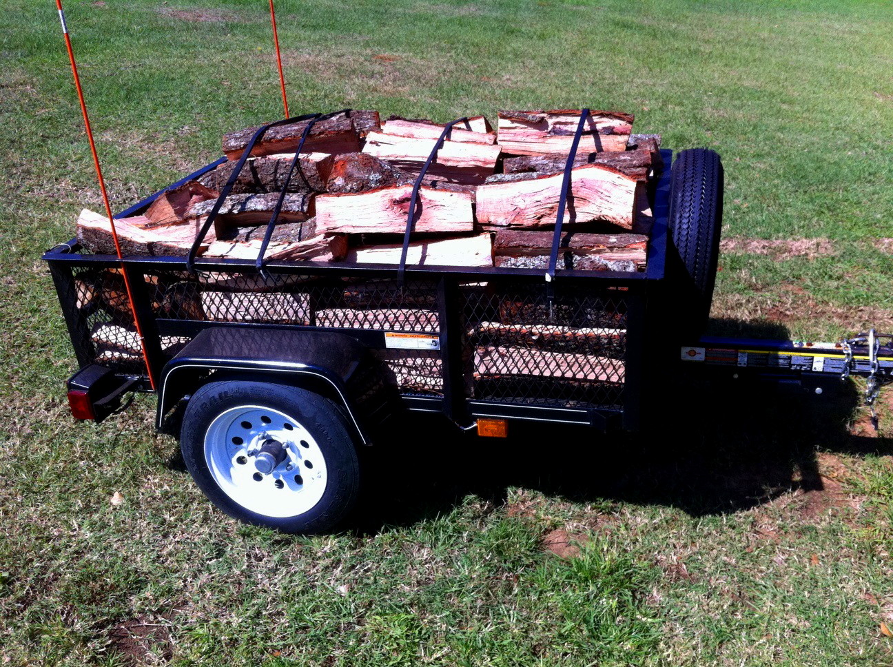

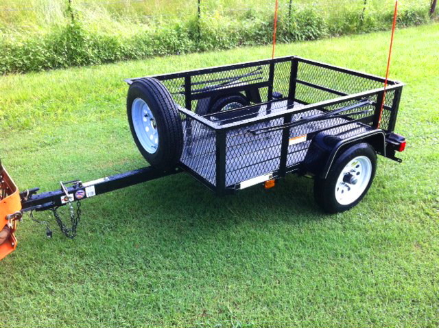

I just use a small trailer with a 1-7/8" ball hitch.
It holds up well for small loads of firewood and other small projects around the property.
I can pull it behind my tractor, zero turn mower....or vehicle.

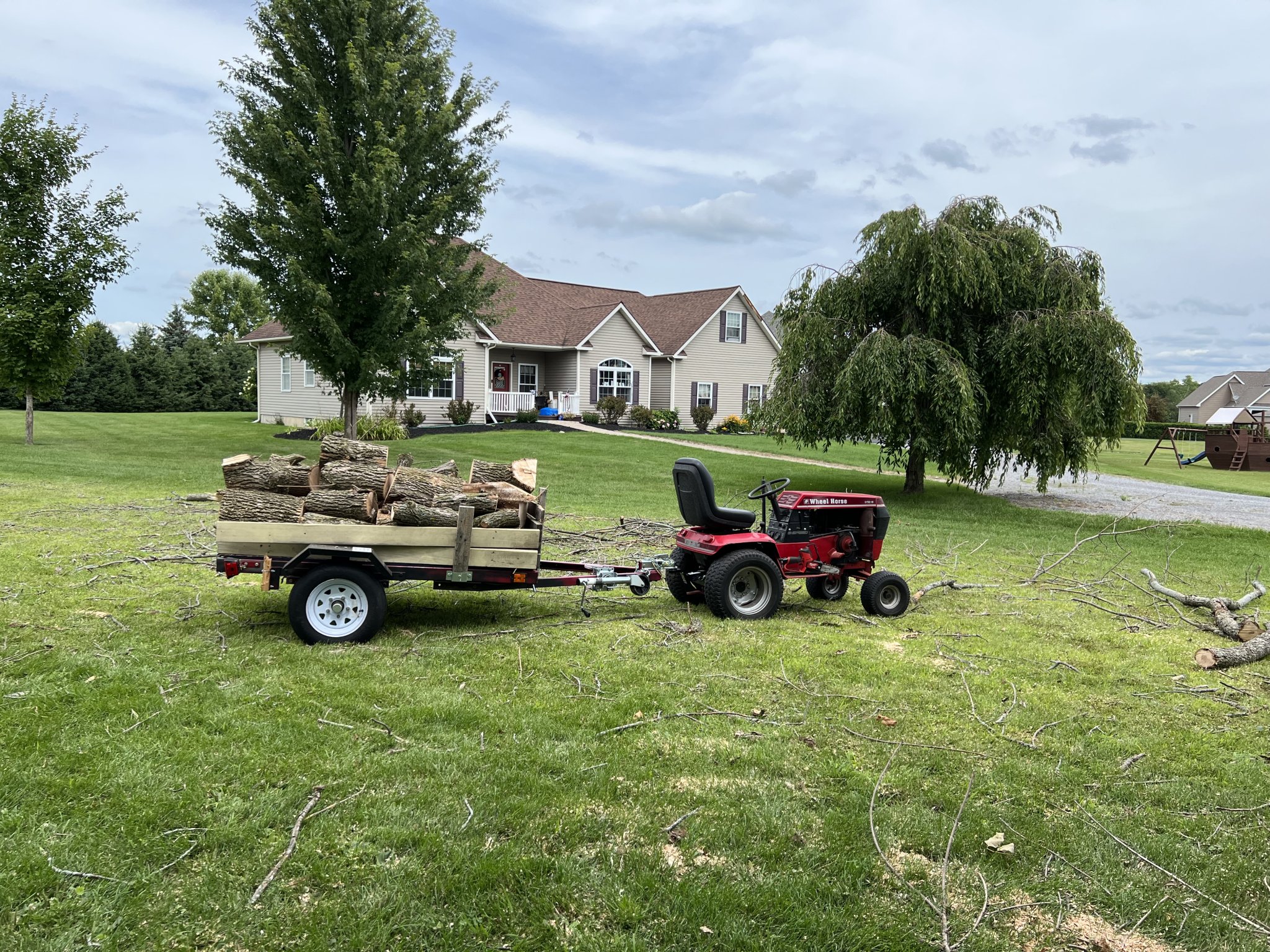

New here and don't yet have an Orange Tractor, but I pull my small utility trailer with my garden tractor. The trailer has taken a beating as a tree fell on it after a storm last year and I have yet to "fix" it. LOL

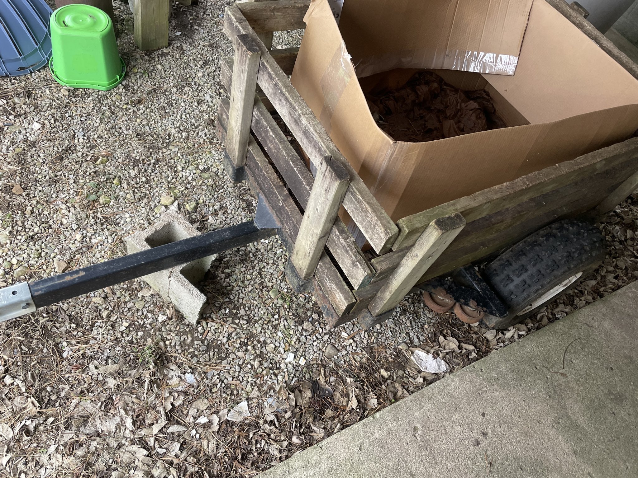

I think the hoist that arml has would be a helpful addition….that being said these pics aren’t the best but I use a homemade unit behind my atv and the B. The Axle is from a jet ski trailer and the wheels are atv. If planning to design ine, IMO key points are proper tongue height (especially for an atv with a fixed hitch height) and a longer tongue than you think to help when backing. There are some rollers on the sides so as not to get hung up on a tree…it sort of rolls and allows trailer to shift itself over…very helpful. Depending on your woods and how you drive fenders will fold/crumple easily. 🥃
