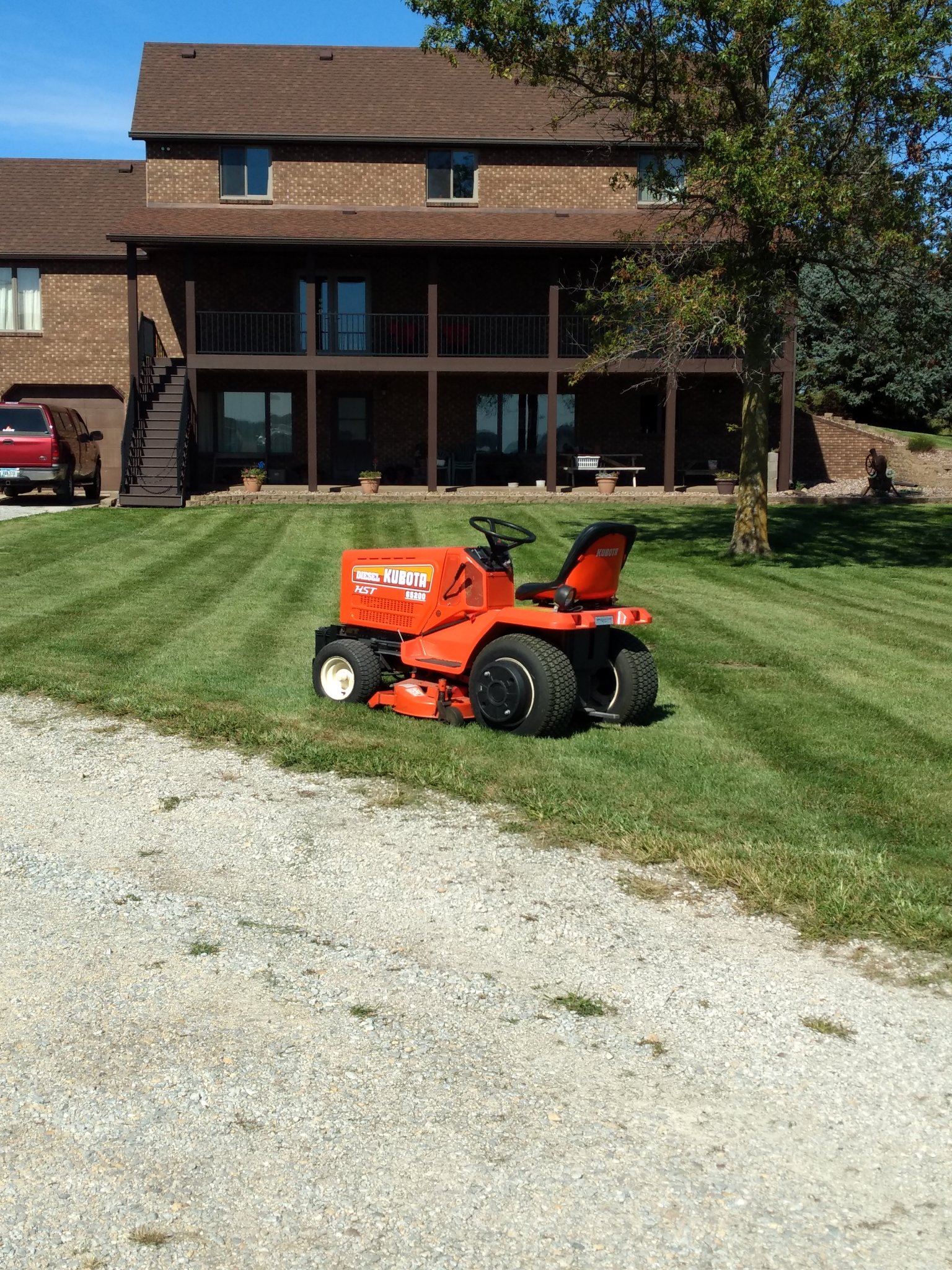

Does anyone know where to get some wheel weights for a G5200? I am having a hard time finding wheel weights. If nobody knows where to get some, should I give up on looking and just put fluid in the rear tires?

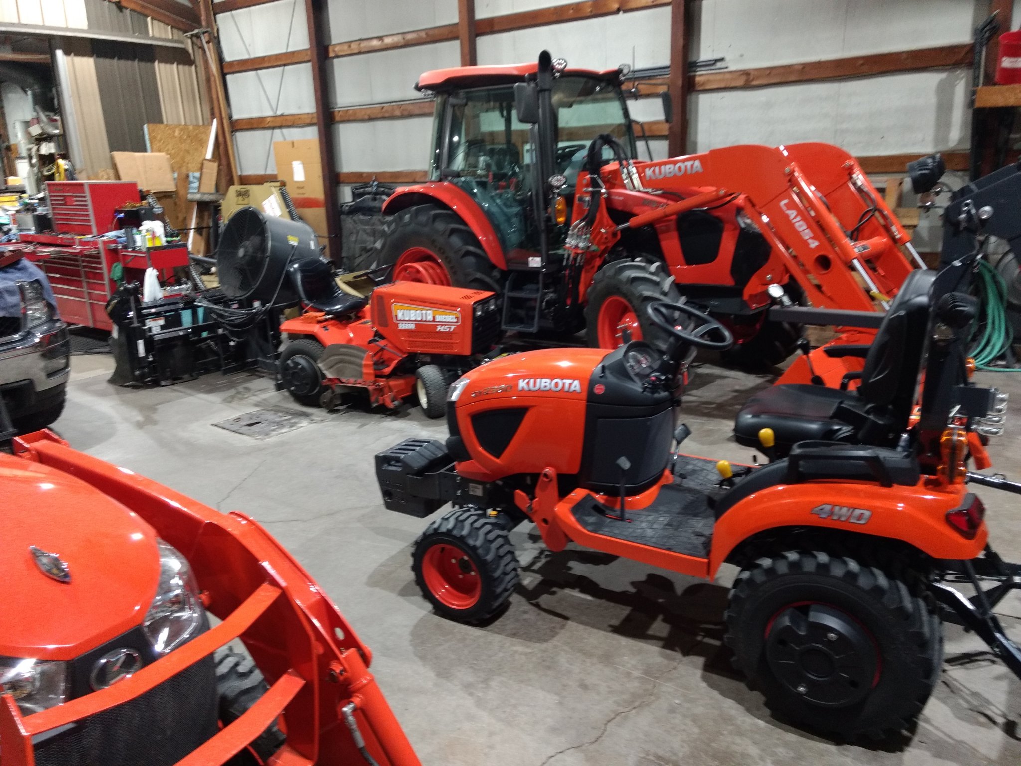

The weights I have on my G5200 are the same rear wheel weights that I have on my BX2380, they are just 12" wheels.
