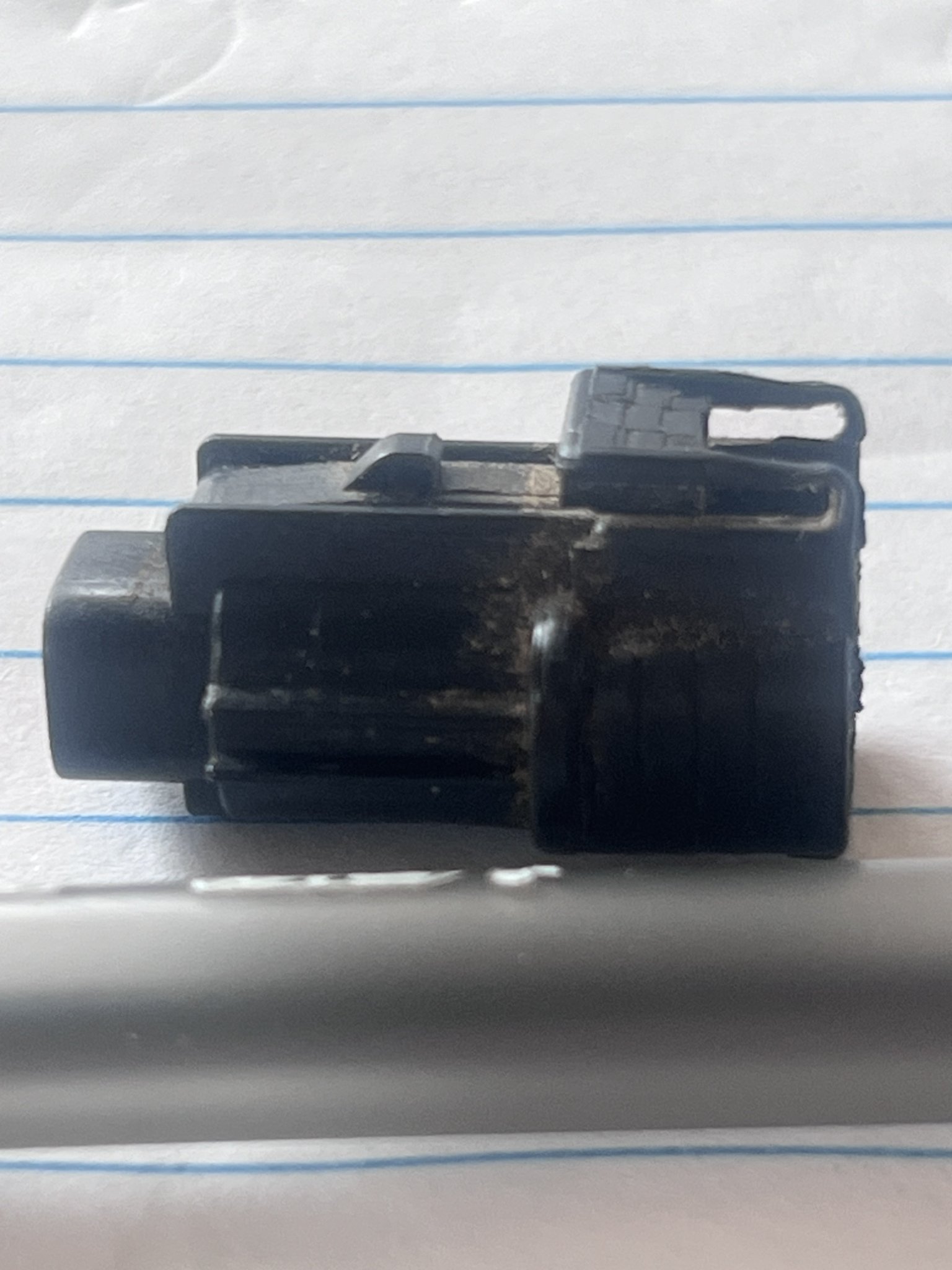

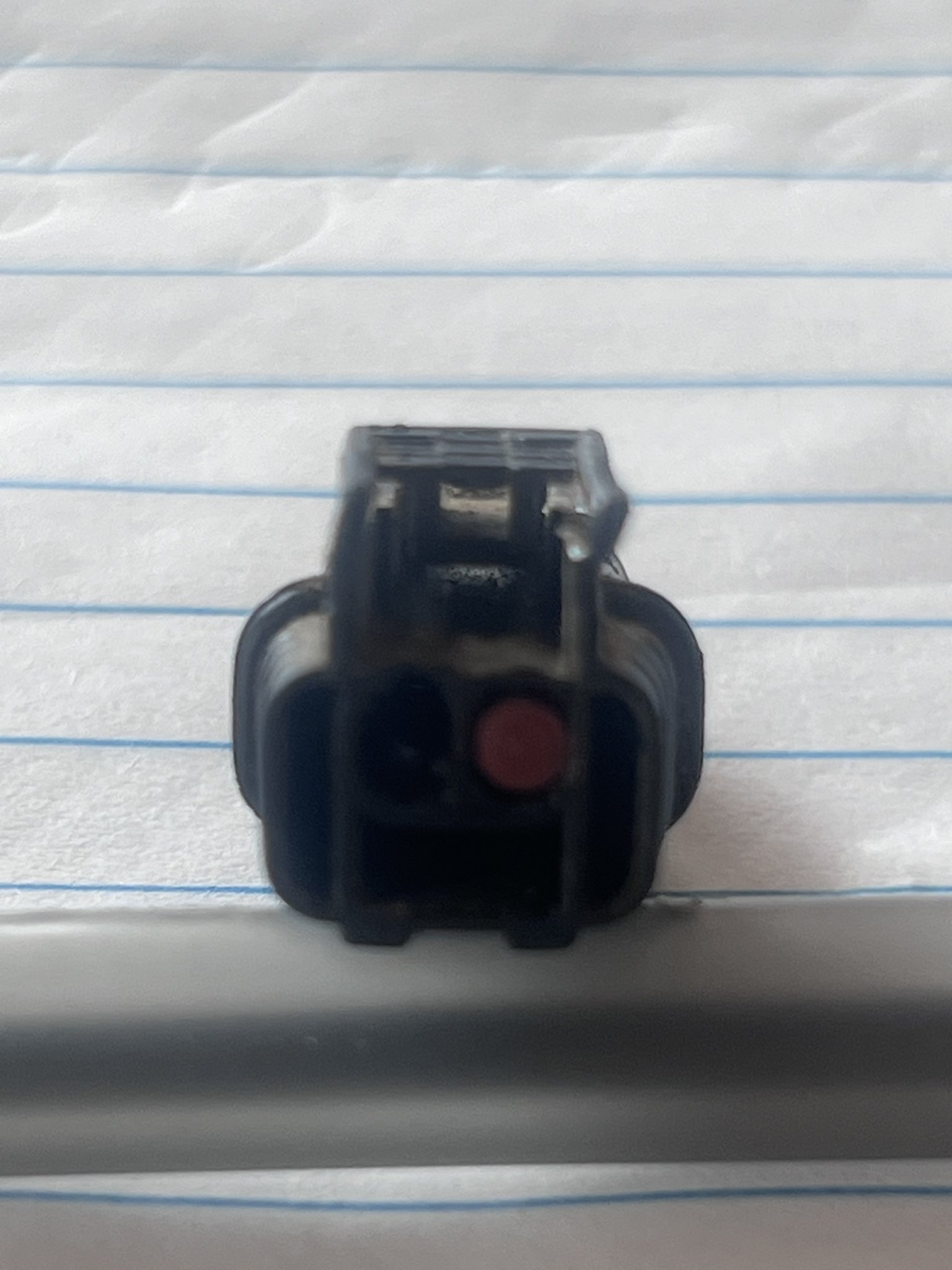

The plug that goes into the side of my transmission (I think) that sends the electrical signal for the pto to engage has had the wire come out. I pushed the pin back into the connector and plugged it in and it worked for awhile but then came out again.
No luck with Kubota or Messicks on getting or figuring out the connector, it is on the end of the rear wiring harness
I’m sure it is a standard connector, anyone have ideas? I want to buy one with the wire installed so I can splice it in Kubota wants $1350 for a full harness
included pics if someone recognizes it, about 1” long for reference.
Thanks for any suggestions!

If no one comes through with a source show it to an auto parts store specializing in Asian built cars and trucks.

I think I would try a drop of giue on that pin.

Wow, thanks for the great replies. I think I’ll take a picture of the terminal on the wire first so I have what I need to try and track one down on that site, and then glue it in there to try to make it work. I think the terminal is still on the wire
if I find anything besides super gluing it I will post here what it is

Wow, hat tip to Dustball! Thanks for that investigative work…I will see if I can find one now, much easier with part numbers (at least usually)

Kubota part number for your connector should be HHT1K-91103.
Should be readily available for any dealer to order from the mother ship.
They should also be able to look up a photo of the part so you can verify.
It sure looks the same to me.

Took me a while, finally found it. The problem is that I'm not sure you can find a vendor for it.
Furukawa UW02F-B
Dustball, you saved the day! I have the same problem and have been trying to figure out ways to fix this. Kubota should stock this retainer with about a 6 in. pigtail. The weakest part of this setup is hte wiring where it's crimped to the terminal.
