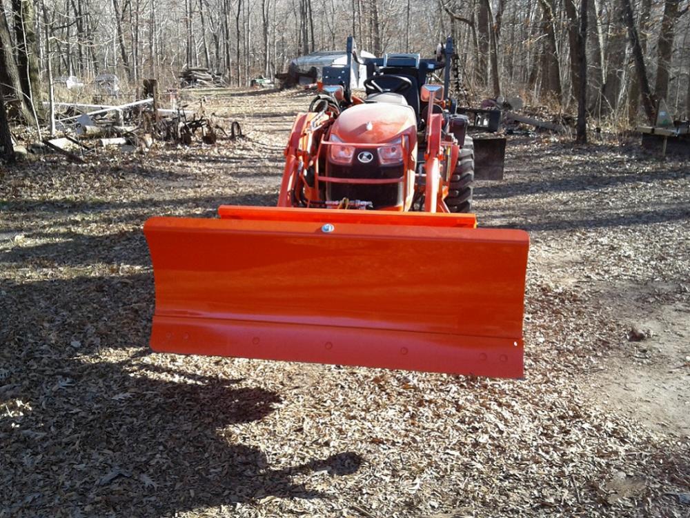

I use the Kubota FEL mounted blade on my B3350 but only on asphalt. I also use a ballast box to counter the weight of the FEL and front blade.
Front chains will help steering considerably on crushed rock but are counter productive on pavement.

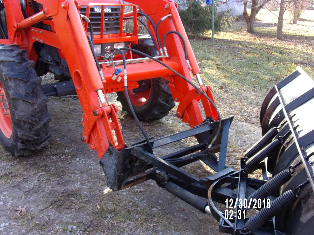

I have a large plow as well.... It's on the SSQA FEL hitch....

I have the Kubota plow. When you angle the blade you have to use the curl function to make the blade level. I have better results with the 3 point blade. Wish I could find wheels/casters to replace the skid shoes on the blade.

I use the curl and the third function to angle the blade. Make yourself a set is wheels to fit where the skid shoes now fit. many sizes on wheels and casters available at harbor freight and tractor supply.
