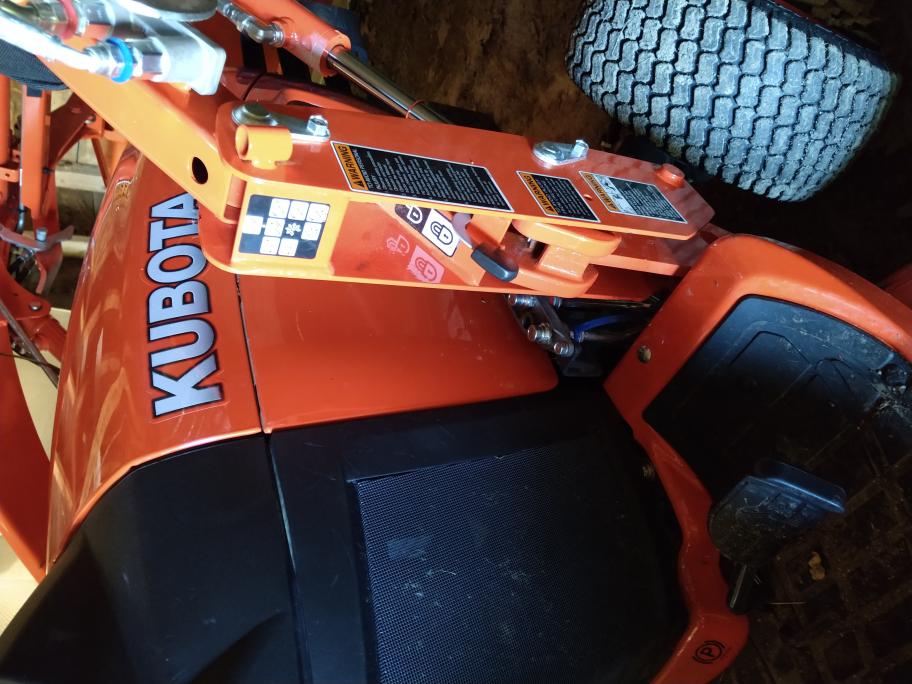

I got myself in a very weird situation on uneven ground, with a crooked FEL having to be put on with the aid of another tractor. (Don't ask.)
So now the FEL is locked on, but the arms of the FEL are set in a way that I can't place the quick connect hydraulic on. Can't see how to get out of this.
Will try to put a photo in the next post, to show what I am up against. Do I need to somehow release the hydraulic pressure in the FEL so I can manually move the arms?

Loosen the hex nuts that secure the fittings to the hydraulic block and rotate them to he position where they will connect. The retighten the nuts.

Thanks. I don't think the fittings (I assume you mean the nuts that hold the hose ends in the quick connect fitting) are an issue. It's more that I cannot put the entire quick connect anywhere near the female end, because the FEL arm is in the way. The black handle of the quick connect is at a right angle, and blocks me from trying to make the connection.
I wonder about removing the locking mechanism by removing that hex bolt that it swivels around. Then putting it back on once the connection is made.

That's the issue, is that this was put on manually with the aid of another tractor. (Lifted the FEL into place with another FEL from a second tractor. The FEL was initially removed on uneven ground and couldn't be put back on normally.)
So the arms of the FEL are in a position where I cannot connect the hydraulics. Trying to find a way out of this, either by removing the locking arm of the quick connect, or moving the arms of the FEL into a better position. (Pperhaps by releasing FEL hydraulic pressure manually?)

I would think that if you take the handle off and use a wrench to turn the cam would work. Then either raise the FEL arms off and put the handle back on or see if you can get it on with the FEL where it is.

I don't think you will be able to maintain the hydraulic connection without the locking mechanism. I think you'll need to take the FEL off, connect hydraulics then reposition the loader arms so that you can attach the loader. Just my $.02.

Looking at it I don't know why you couldn't remove the lever install the coupling and then put the lever back on (this is unless the tower is in the way of the lock bolt going back in), all of this while the tractor is not running (do not start it till the lock is back on an in the locked position).
You might have to loosen all 4 line to the cylinders to release any pressure on the couplings in order to connect them. ;)
CAUTION NOTE: You have the loader up, if you loosen line fluid will go flying and the loader will drop to the ground, you need to support the loader in the up position or have a rag over the fitting and a bucket, even then it's going to be messy!
You would be much better off taking the loader back off and connecting it properly!

Without the hydraulics, I don't know how to take the FEL off. Unless I get my neighbor to physically lift it off with his larger FEL. The loader is up off the ground.

Possibly! I'm going to call the dealer on Monday and email him the photos of my silly predicament. I cannot figure out how to take the loader off at all, as the bucket it up in the air. I'd have to manhandle it off with another, larger Kubota that my neighbor has.

You dealer isn't going to have any other magical cure for your predicament. ;)

FEL is physically mounted to the tractor now, right? You can move it to level ground?
Once there, can you remove that lever, temporarily secure the hydraulic connections using a bar clamp or similar (engine off) then lower the boom by gravity before assembling properly?
Good catch from the picture Wolfman, I didn't even notice it when I look at the picture.
OP, be careful!
