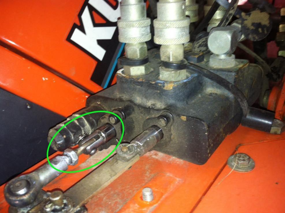

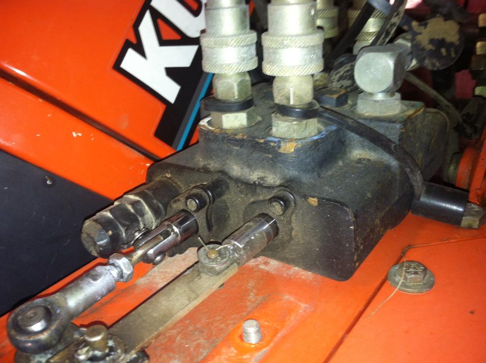

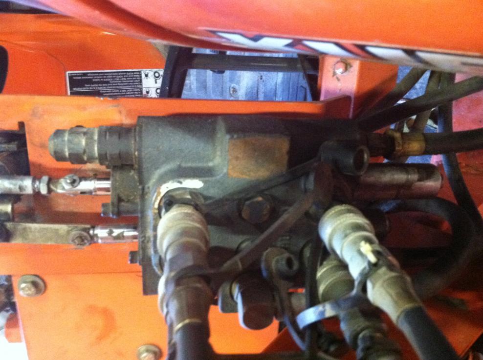

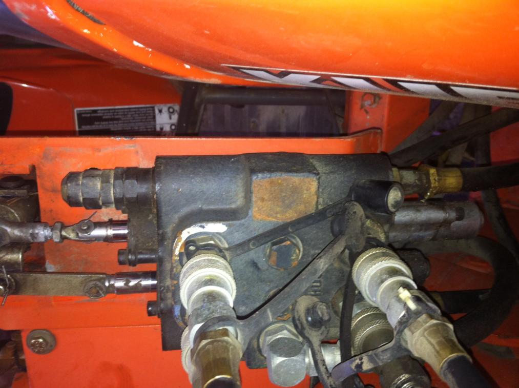

See attached photos. Thank you. If I push the control lever all the way forward it sort of clicks and the bucket will automatically trend down, almost like a float option but it doesn't float. I don't think this ever had a float option and I was told the detent kit was for float and non-float valves.

Is this the lift spool? Can that rod end be adjusted to fine-tune the spool position?
smauie
B2410, LA352
Aug 9, 2016
NH
Yes, that is the lifting spool and it is adjustable. You can see the lock nut is loose because I tried various adjustments with no luck. It seems like the weight of the joystick pulls that lifting spool just slightly enough (1/8") to cause the bucket to rise. I tried lengthening and shortening that rod but it didn't help. Although I have yet to try it fully shorten, perhaps that is my problem?
33,463
8,743
If you have adjusted the rod back and forth and still acts the same, you have a cracked valve body or a severely scared valve, it's leaking fluid around the valve.
Only repair is to replace the valve body, and or valve body and valve, so in essence the whole valve.
To confirm this, just remove the detent off the valve, and then slowly move the control rod back and forth, if there is no neutral it's a crack in the body or damaged valve.;)

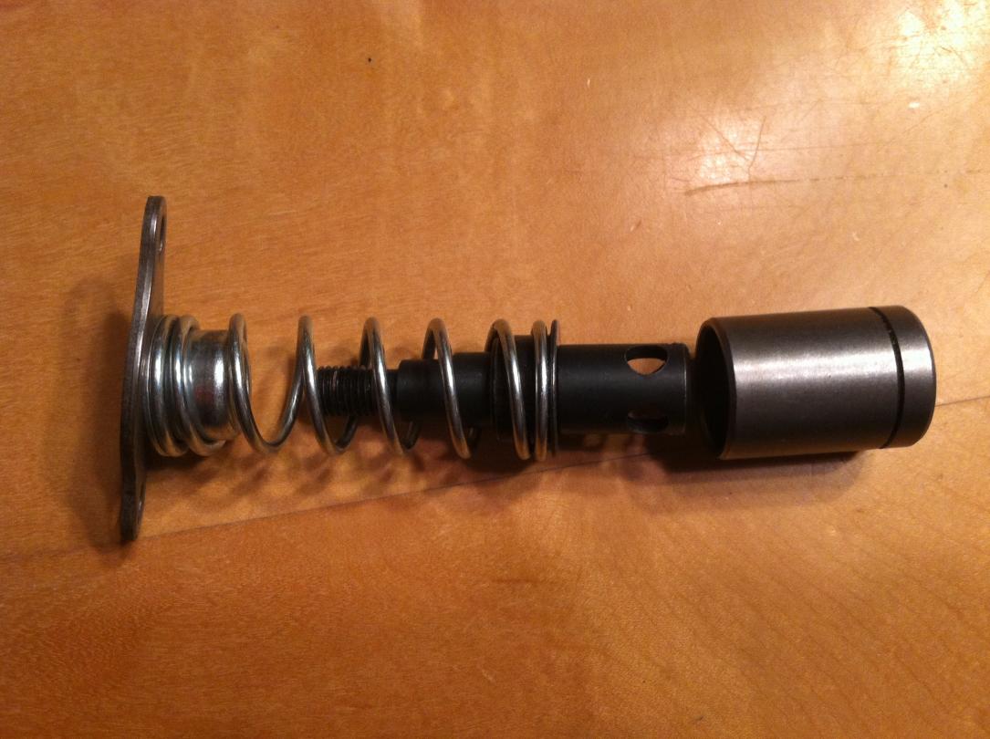

I cracked the detent rod when I was removing it so need to go purchase a new one again. I'll get pics comparing the old/new. The kits seem designed that you can only assemble them in 1 way so I can't imagine it being assembled any other way.
The new kit did come with a washer that I did not use as the diagram never showed that washer and my old one didn't have a washer either. The washer seems to fit on top of one of the spring caps which might serve as a shim for my particular case. It just might be the little difference I need to get that spool into the neutral position.
Based on my previous post, the test I conducted found about 1/4" travel on the spool indicating the neutral position. Based on that, do you feel my valve is good and its more likely with the detent assembly?
33,463
8,743
Yes a 1/4 of travel in neutral sounds perfect.
So yes I think it's an issue with the detent.
smauie
B2410, LA352
Aug 9, 2016
NH
Attached are pics of the assembly. The new kit has a black spring retainer which goes on the detent rod. The old kit's spring retainers were identical so either one could go on the detent rod or on the spool. The new kit is a bit more specific.
