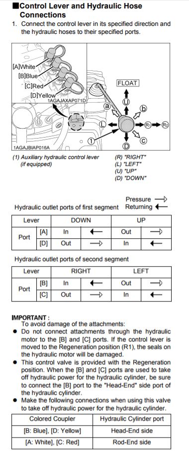

See if this helps - not 100% of original post
this is from the manual:
