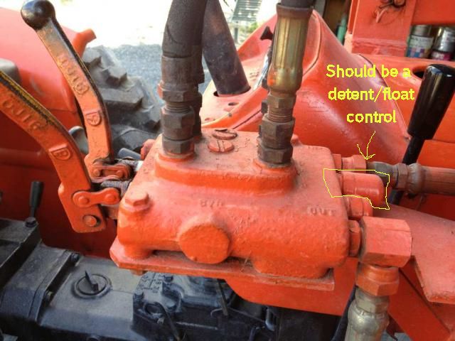

Here's a pic showing my control levers.

Looking at your valve if the inside lever is up and down you should have the detent/float control on that valve. The detent "locks" the lever in place for it to allow the loader to float up and down.
If it's not working it could be that it just needs the valve rebuilt.;)

I'm guessing you have the float function with the lever held all the way forward, what you don't have is the detent that holds the lever forward, a common problem with this particular valve. (I have the same one on my B7100) The problem is probably in the cap that NIW highlighted, the detent parts rust away, and they are no longer available. Try the test suggested above...... when I need float I just hold the lever forward.
