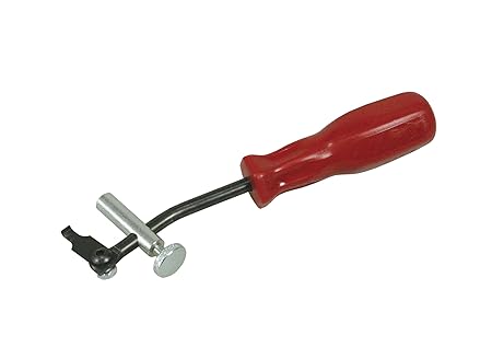

IF I can get at it, the tool posted works well.
The hole and screw method works if you can't get a seal puller in there.

Looks like harbor freight has a similar one. I'll swing by and get it after work. Hokie, how do you get through disassembling anything without using the F work more than once? Thanks all.

If there is a shaft, then the screw method is preferred, as any seal removal tool may nick the shaft. I often use the screw method with a claw hammer or a wonderbar.
Shaft removed, then pry bar or heel bar. I have an adjustable heel bar that is my preferred seal popper. Being adjustable angle can be changed to gain access or improve leverage. IMG_2759.jpg use mine often, this will be my next set when i break my princess auto one.
