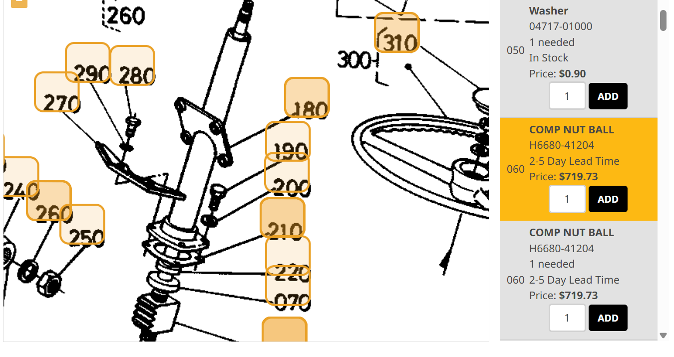

But nice, tight steering is such a operational blessing. Ironically the rod ends and 'pitman' are reasonably good except the rubbers are checked. If I could be sure to source OEM replacements I'd just fix it. @North Idaho Wolfman : pretty please, could you zoom out on the exploded view in post #19 to include the stem and the part numbers?
Appreciate y'all. Next up: when to do the repair? The ol machine is just as important in the winter as the summer. There is no good downtime. The B7100 goes places and does things that Big Bertha can't get to or safely.

Most of the internal parts are obsolete from kubota, that's the reason the aftermarket game is so big.
You can see all the parts and numbers here:
If you can't find the right parts let me know and I'll point them out.

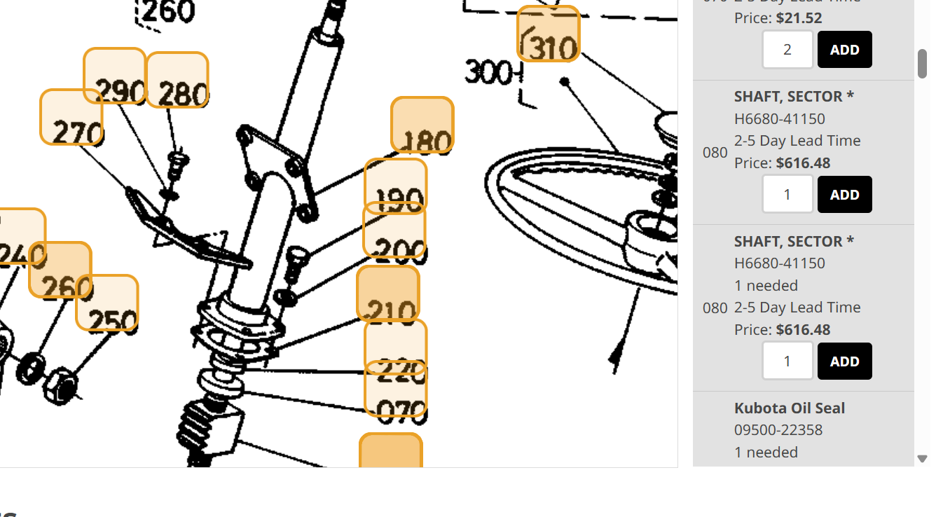

#3, 66811-41200, Comp, Nut Ball;
#5, H6680-41150, Shaft, Sector
For #3, I need two each - one for the tractor and, according to the wife, my Nut Ball is missing so I need a replacement. All my parts are obsolete too.

Do you have your nitro pills in hand and 911 on speed dial and a really good life insurance policy?
OEM will kill you!! :eek:
