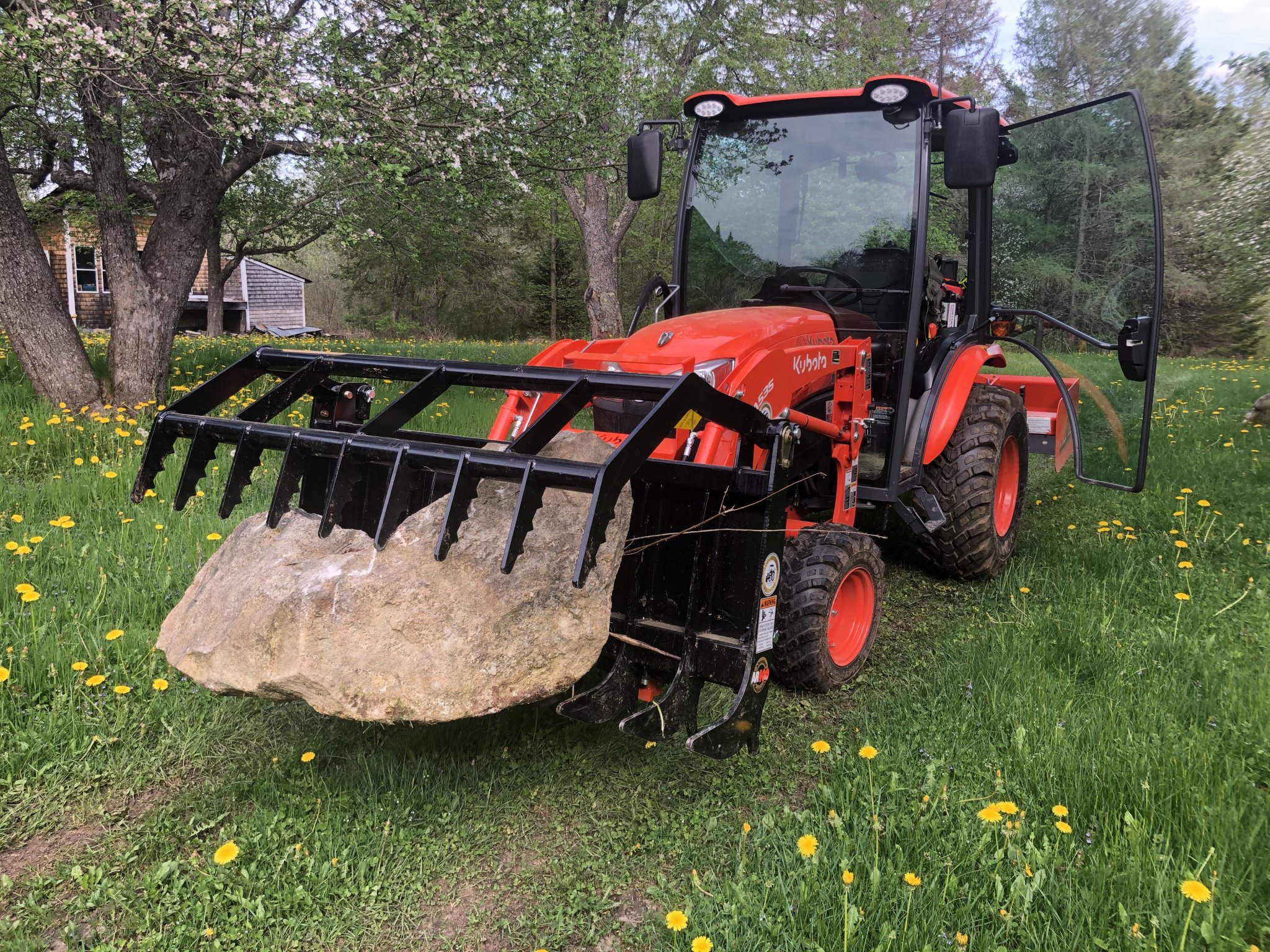

62DB17AF-4465-47F9-8505-4E9D2E7DCD77.jpeg Also, based on what a few locals have told me, I’d still go with a rear mounted pull type blower even with the LX. Keep your loader on for wet heavy snow that isn’t blowing great etc.
Lastly, definitely get 2” spacers not only for stability but so you can get tire chains on and off.
