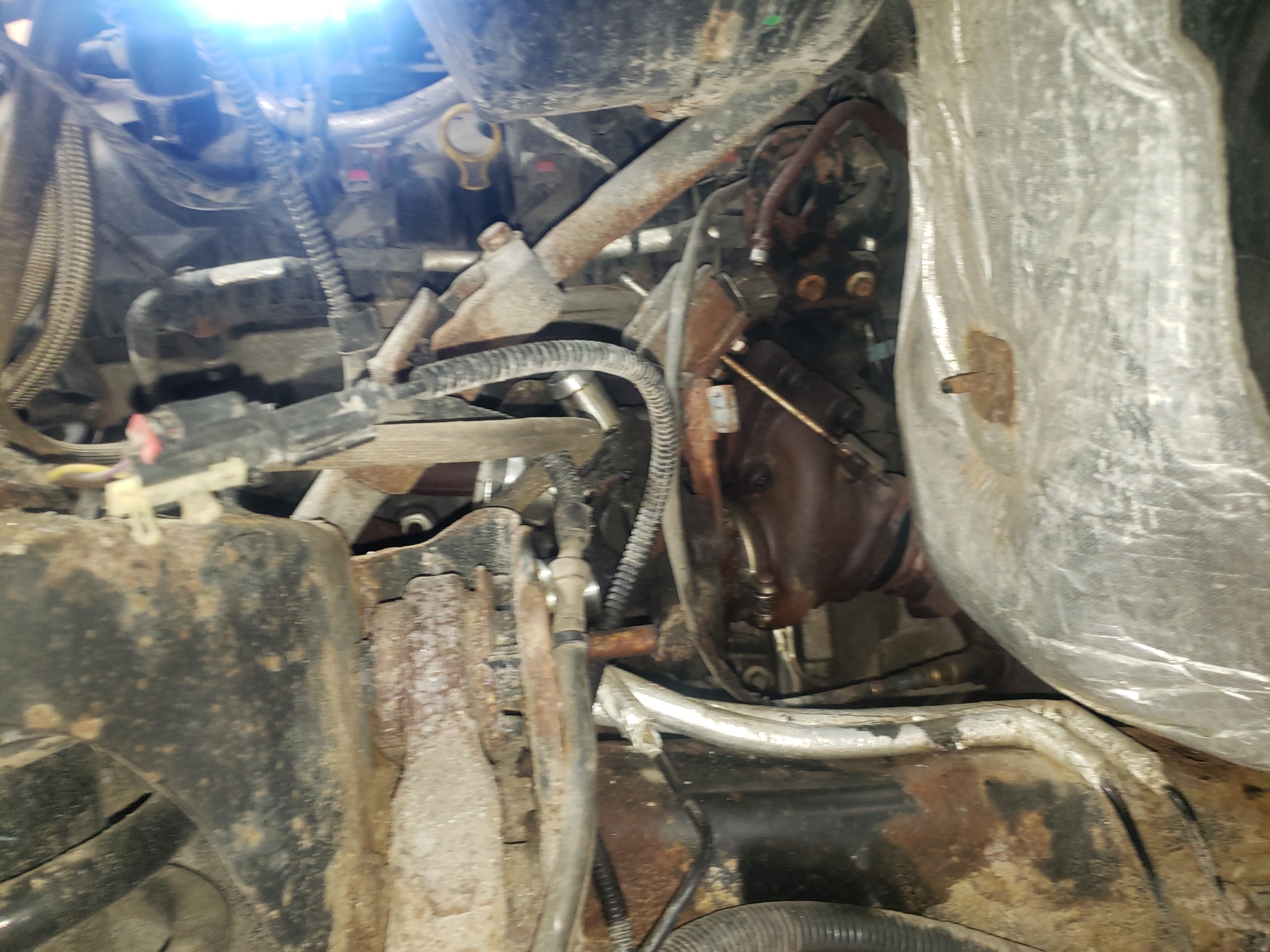

Thanks ford you suck. First time and last time owning an F150. Ive had good luck with superduties for work and plowing, they hold up well. But this F150 POS is pissing me off.
I bought it used with 110k on the clock. shortly after coolant leaks and exhaust leaks. have to roll the window down in the morning so i dont die of carbon monoxide.
ANYWAY im 8 hours into putting in exhaust manifold gaskets. 8 hours to get the turbos out still have to take out the warped manifolds....grrrrrrr
Both manifolds warped and rear exhaust bolts broke.
Ford was nice enough to put the turbos in a real easy to access spot too. Manual says to remove the cab for this job.
through the wheelwell
even had to take the starter out
nice spot for the turbo ford

I hope you got a good deal. Fwiw, Ford Mechanics can get an entire cab off in less than an hour. There are videos that prove it. I'm not sure what shade tree mechanics are supposed to do though.

While you are in there, might as well check that the turbos are ok. It does not look like fun.

lol took me 2 hours messing around with one of the exhaust studs from turbo to pipe. ended up torching it off. Yeah a little rust on this thing too.
