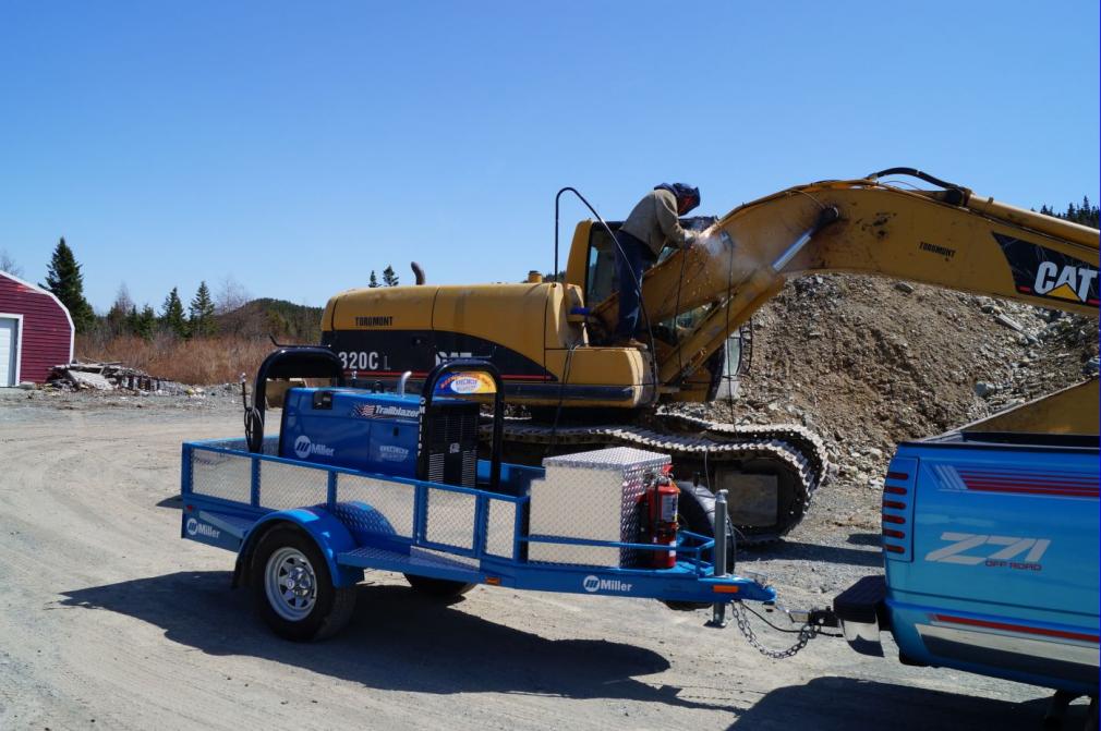

I have to agree with Eric on this one. Just to risky. They can crack. I welded up a Cat excavator just a few weeks ago becuase of a crack in it's boom.
