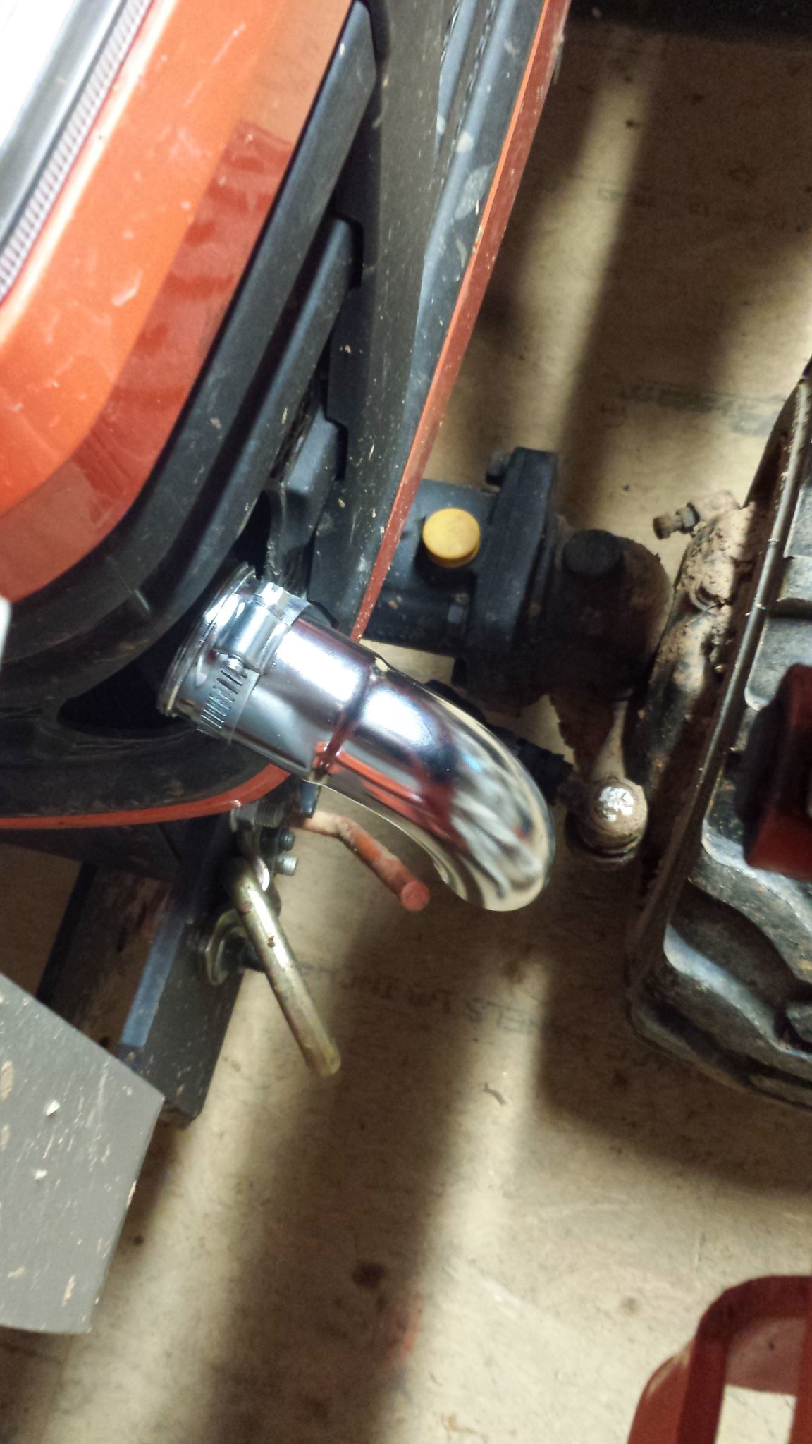

I have zero practical experience with diesels and I noticed today a lot of oily black soot on the left front corner of the frame and around the exhaust hole in the plastic grille after use (95hrs). I don't remember this happening before since I hose down the tractor after every use. The tractor had not been used in about three weeks with a couple of cold snaps in the 40's in between and the weather was around 70 degrees. It mowed fine with no black smoke except the usual little bit at startup and when changing RPM's. Anything to be concerned about?

Diesels are unfortunately somewhat "dirty" in the combustion - despite all the technology it is still a burning of an oil, and soot is a byproduct of that, despite the great technology behind the engine itself.
I think you will have that almost always - however, are you running the machine at a "high" rpm? That is actually better for the soot than running at lower rpm. The newer models will have a regen feature that ramps up the rpms to burn off the soot on a screen - low rpms will actually create a bit more of the soot.
You do not have this feature - which is a good thing btw.
Here is a long but very interesting read on the mechanics behind diesels and how slobbering is created and somewhat prevented.
https://apps.dtic.mil/dtic/tr/fulltext/u2/a151273.pdf
Despite this - there is a simple solution!!!! Got to the local big box store in the plumbing department.....get you a P-trap made of metal...... cut and clamp over the tip of the exhaust!!! Simply redirect the soot!!!

Thanks for the replies. I was just thinking if there was something I should check for like water or something else since we had temperatures in the 90's and high humidity all along and then we had some drastic temperature changes like an almost 50 degree drop in one day. No freezing though since we are by the coast but inland got there.
Maybe the soot was accumulating and I did not notice as the "gray turned into black" on the frame.
I have been mowing with the engine running at 2700 RPM.
The "elbow" solution for the exhaust might be tricky with mine since the grille rotates up when opening the one piece hood.
