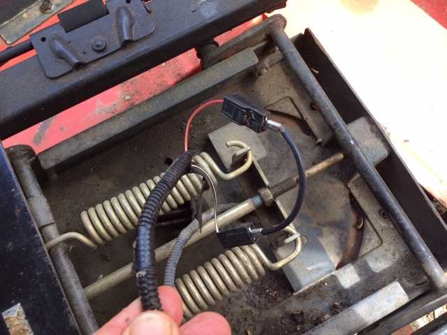

I bought the machine used from a rental company and I discovered that they bypassed the seat safety switch. Attached are photos of the switch and the bypass they did that I have not hooked back up. Just thinking about it now as I took these pictures, the ends of the terminals used for the bypass are exposed and just lying on the deck that the seat attaches to. If part of those metal terminals are touching the chassis, could that possibly be the problem? But if they were touching, the chassis, wouldn't that cause a short and blow a fuse? (that is not happening....the fuses are all good). The machine is a 2004 model year.
Just thinking about it now as I took these pictures, the ends of the terminals used for the bypass are exposed and just lying on the steel deck that the seat frame attaches to. If part of those metal terminals are touching the chassis, could that possibly be the problem? But if they were touching, the chassis, wouldn't that cause a short and blow a fuse? (that is not happening....the fuses are all good). The machine is a 2004 model year.

Yes bare connections on the jumper could very well be causing all your issues, I'm not sure if that is a ground sensing loop or a hot loop.
If it's ground sensing then shorting to ground could trip it and thus dies.
So start pulling the connections apart make sure they are clean and solid, reassemble and then wrap up the connections so they cant short to ground.

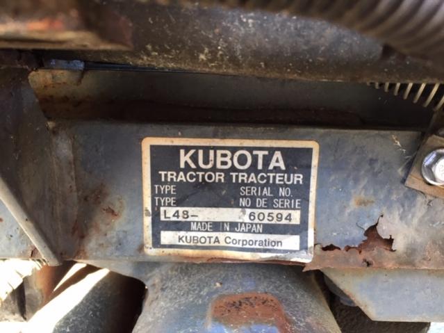

Wolfman, thank you too for all that information. I have emailed Kubota to see if I can get the correct schematic. Meanwhile, attached are images of the back cover of my manual (and it has a print date of 2000, so that would indeed be an old version) and an image of my serial number. Also, I went onto Messicks and downloaded the wiring diagrams for "old type" and "new type", just as you said there were. I'm going to try to go through the wiring harness using those diagrams to at least make sure that my connections are tight. I bought some DeOxit D5 contact cleaner to clean my fuse block and all connections that I mess with. I have a Power Probe III circuit tester and a Power Probe ECT3000 short circuit detector coming that should be here Monday, and I'll start trying to find the problem. I appreciate yours and everyone else's help.
