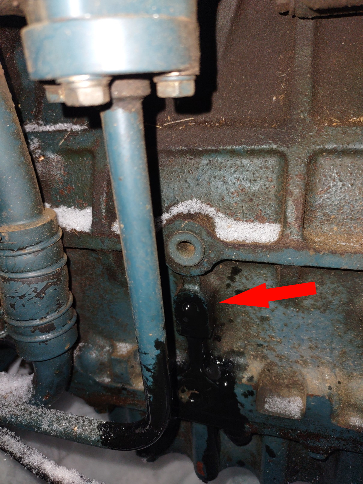

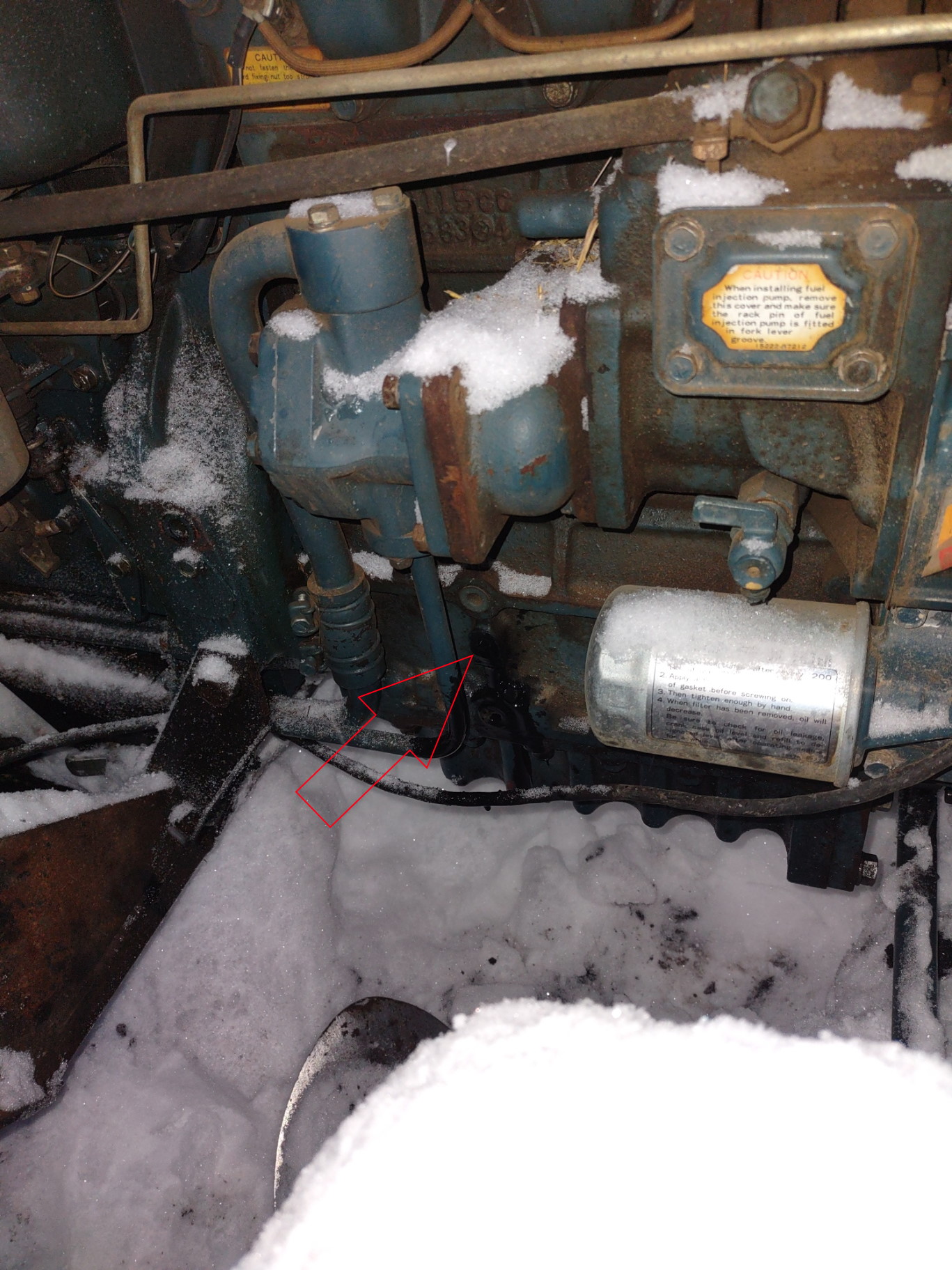

Hello all.
1979 Kubota with Serial L245DT-55880
Same issue as the OP. Started up the tractor in cold weather (mid teens) and the oil started gushing into the snow under my tractor. Oil only shot 2ft or so, but it was pretty thick since it hadn't warmed up yet. Snow everywhere, so recovery of the pin is unlikely. Haven't melted down the oil/snow mix yet to search through it, but I would rather just pay to make sure I have the pin on hand sometime in the next week or so.
I'm looking for the correct part number on this pin (see pictures for pin location).
It is one of the below part numbers, but I can't say for sure which.
15221-33630
15521-96020
15221-33640
15521-96030
34150-27580
Does anyone have any further insight? I can buy one of each if I need to, but I'm hoping to avoid it if I can.
Thanks,
Justin

Don't think that plug is a threaded plug, feel for threads first.
If does have threads, Go to North 40 and get a metric Allen plug.
If it does not have threads, a grade 2 bolt ( after the threads ) ground to a sight taper, then drive it in and then cut off extra.
34,545
9,779
Further Research, good to do when it's -14f outside, shows that that model came with both threaded and drive type plugs.
Only way to know is to inspect hole for threads.
Or search the ground, around where the oil is, for the original plug.

Old Kubota's used aluminum and then steel non threaded (drive in) plugs, till they finally got smart and changed to treaded plugs in later designs.
