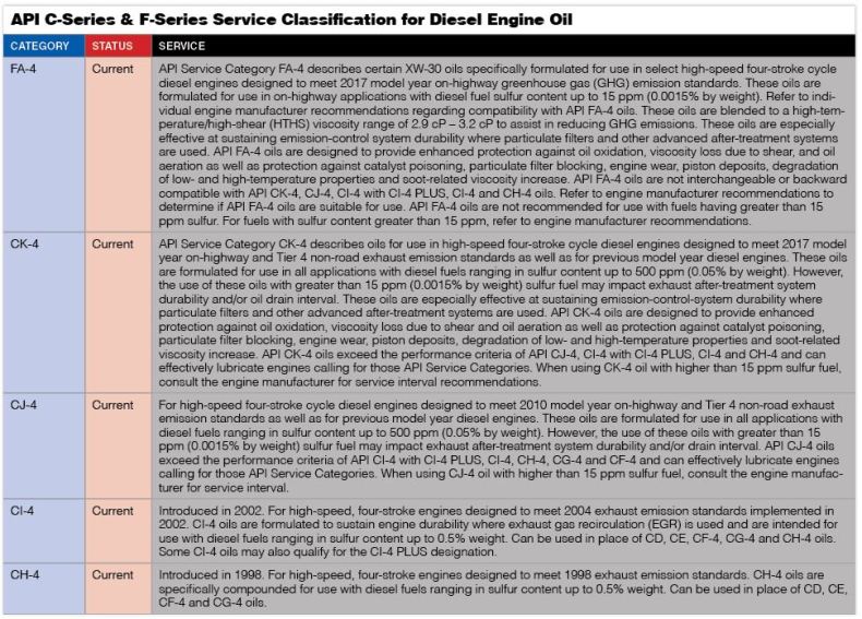

My OEM manual for my 2022 BX2680 states basically CF through CI4 but not CJ4. Does that mean CK4 cant be used? No, API ratings normally cover past ratings. Then they throw in the greater than 15 ppm sulphur, which was a 2006 on road fuel federal requirement. Not sure what off road diesel sulphur content is or what hoops I would need to go through to even be able to purchase it. I don’t think they could make it more confusing. Not too impressed with the clairity of the OEM manual. They don’t need to reference 20 year old specifications, though still active, that have been superseded by newer specifications.

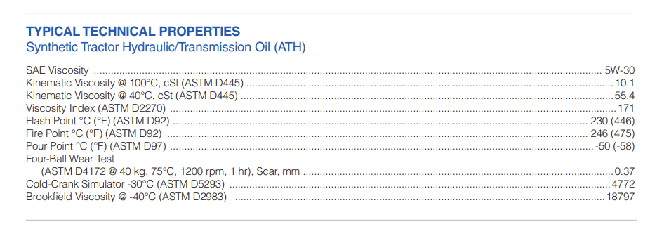

Here is the data for your Amsoil product. Higher viscosity than SUDT2 but lower VI. In terms of cold weather performance I would consider it somewhere in between UDT and SUDT2 and at double the cost.

SUDT2 is not available in Canada, only the Canadian version of UDT ("Premium UDT"). Which is different than the US version. MSDS with some specs here: https://www.orangetractortalks.com/forums/attachments/premium-udt-e-2012-pdf.22834/ No VI or -40°C kinematic viscosity listed though.
Interestingly, while the viscosity index of the Amsoil is higher than SUDT2, the pour point is lower. Comparable to Duratran XL at -50°C. But the lowest pour point of all is the (conventional) Canadian "Premium" UDT at -57°C. Kinematic Viscosity @ 100°C is the same as Deere Hyguard at 7.1 centistokes.
