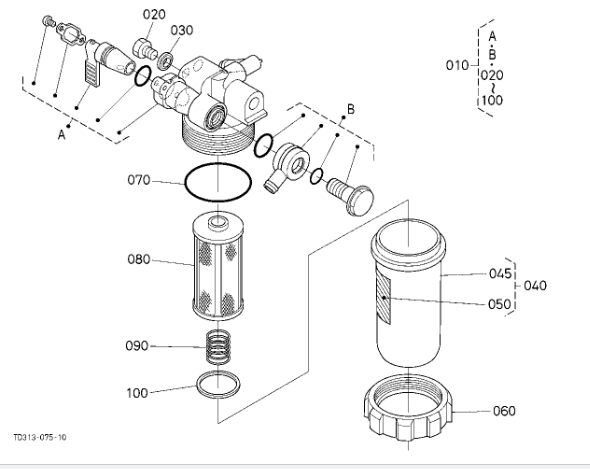

Now I get it! Thank you for that explanation. I have been pouring out perfectly good diesel fuel. Follow up Q if you don't mind. What is the purpose of the spring? Mine has disappeared somewhere along the way. I ordered another from Messicks but just wondering what it does.

Often times a spring is used between bottom of filter and bowl to keep the filter in place. If the filter drops down, unfiltered fuel could reach the injectors.
Some fuel bowls have a feature that stands proud to keep the filter from falling to far within the bowl.
Hopefully this is the spring you're referring too.

Ok, that makes sense - that is the spring I am referring to. So, not critical assuming that I make sure the filter is in place. Appreciate the reply.

Be aware an o-ring is typically used to seal the filter element to the metal housing. They can be lost or forgotten.
Typically o-ring is on ID of filter.

Good point but on his model there is only a bowl O-ring seal.

It is actually very critical because of this……. 👇
With a common rail system like yours, the cost to repair damage from contaminated / unfiltered fuel will make your head spin!!!

Don't scare him too much!
In this case it's not very critical at all, because that's NOT the fuel filter.
The fuel filter is next in line, so he's fine for now.
