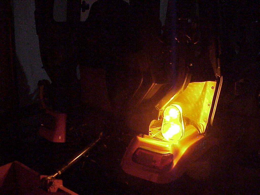

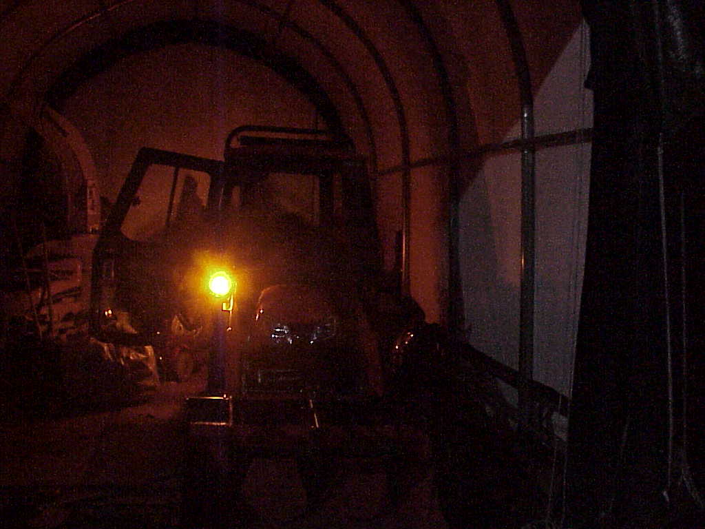

My BX23S has fixtures for the front and rear, and when the directional is on, the other side will illuminate steadily. It is this way for both front and rear lights. The 4-way flashers will not flash if the directional light is on for either left or right position. In the pictures below, the left directional has been selected and shows the right directional on steady both front and rear. The lamps in these fixtures are amber LED bulbs, and that is why they are so bright.

The flashers are probably on a completely separate circuit of wiring and fuse than the blinker so look at fuse box and see if it is missing or blown.
