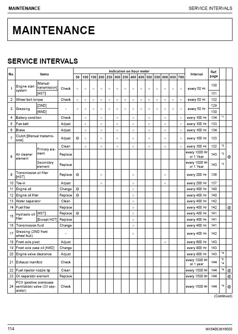

the manual outlines oil change intervals
If I remember right, it specifies 400, but then in footnotes elsewhere it says that in different conditions you should change it sooner. So you'll wanna read into it a little more.
4,667
1,003
That 400 hours is probably transmission fluid not engine oil
You probably are late on engine oil change but your manual will be the best guide or the dealer can tell you what interval is good for oil change

Yep, 200 hours on oil. Capacity is around 7.5 quarts, using a Kubota filter.

For those of you saying 200 hours for the oil change, I guess you don't read the manual. It clearly states 50 hours and then every 400 hours. Personally, I'll change the oil more often than that, but let's stick with the facts as specified by Kubota.
The transmission oil filter gets changed every 200 hours.
