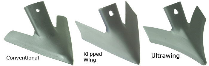

X2 on the keulivator. I use mine with the rolling cultivator to bury potato rows deeper. Not a big fan of the big sweeps on the keulivator, I bent one, because it's cheap chinese steel. Good thing is is that IH sweeps from old vultivators are plentiful and cheap at auctions, and will interchange with the keulivator clamps...
Oh, and Agrisupply has locations all throughout the South, I go to the one in Petersburg Va, about 3-1/2 hrs away. Same chinese junk as TSC, but they actually usually stock things in their stores, a novel concept that has yet to catch on at tough sh!t charlies...:D
