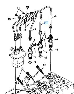

I saw a video online of a guy turning a little air bleeding knob. Based on the attached EV it looks like there is one on my model too. So I might try turning that also while cranking

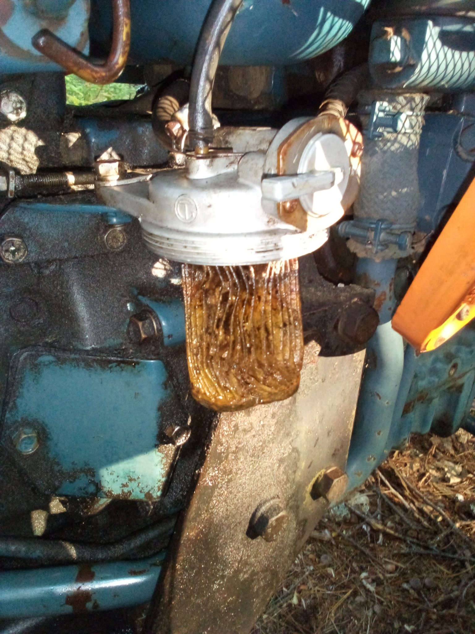

Minutes before shutting her down for the day, it mysteriously died and wouldn’t start again, seemingly from lack of fuel. Sure enough I checked the filter and it wasn’t filling up, and the tank is still full, so there appears to be a blockage in the bottom of the tank or between the tank and the first fuel line. I stuck some wire in there to try to free it up (unsuccessful) but didn’t think to blow into the line to try. Any other tips on that issue?

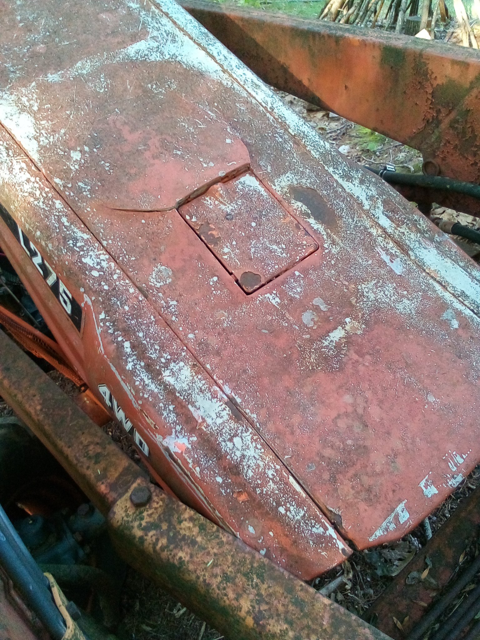

Please post pictures of the hood damage and the fuel filter. The hood is light weight steel and the filter on my tractor is like a oil filter and can’t be cleaned

I have attached four images. One image shows the damage to the hood. Apparently what I mistook for aluminum is actually some kind of coating over the steel hood (you can see where it cracked by the radiator hatch). The hood itself is actually fine save for a bend that is hard to see towards the front.

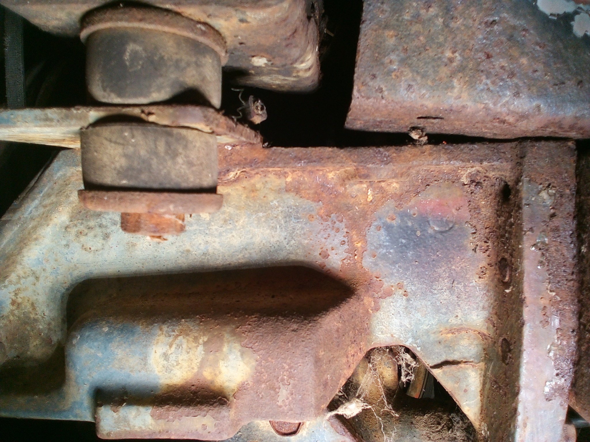

Another image shows the bigger issue, a widening gap where the hood hinge support attaches to the frame. This is one, but probably not the only factor causing the hood not to close completely. It's about 10" fore of where it should be.
The fuel filter image is attached. Yes, I know it's godawful. This is after the "cleaning," too! A replacement is on the way.

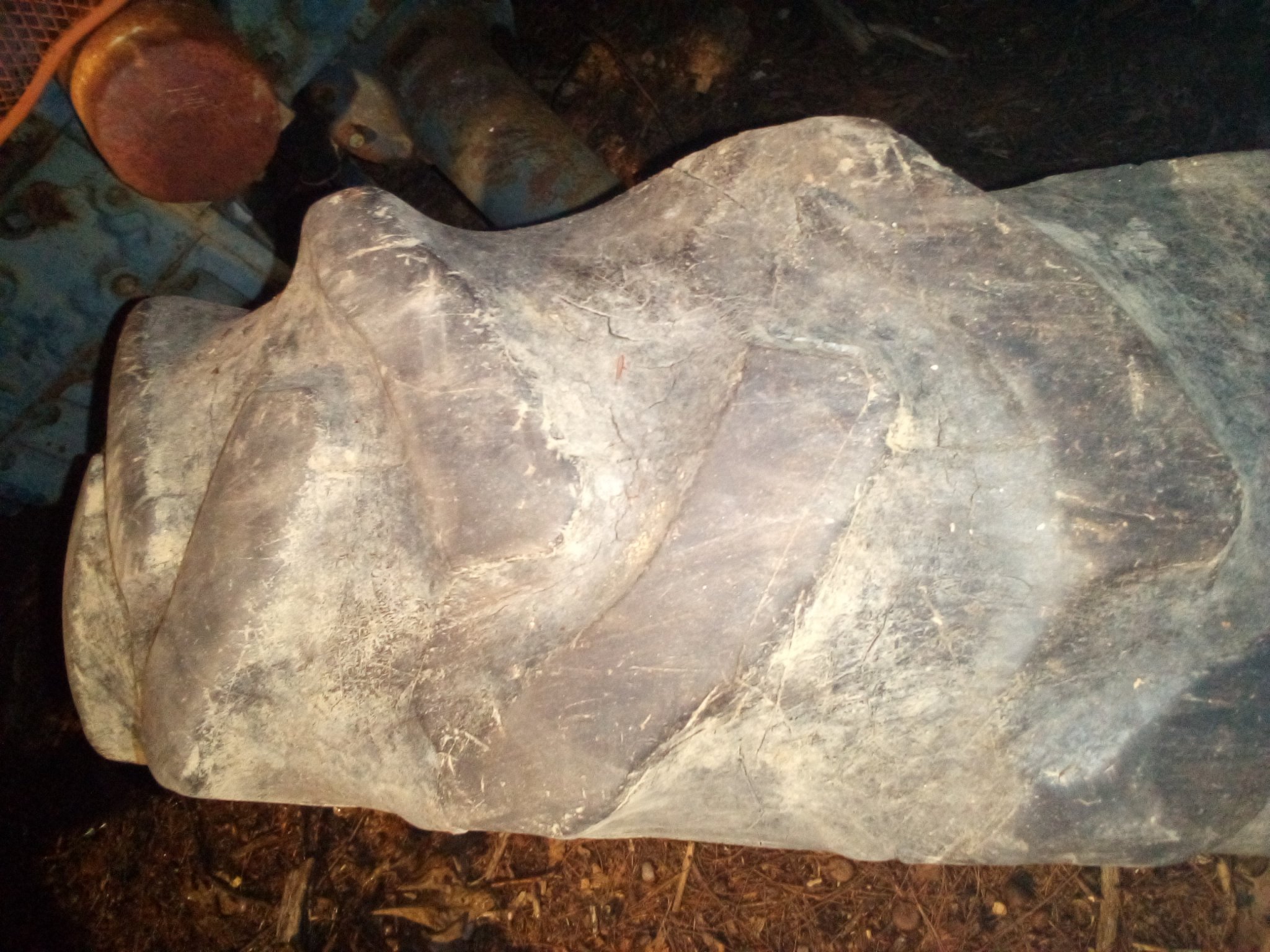

Also a picture indicating the front tire wear. The rears actually look OK, tread-wise.

The filter is a mess and good that is good you are replacing it it.
The tires are worn out and can be replaced with the same size or you may have to also replace the rear tires to keep the rolling circumference ratio the same.
The hood probably has body filler (bondo) that is cracking off. If the hood won’t close then just remove it for now.

Great. I'm awaiting a quote on the front tire replacements. Sounds like an expensive proposition, I might just wait until they're totally unusable.

The hood closes enough to close the front frame latch thing (?) so it's really not a functional issue, just annoying and bothers me.

With due respect to your father, I don't think that fuel filter has ever been changed either !
