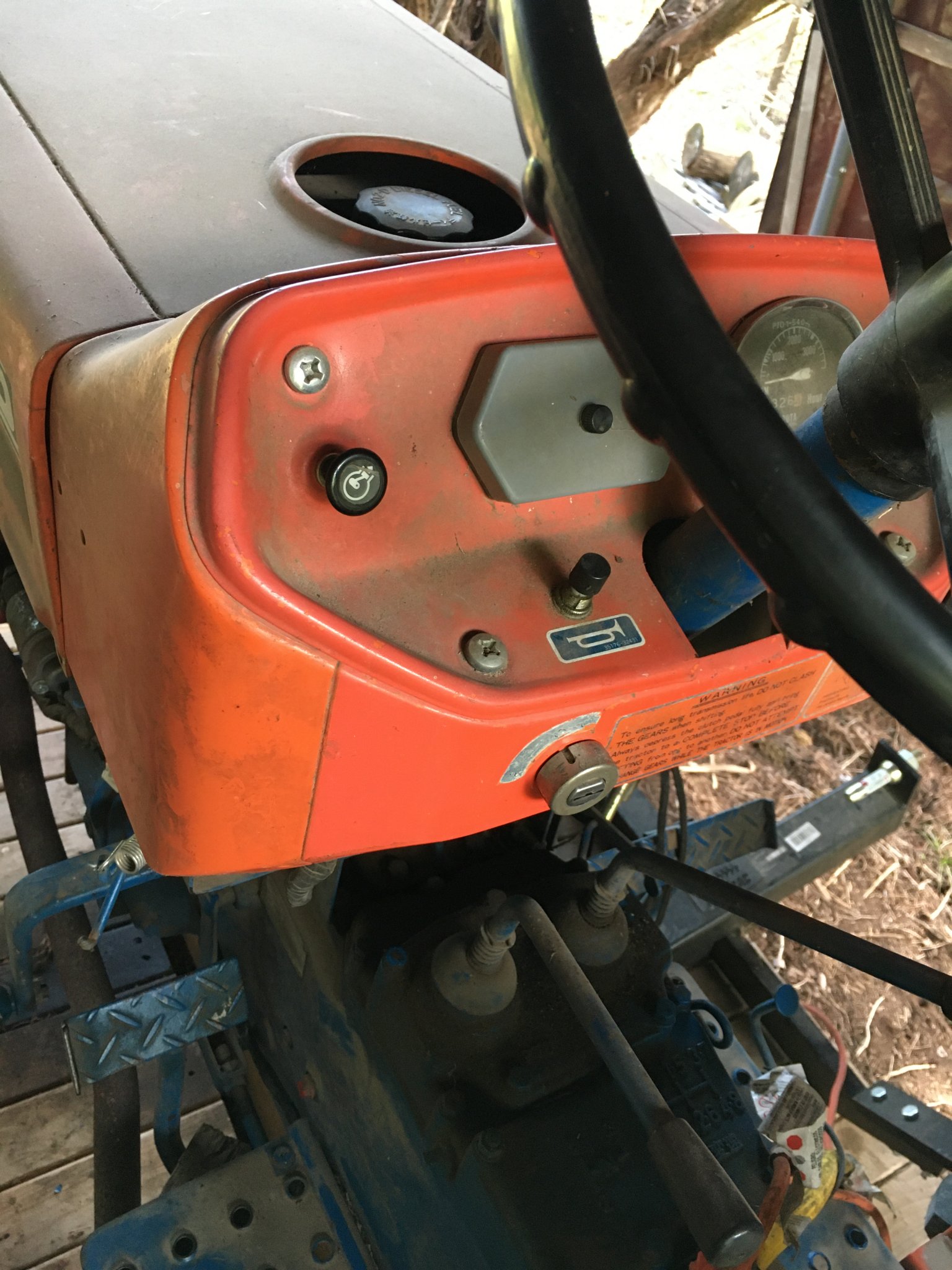

Here is the dash of the tractor so that you can see what it looks like

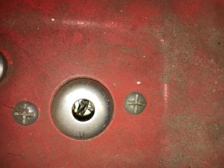

here is the glow plug indicator showing what it looks like inside

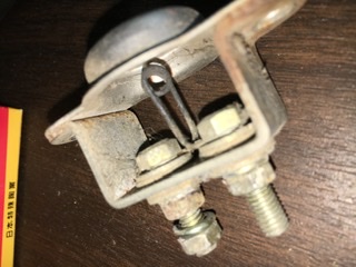

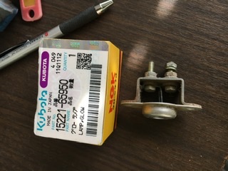

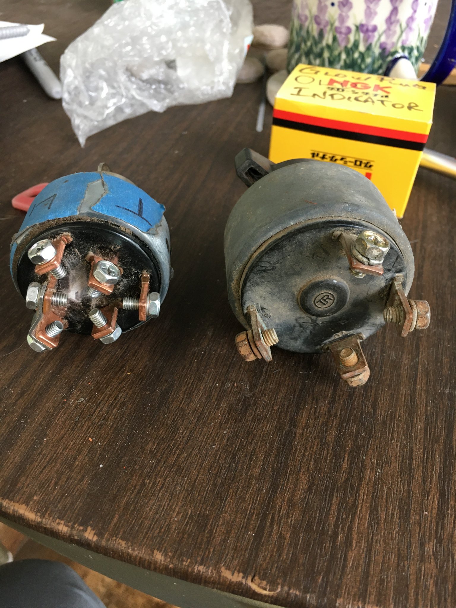

Here is the indicator part from my L185 that I replaced
Here is the back side showing the electrical connections and the coil (resistor )

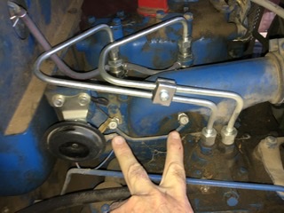

Glow plugs on the engine a little lower than the injectors

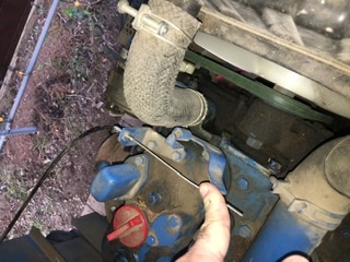

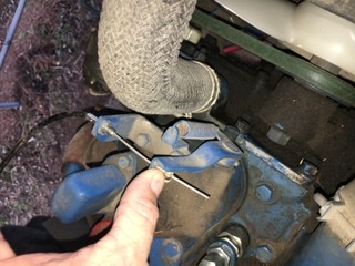

Decomposition pushed open
decompression pushed closed running position

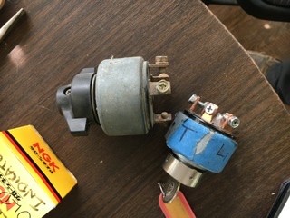

Here are the two switches
Electrical connections on the switches

I just got home from attempt #3 so it's not in front of me, but I asked my sister for pics of the dashboard and will share them if I get them. From memory, there were two red lights. Turning the key to the left for the glow plug turned on one light, and turning it to the right turned on both lights? In any case those lights don't currently illuminate and there's no click when the key's turned so I assume bad connection somewhere. I think it makes more sense to just order the right ignition. But, it would be cool to get it started tomorrow and at least get it home so I can work on it with my own tools, lighting, and no stress.
I do have wire, yes
There are two indicator lights on the gauge both red.. they are for oil pressure and charge system. Both come on with key and then go out when engine is running if everything is okay.
The glow plug indicator is supposed to glow when you have power applied to the glow plugs but it may be difficult to see or won’t glow until the power has been applied for a long time.

OK, I don't think there's anything in the glow plug indicator at this time. Can you see the indicator in the "rats nest of wires" pic in post #6 by any chance? (the black wire looks like it's plugged in to the indicator, but I just did that to keep the assembly hanging and ground it if it was a ground.)
What does the indicator look like? I can go back today and remove the dash to get a better idea of what I'm looking at. Or are you saying to connect to the lower screw in the vertical pattern?
So basically, I need to run an additional wire (or a jumper cable?) from the positive terminal of the battery to the glow plug indicator, leave it on for about 30 seconds, remove it, and try to turn it over?
What sights/smells/sounds should I expect when I have successfully powered the indicator? Purely out of curiosity, what would be the result if I accidentally left it connected?
About the cable, yes, I did play with that a bit. The cable is seized but I was able to manipulate the arm while cranking the engine. Moving it inward made the sound change for the worse, like maybe a higher frequency of compressions until they petered out completely. The engine does seem to spin relatively quickly (ever since I got the powerful new battery in it) without that cable engaged, so I didn't think that cable should be pulled. But I also don't know what it does, or anything.

The decompression cable pulls the lever open for starting the engine. It does not have to be used if not needed. It opens up the valve slightly and holds it open so there is no compression on any cylinder. The engine will spin up to a high speed since there is no load on the starter. You then push the cable out and close the lever on the front of the engine. The engine would then start.
If you have a good battery and the engine is spinning well just push the lever to the right side (spring will be shortest length) with your thumb so that the eengine has compression and will run.
The sounds of the engine do change quite a bit between the two positions.
If you have any type of spray penetrating oil like PB Blaster or even WD-40 please spray the bottom of the lever where it rotates and work it back and forth and then press it to the right (right side of the tractor if you’re sitting in the seat).

The glow plug indicator may be difficult to access from the rear to make the electrical connections but you may be able to unbolt it and then get it pulled out from behind the dash

That's probably what my dad meant, come to think of it. I have a multimeter, where do I attach the lead? Also I'm close but not totally sure where the glow plugs are in my original pic of the engine

Look at the pictures I posted glow plugs down under the intake manifold
