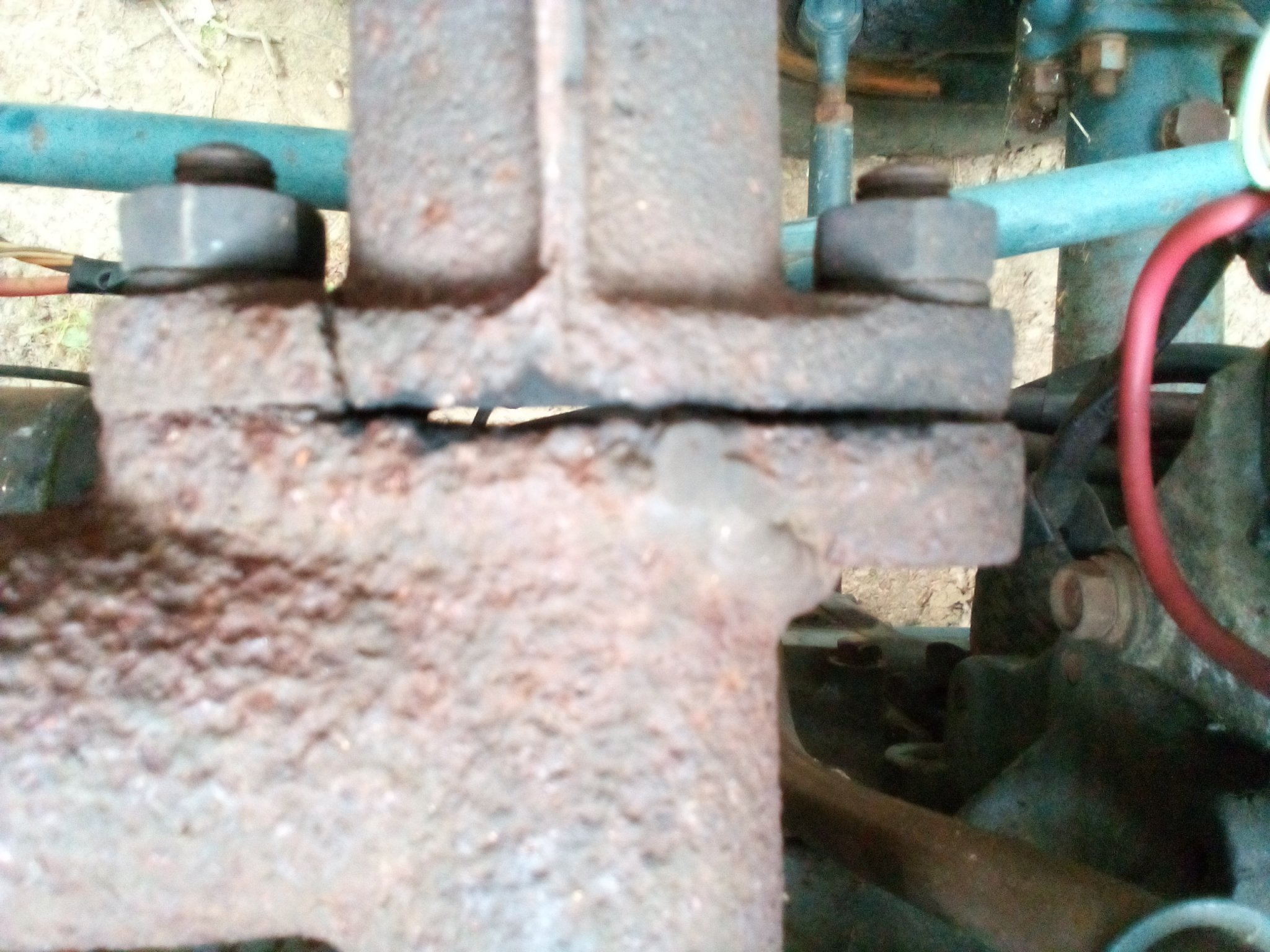

The gap between the exhaust manifold and the muffler flange has enlarged significantly, pic attached. How should I seal that? I don't think a new muffler flange gasket would seat appropriately due to the rust. I suspect this is not a big deal regardless

The exhaust will just continue to blow away from the exhaust gas blowing it away.
You could try to put one or two exhaust gaskets but I don’t think that will hold. The flange in the top looks broken near the left bolt. The exhaust pipe is probably steel and can be repaired by a welder or muffler shop. Th The manifold and gasket at the engine block will need to be replaced. I think that would be cheaper than trying to repair it since it is (probably) cast iron. Dealer items probably
