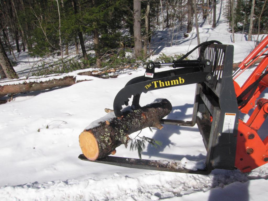

I could not justify the outlay for a dedicated grapple and 3rd function so I got a Green Machine Thumb and had it mounted on my forks.
For the amount and type of work I do [mostly logging], I felt the grapple fork setup was the right way to go. And so far it is working fine.
Since I don't run any hydraulic rear implements, I used my rear remote and long hoses to power the Thumb.
One caveat, it is relatively lightly though solidly built with mild steel, and can be bent if used for other than its intended purpose.
In other words only use it for grappling not pushing or pulling. Ask me how I know.
Also there are no grease fittings on any of the pivots so manually applying grease is necessary. If you are handy you could install zerks.
All in it cost me under $600 with some free welding by a friend.

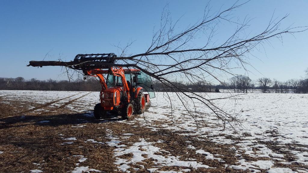

NHSleddog, to answer your question on smallest size of log it will grab, I can't say I've ever just grabbed a log to move it. I did pick up a 25' steel light/flag pole and moved it 300' and loaded it on a trailer. It did grab it and never moved lengthwise or rolled. I moved a 17' I beam, but I grabbed it by the flanges!
I usually grab a pile of brush to move. I've pulled limbs out of trees and cleared fences of wild roses pretty effectively. Loaded 7" dia steel pipe on a trailer...

Like i said, I grabbed a 7-8" at the base and tapered to about 4" at the top steel pipe 24' long laying the the brush. Picked it up and went down and around a barn, raised the pole up above a 4' fence on both sides of the driveway, and up a couple of times over 8' high to clear a couple of "trees" and loaded it on a man's trailer. The pipe did not move until I released the pressure.
I guess I never paid attention to what it would grab and not grab because it's grabbed and held on to whatever I pinched!
I also loaded a 10' piece of steel pipe 7" in diameter and put it my trailer simply because I had the grapple on the tractor, it was handy, and it saved my laboring the pipe on. Never slid when loading. Just never had a problem.
