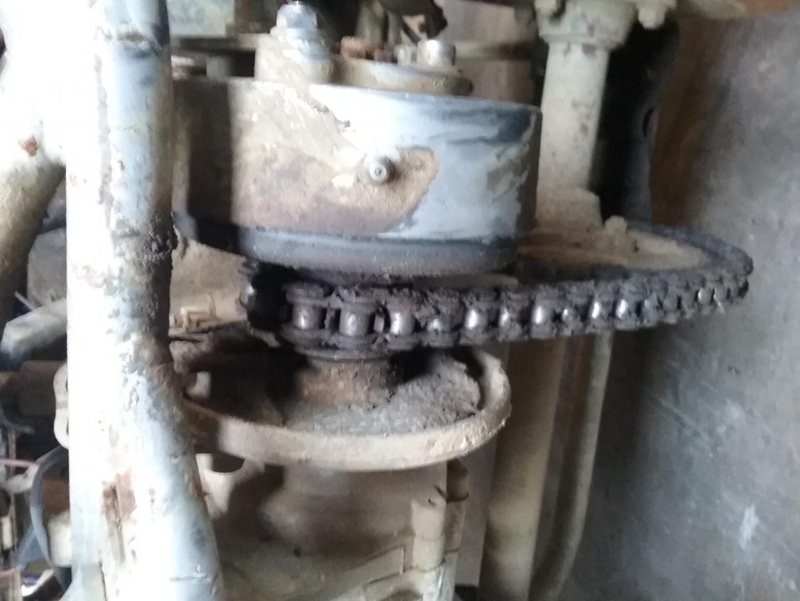

Kiddos are getting reverse :rolleyes: pulled the reverse and sprocket off. Guts are gone in the case. No big deal there. Was't too worried about reverse. But....... The sprocket that is attached is cooked. So, off to eBay to get the reverser coming. Since it's getting the new reverser, might as well order the handle and cable as well.
