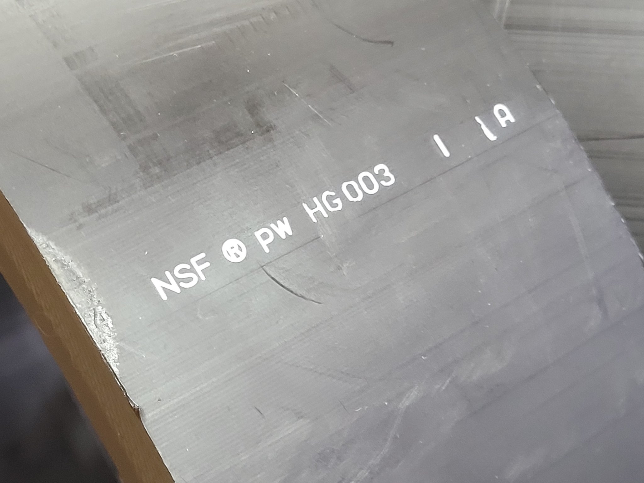

So I just received the kit and water or sewer pipe is exactly what it is. One of the sections has the NSF marking on it. It doesn't look like polyurethane; I'm sure it's just HDPE. Outer diameter is 12.5" and wall thickness is about 3/4".
I'm justifying the purchase by saying the price is small compared to that of the wheels and it saves me a bunch of time hunting down pipe cutoffs. But now I do need to find some 10 3/4" od pipe for the fronts. 2.5" would be long enough, to save some ability to turn.

Well, the kit doesn't even fit. The spacers are too wide or the bolts are too short.
I see that the pipe is polypropylene SDR 17.6, but you probably already know that.
