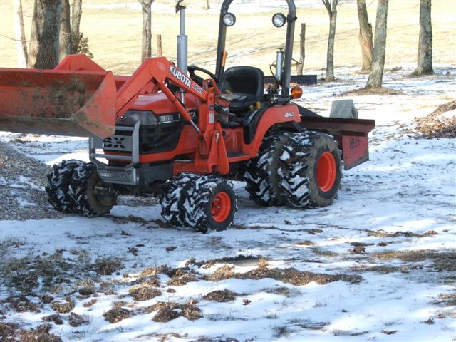

see if I can post this picture of a duel rear on a BX
20130629_160809 didn't work oh well that is the photo number.
it had duels on the front and rear!!

I have no need for duals on my BX23S as I know how to drive it within 'design limits'. Had a 30 year old ST12 with rare duals/forklift, zero rear axle issues so I'm curious about duals on BX tractors. While some disagree, no one has yet to show proof of damage.
If you think it is a good idea, go for it....
Actually.... Now you got me thinking how to do a homemade frame to mount duals. I'm thinking something like 4 heavy wall tube spacers bolted between wheels with the holes provided for wheel weight mounting. And all thread rod.
Than the details of what kind of bracing between the 4 stand offs. I'm sure it is doable. Just the details of how... Time to get out graph paper and pencils..

I have a Kubota BX25 and I have a set of duals on the back and on the front not for being tippy but for floatation I run mine through a lot of swampy ground with a 4 foot brush hog and anyone with a BX knows they are useless in any real mud because of ground clearence there is no clearence but with the front and back duals it floats on top and works great I have been 5+ years on duals without a single issue and have mowed hundreds of swamp acres no one else seems to want to touch. I made my spacers from well casing for rear they bolt on with the inner wheel which I changed from lug bolts to wheel studs a the spacers have a flange that the outside daul bolts to and on the front I used a set of old riding mower front rims and cut the outside bead seats off and drilled holes to matched the kubota weight holes in the rims and just used long carriage bolts it all works good. Only issue I have had and it is hard to say if it is from the duals or just a kubota issue because many have had the same issue it seems I have to do inner tie rods once a year I seem to get about 300-400 hrs out of them but not sure if that is dual issue or kubota issue since I have never ran my tractor without the duals.
