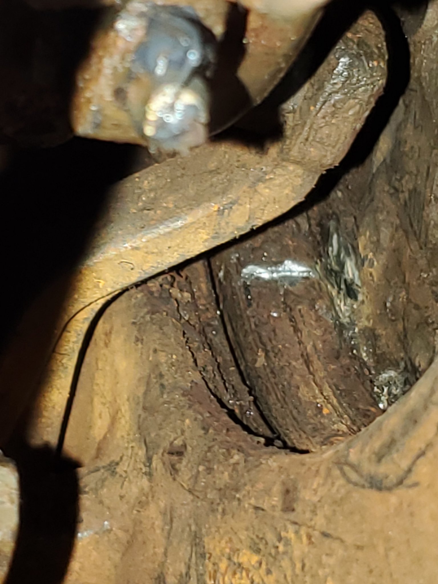

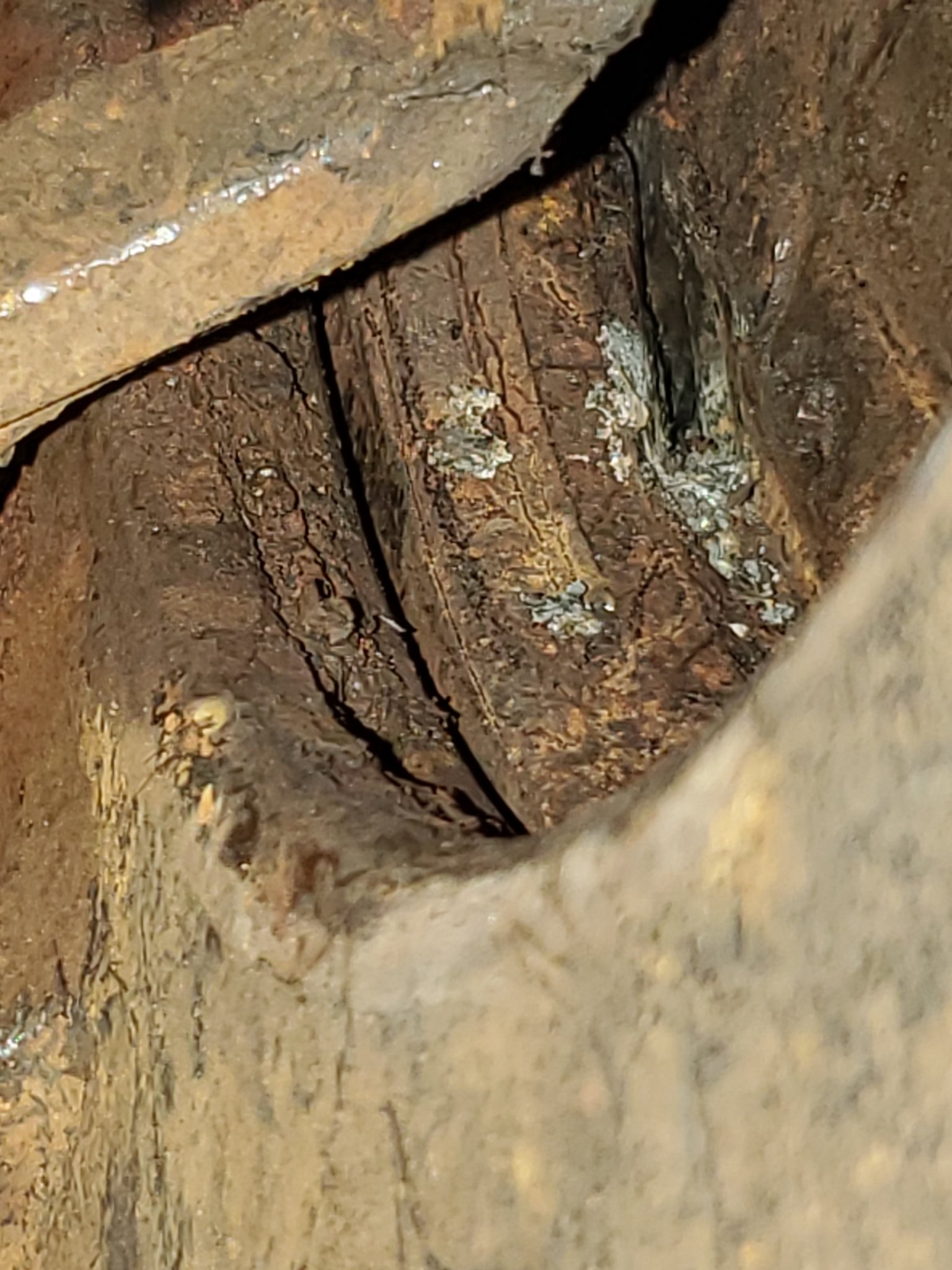

My choices are now limited. First, I adjusted all the play out of the clutch and took a piece of metal and jammed the clutch pedal all the way down. Then I welded a piece of pipe to a cold chisel and reached into the inspection hole to try to drive it between the PTO disk and pressure plate. Not working out. I soaked the disk with penetrating oil and closed it back up.
I will just shift the PTO before starting the engine this season and maybe get lucky and it will break free in use. Otherwise I will remove the loader and split the tractor next winter.

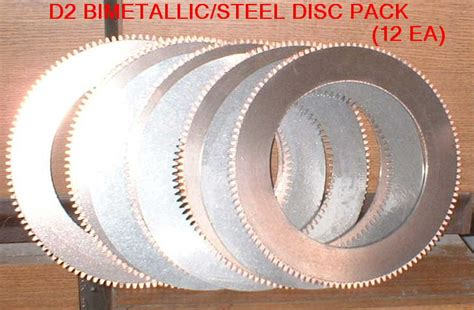

I had a D2 with stuck steering clutches. There are 12 plates with notches all around the OD, and they were stuck together. I bought a gallon of KROIL and poured it in the housing. It soaked and I eventually got them apart. Here's what they look like. Might try this soak, if possible.

Kinda what I did. I soaked the disk and plate with PB Blaster, we will see if it helps.

The problem is the two stage clutch. In order to allow the PTO clutch to work itself free, I will need to depress the pedal all the way down and the trans clutch will be disengaged. Tractor stops going forward and load drops off. I have tried backing up to a stump and dropping the bush hog on it. I will do that some more

Hooked the mower up and dropped it on a couple root wads and a stump with the clutch depressed. The PTO clutch still did not break free. I dont want to break the PTO shaft so I will just plan on splitting the tractor next winter...bummer
