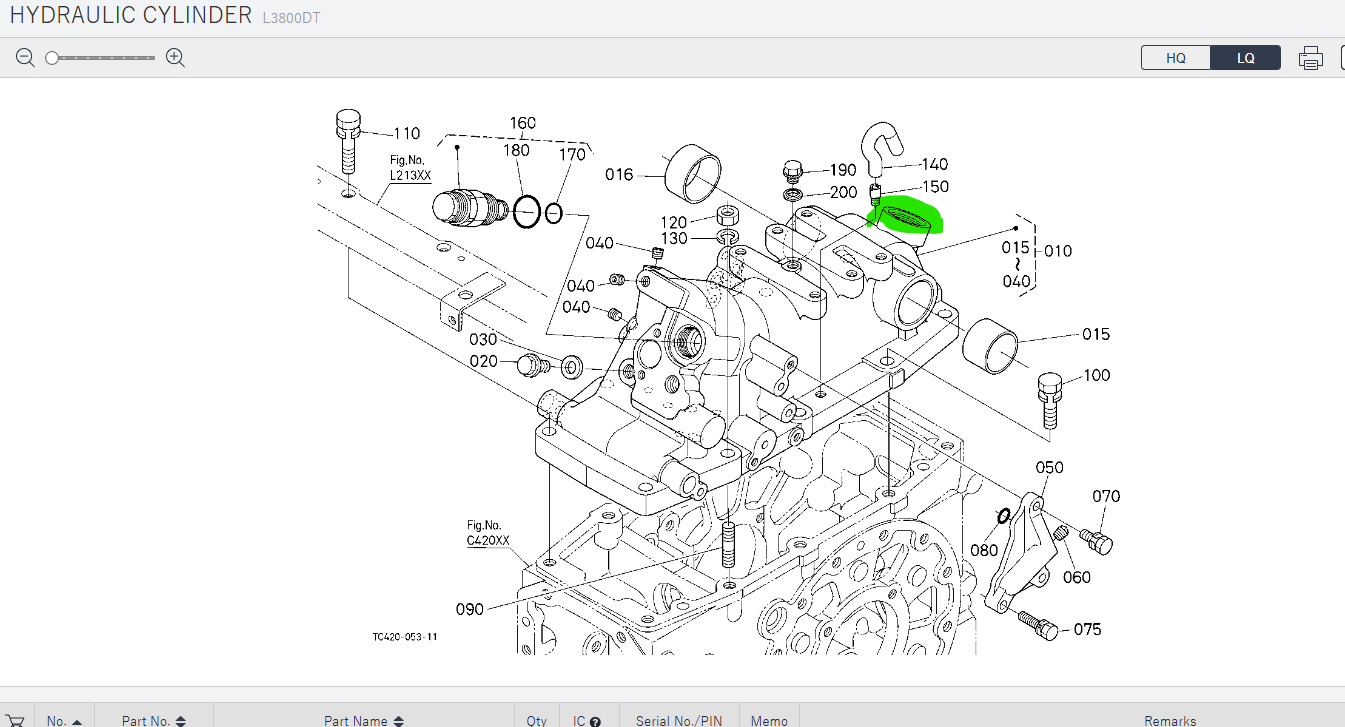

Is this where you stuck the stick? (green)
If so it's in the rear end and the best way to get to it is pull the hydraulic cylinder cover and remove the stick.

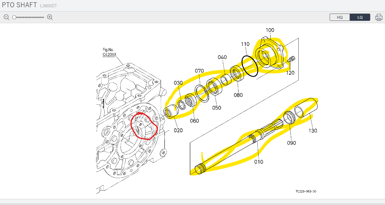

Second option would be to remove the PTO cover and the PTO shaft (yellow) that will give you a pretty good hole (red) to fish it out.
Wow, thank you for the detailed response! The green highlighted hole is the one I dropped it in. I like the idea of removing the pto cover and shaft. I do have a backhoe on the tractor and am wondering if firing it up to get the backhoe out is the way would macérate it or not. Would simply firing up the engine be ok or would that grind it up?

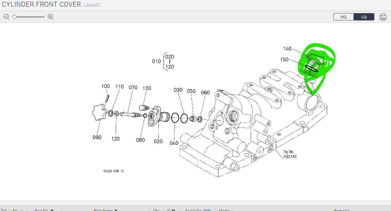

One more question, if i remove the top cover instead which seems like it would give the most access would the lifting arms need to be removed or would that all come up as a complete unit? Not sure what other disassembly is involved with removing the top cover but upon reviewing the diagrams and thinking that the stick would float im guessing the top would be the better option.

Yes you can remove the whole assembly as one piece.
I don't feel that it's too involved to remove that part and yes it would give you 100% access to that area.
