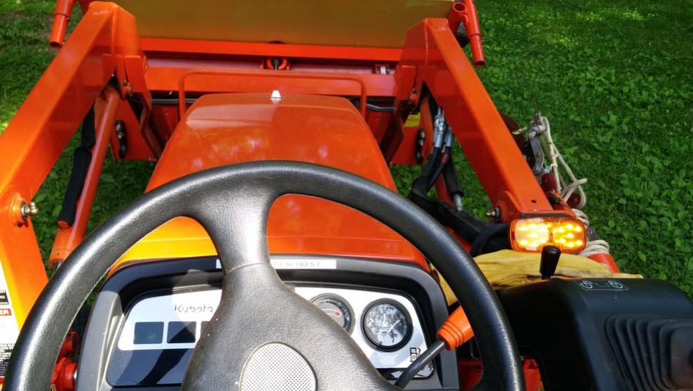

When I first got my BX2230, I found myself starting off the the brake locked down..
So I installed a magnetic reed switch, with the magnet on the brake lever underneath the tractor, that closes a relay that turns on the yellow hazard flashers anytime the brake pedal is depressed..
With the flashers behind me on the tractor there were still occasions I would not notice them, so I installed a bright yellow LED clearance lamp to the right of the instrument panel that I can't miss...
When the dealer picked up the tractor for the first 50hr maintenance oil change, he liked the idea.. Said they have had a few customers who drove the tractor with the brake on to the point the brake had worn and would no longer hold the tractor..
It's an expensive fix as the brakes on mine is a wet disc pack inside the transmission...
