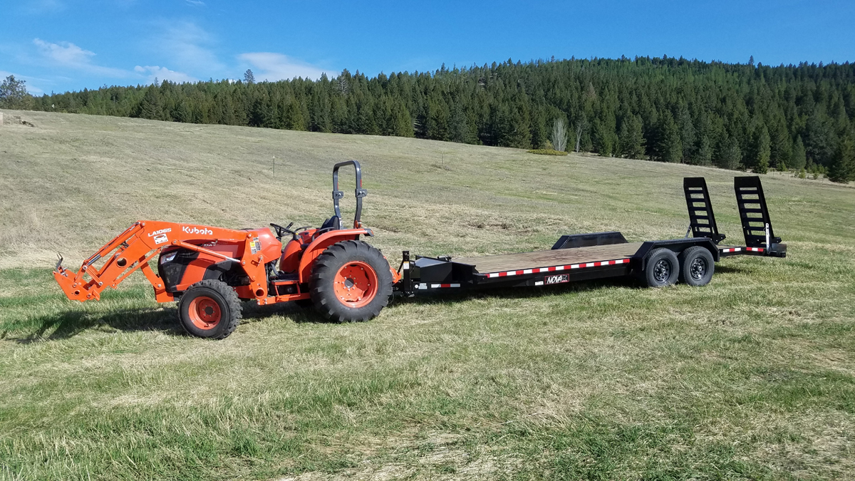

Well, I went the easy route this morning and bought a 2-5/16" ball with a 1-1/4" diameter shank so that I can use the MX today to move the flatbed trailer around once I've unloaded the EA box blade. I also bought a 5/8" drop pin that I'll use to attach chains. The nut isn't tight on the ball in the photo below in case anyone notices.

I managed to hook up the trailer to the MX and move it to where I wanted but had to remove then reinstall the quick hitch which is a pain. The hitch wouldn't clear the jack when making a tight turn to the left. In fact, the left side lift arm would barely clear the jack making a turn.
The ball on the draw bar was easy to see when backing up to the trailer, but removing the quick hitch every time I need to move the PJ or MidSota is a deal breaker. I'm back to where I started of making up a receiver for the quick hitch. I'll figure out a way to lock the 3-point so that it can't lift up.
