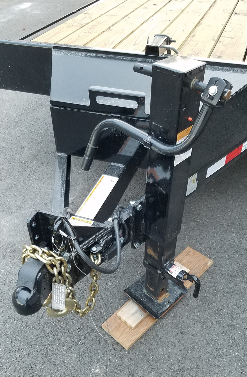

I tried that but the jack is very tall and stout on the MidSota trailer which is rated at 15,000 lb GVWR.

The PJ jack which is rated about the same is located inside the frame so not a problem for clearance. The PJ frame is stronger so doesn't need the additional center support for the tongue so that frees up real estate for the jack.
Gotcha - - no way raising 3PH will work there...that jack is tall.
