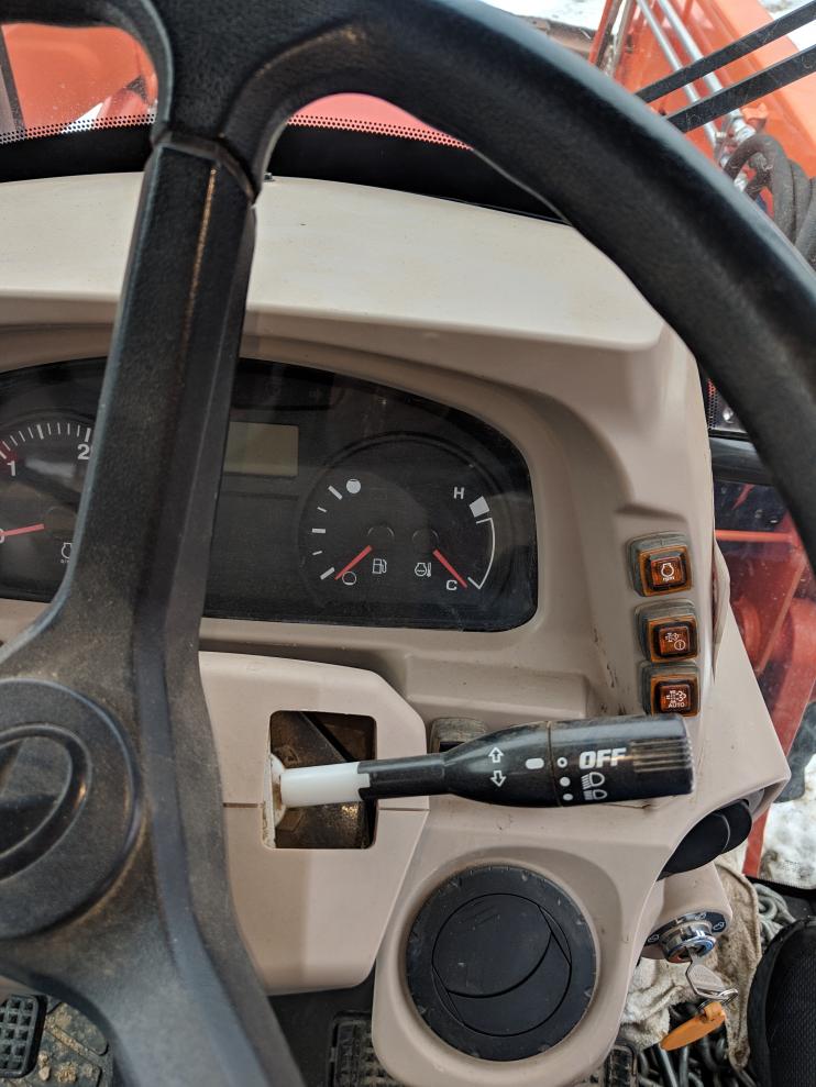

Thx, yes I do have a cab model M6060. What is also confusing is the order of the regen lights on the right side of the dash is not like the ones shown in the manual. I have rpm on top, then parked regen light, then auto regen light, but no inhibit light button as shown in the manual pegs 14-17, which makes me think the other manual may show a dash like mine.

Shoup you can figure out your buttons and symbols from the manual you have once you realize Kubota has Indicator Lights and Switches, which also light up. If you read the manual you have, that one clue will help decode the regen directions which are a little hard to follow at first. The switches are the square buttons on the right. The only thing different will be you will have no button with the slash through the regen puffer symbol.. The button in that location will be your Turn Auto Regen On button instead, looks the same but no slash.
At least that is my best guess without being there. Post a picture of your dash and we can try to make things clearer.

Well I have finally caught up to where you are, and was curious about top button which I don't have and so forth. FWIW top button in your picture is Constant rpm Management Control, useful for keeping speed constant when load fluctuates. See page 43 in pdf Wolfman posted above.
Middle button is the one you push if you need to begin a parked regen. Most of us never use it.
The bottom button that has auto written on it is the one you push any time you want to enable auto regeneration.
Really it is not a big deal, certainly not worth $1000! If every time you get on and start the tractor, you push that button you will have the same situation as the newer tractors. Don't push it when you don't want it to start a regen. Make sure you understand the regeneration process before you decide it was a stupid design.
