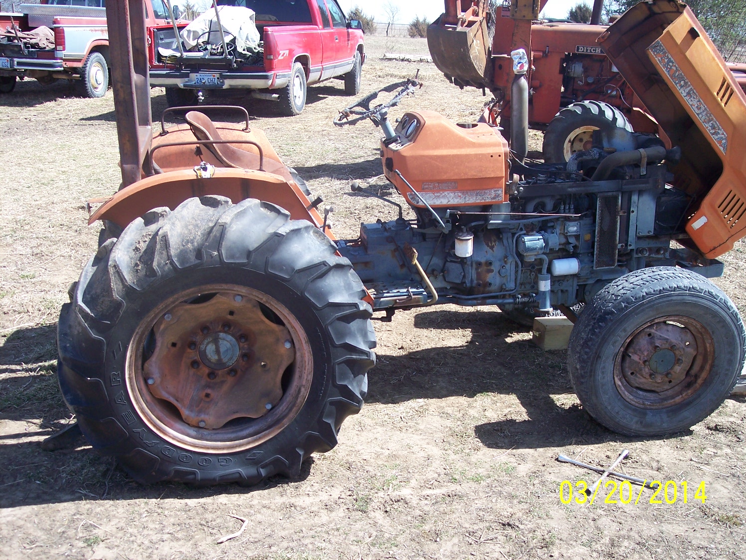

Here's a steering wheel that had been a bit warm. The material melted, but the wheel was still there!

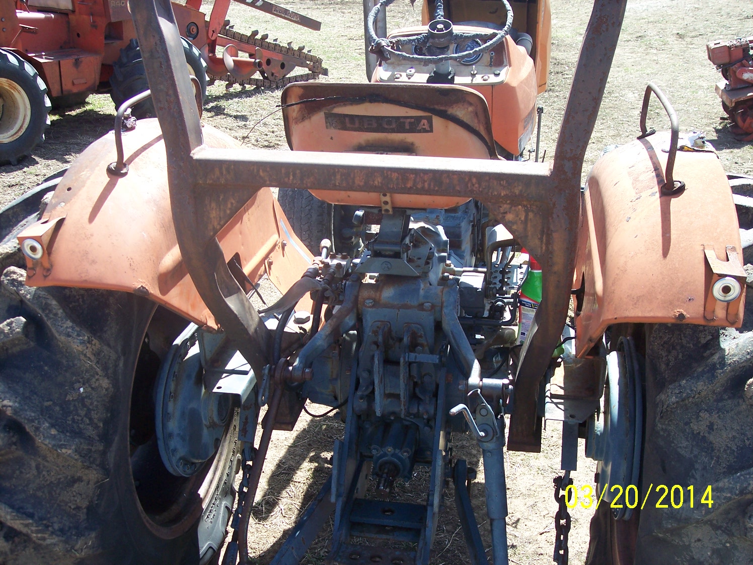

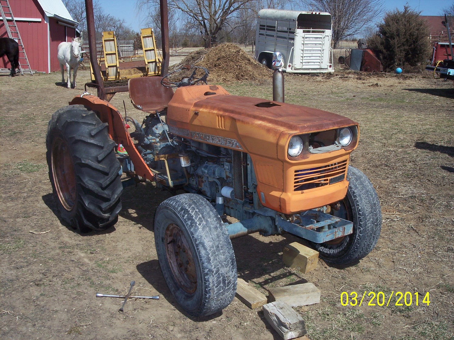

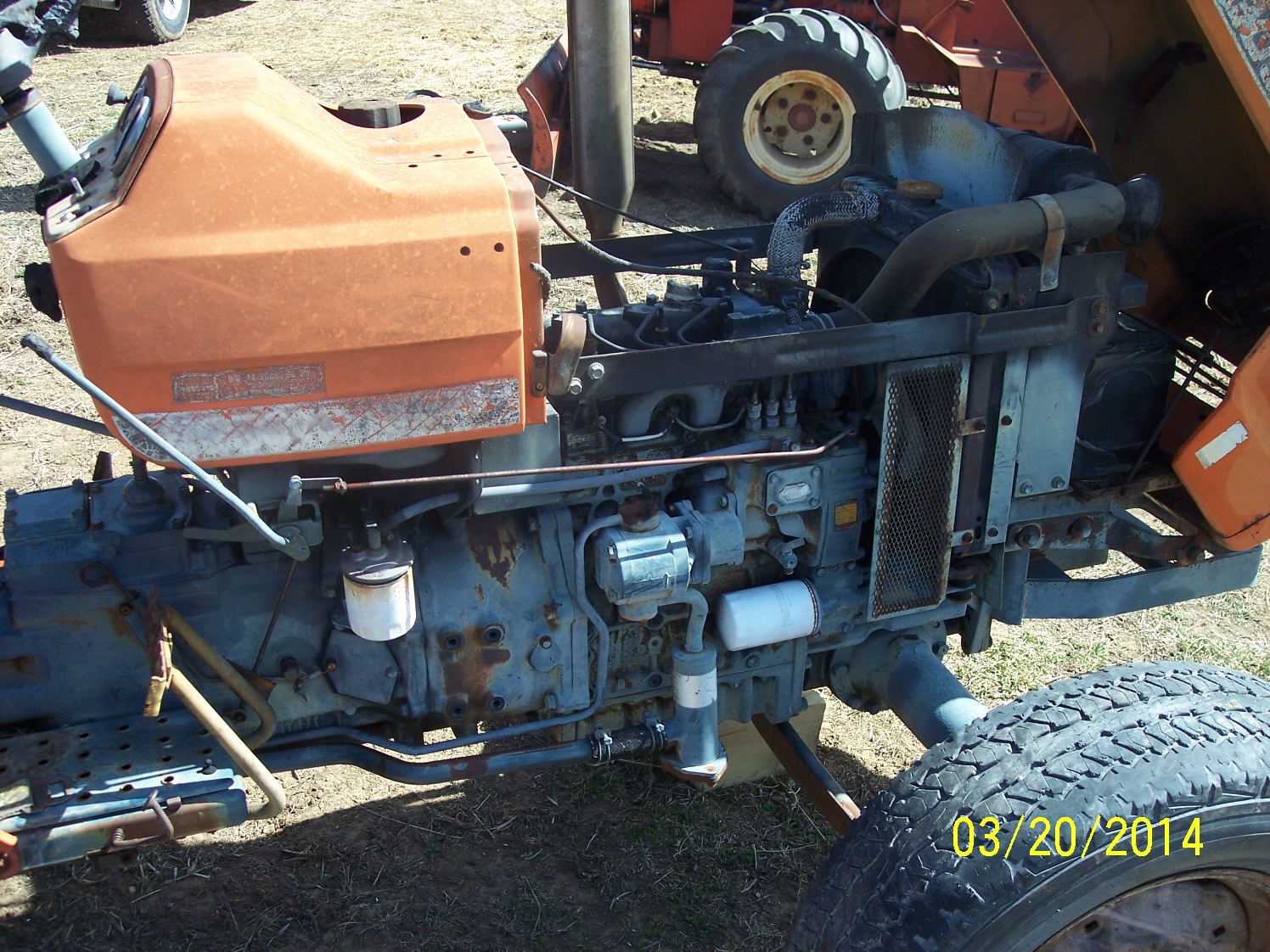

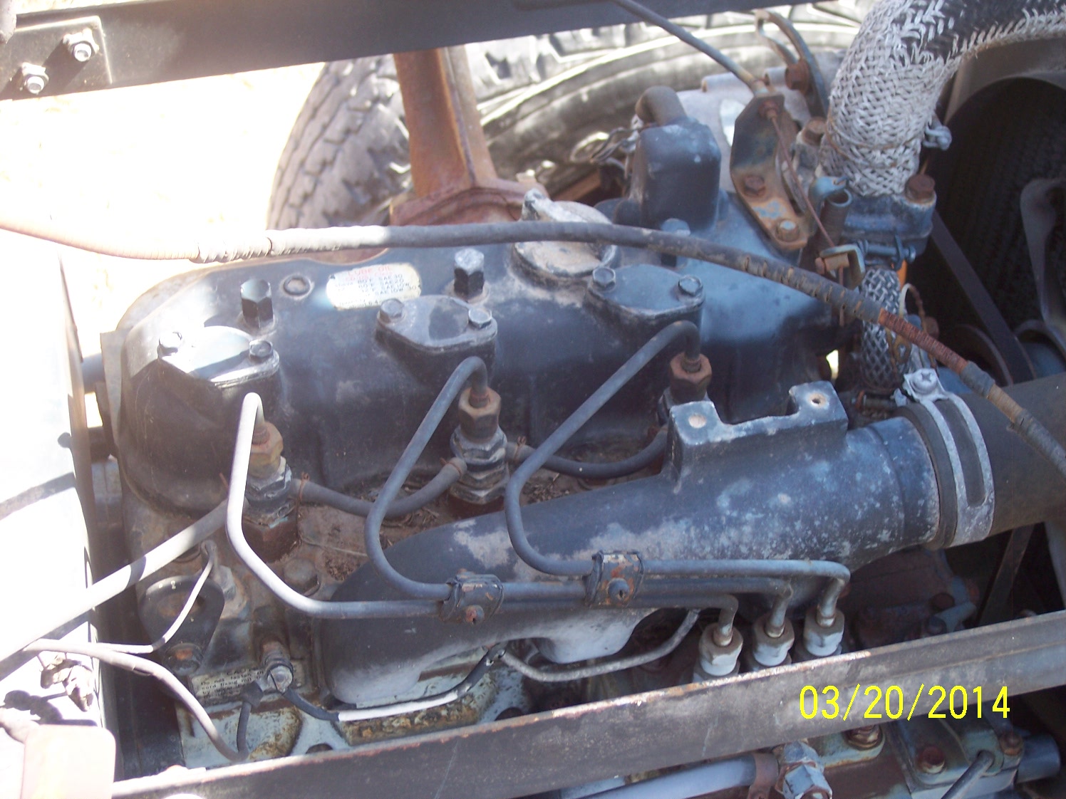

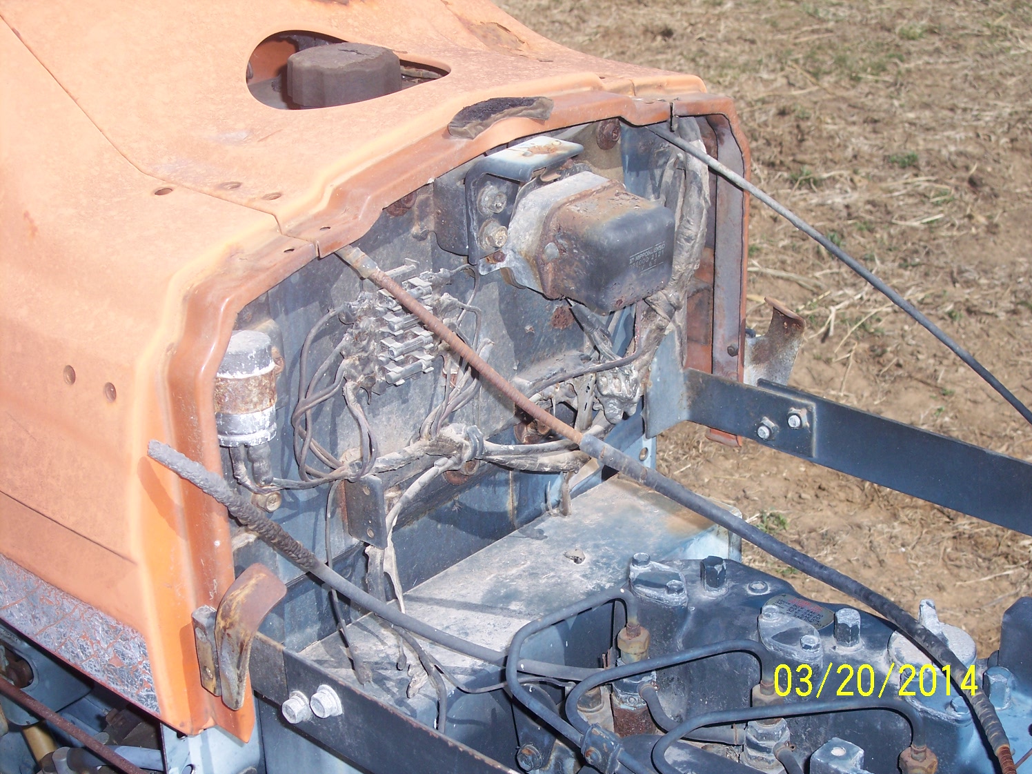

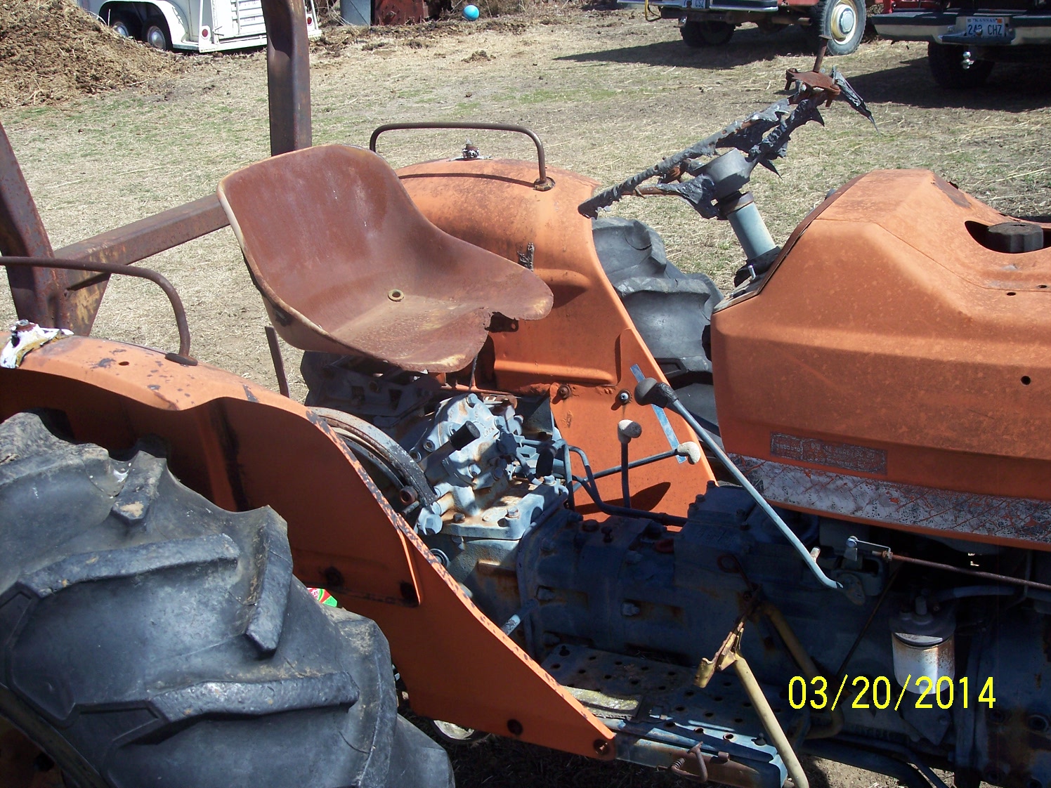

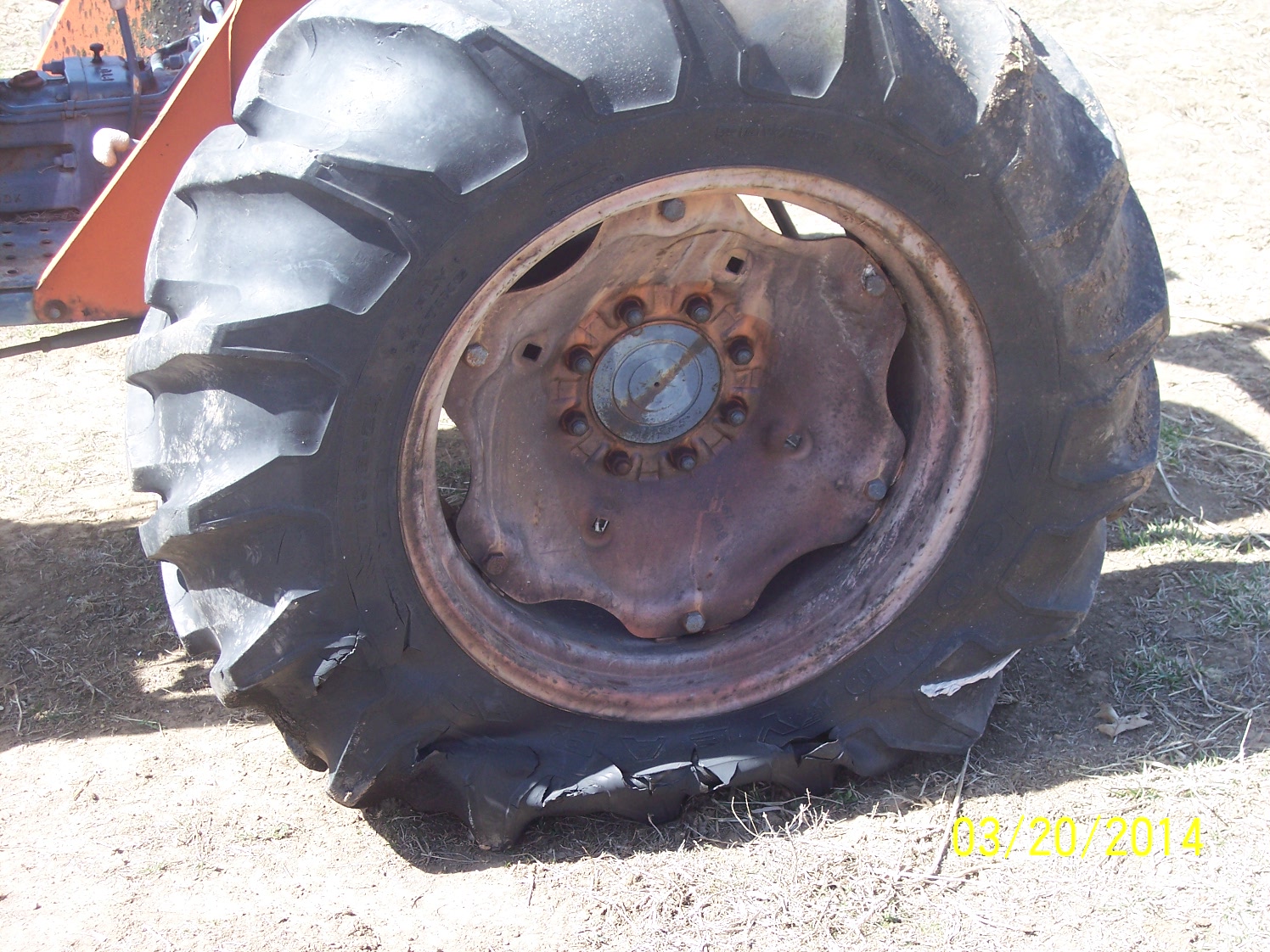

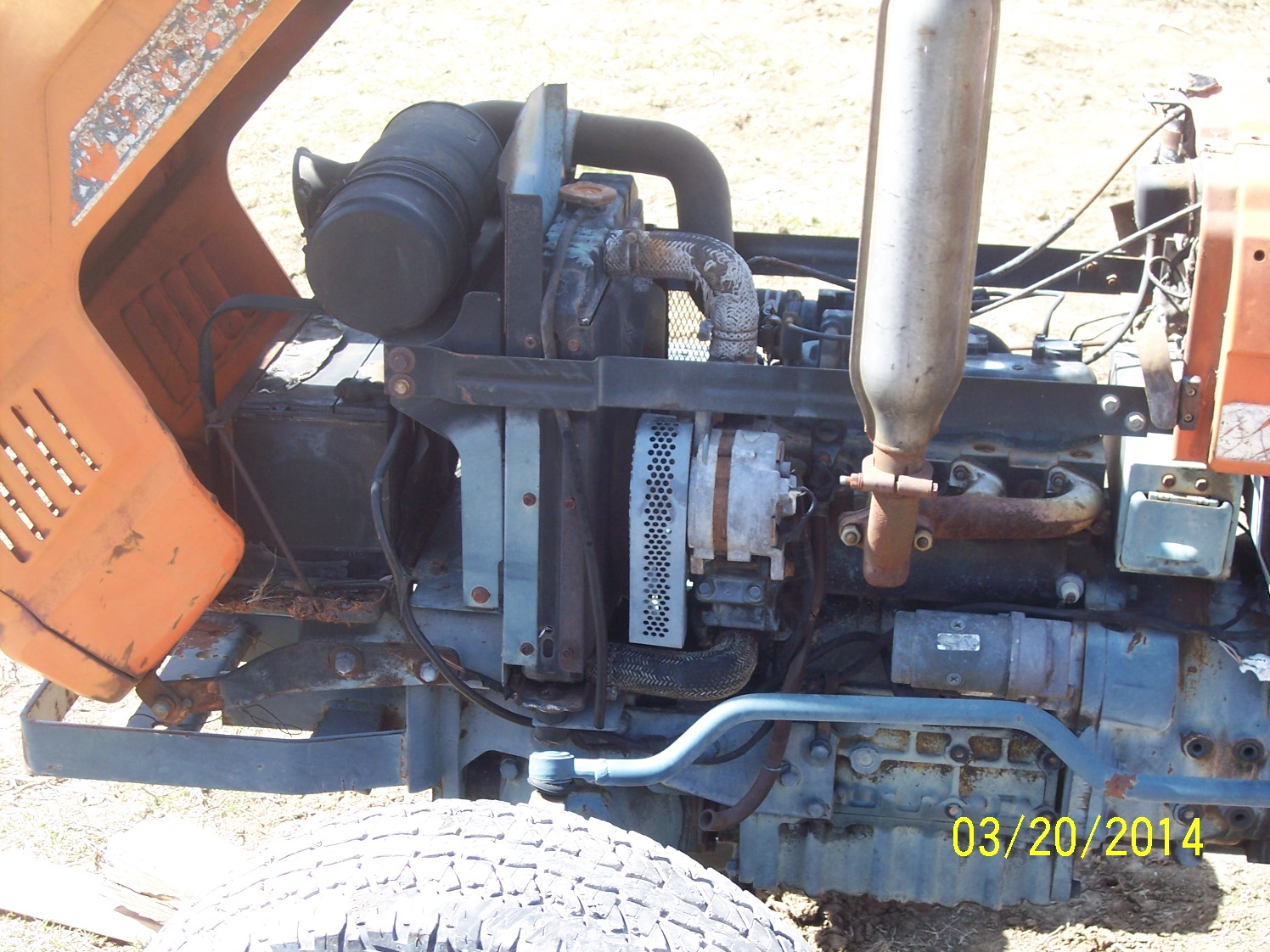

This L305 was in a barn that caught fire. The tractor was not on fire, just close to the fire. The hottest part was at the left rear of the tractor. Notice the lights which were on the fender was melted and ran into the rubber on the tire. The tractor had set outside for about 4-5 years before I bought it. It looks way worse then it really was. Biggest expense was I bought a new injection pump. Got that from Diesel Injector Service in Portland, Or. shipped to me for $426. The tires on the tractor were just old 16" off of a truck. The R-1's were rotted from weather and oil leaking onto them. Found new R-4's at Tire Town for $100 each.
View attachment 49473 View attachment 49474 View attachment 49475 View attachment 49476 View attachment 49477
Now it makes sense!!!!!!!!!!!!!
