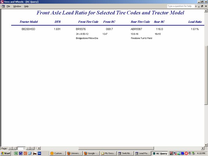

Well I contacted kubota and turns out Vic's method is pretty close at least for my tractor.
The front to rear gear ratio is 1.691. I attached the file they sent me.
Using the tire circumferences shown in the file, 69.7" and 116" gives (using the goodyear formula) a positive slippage of 1.61%. So my method of determining the gear ratio was either wrong or I needed to do more than 20 rotations.
