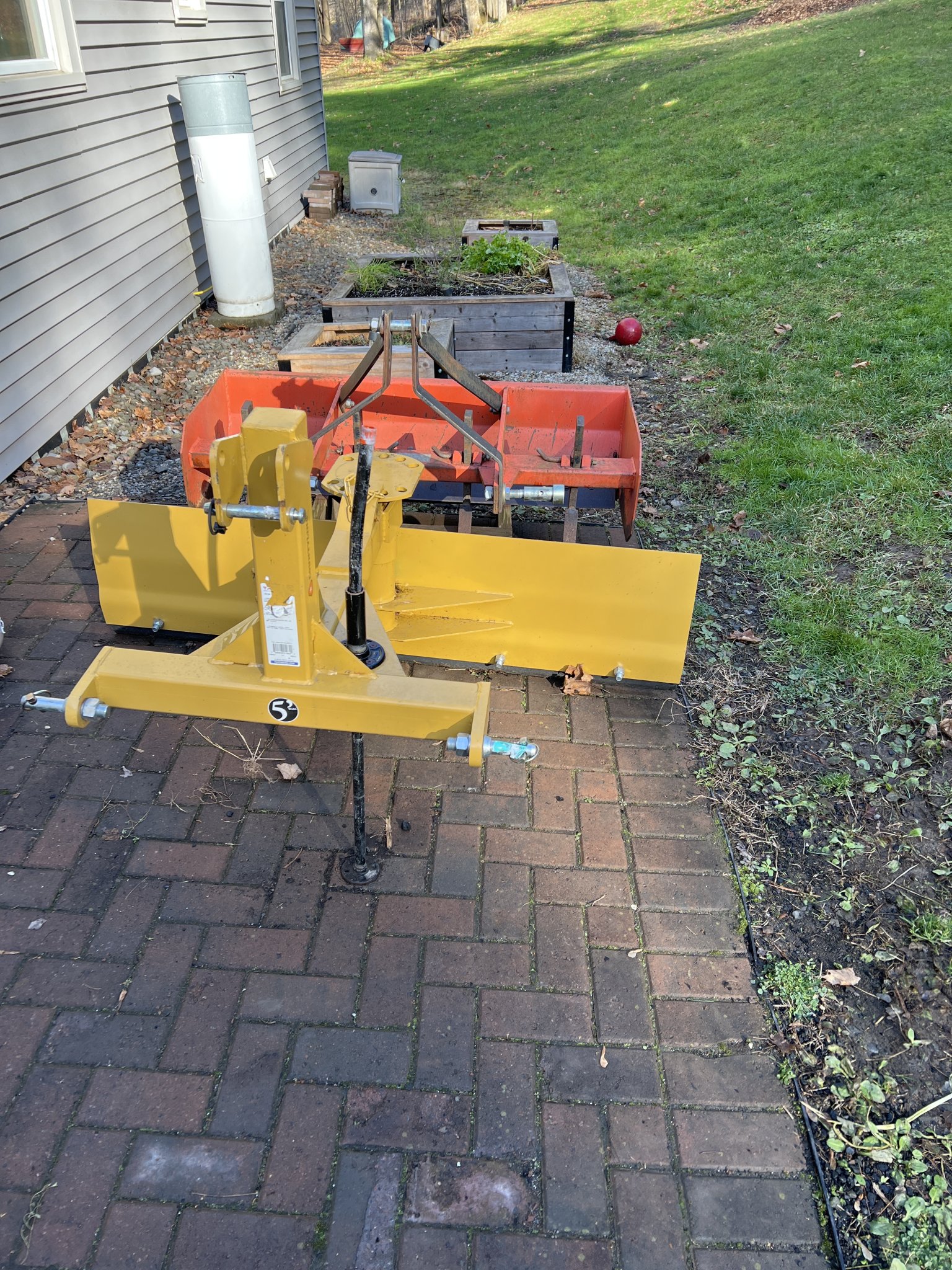

I've seen a few people say they reverse their rear blade for snow to keep from digging in to the driving surface. If you do or did, was there any issues?
I reversed mine just to look at it. I wondered if the bolts/nuts were damaged by this process. No, I haven't tried it yet. My road surfaces I will plow are primarily gravel.

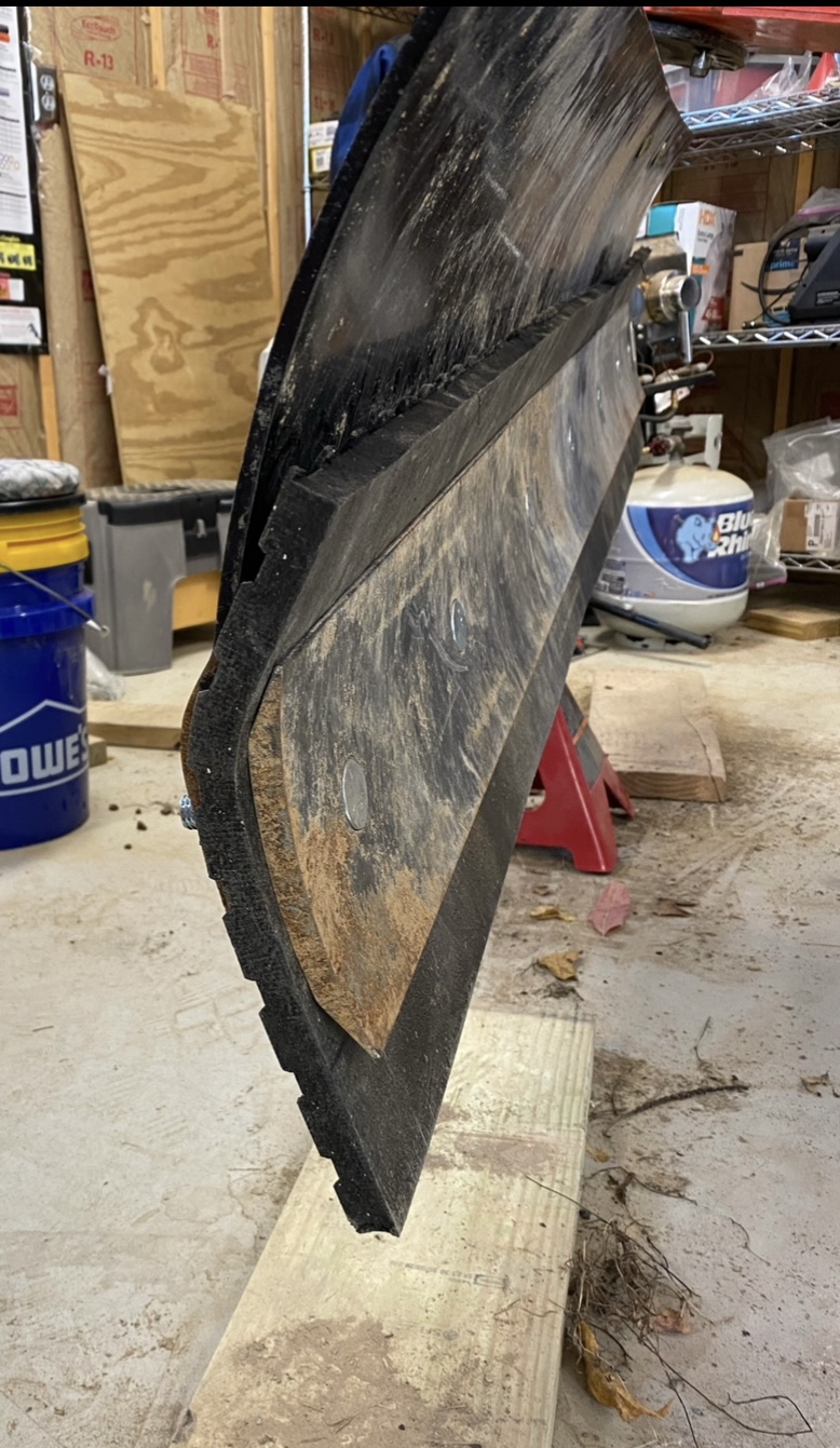

For my gravel driveway, I turn my blade around and also add a cut strip of horse stall mat that I make a sandwich with:

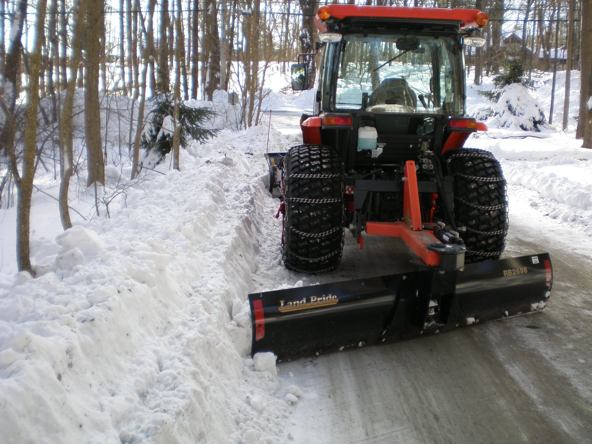

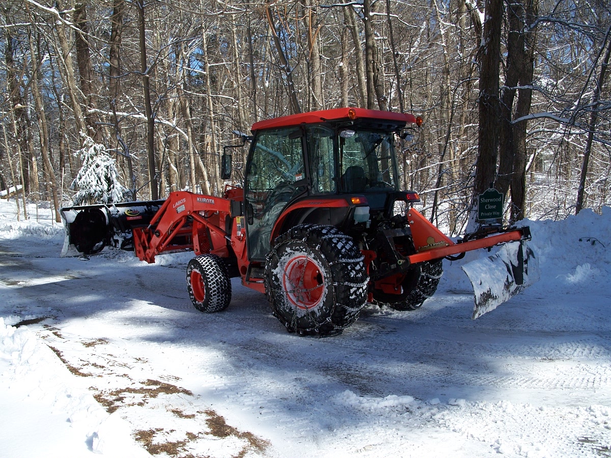

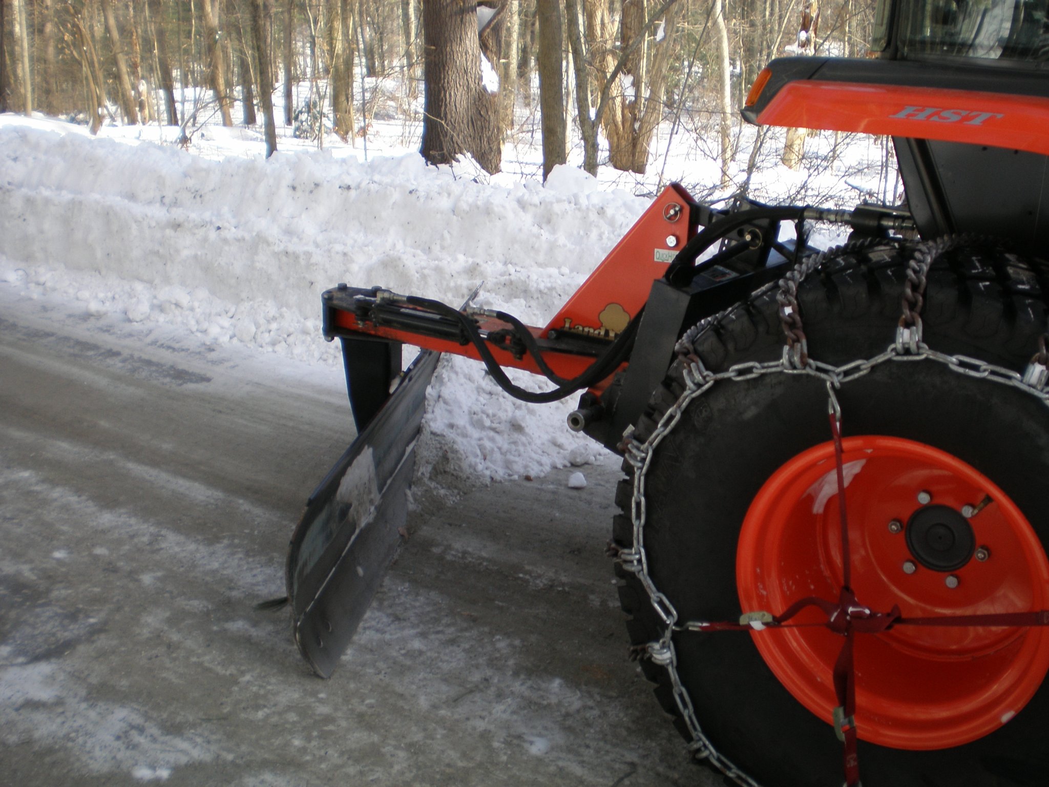

The first and last storms of the season are the worst for gravel driveways. Until it freezes solid it will be a mess to plow. I use a plow on the front and the back blade as a clean-up at the same time. I only use it backwards when I back up pus
hing snow away from the wood shed in my back yard so I don't dig up the lawn.
