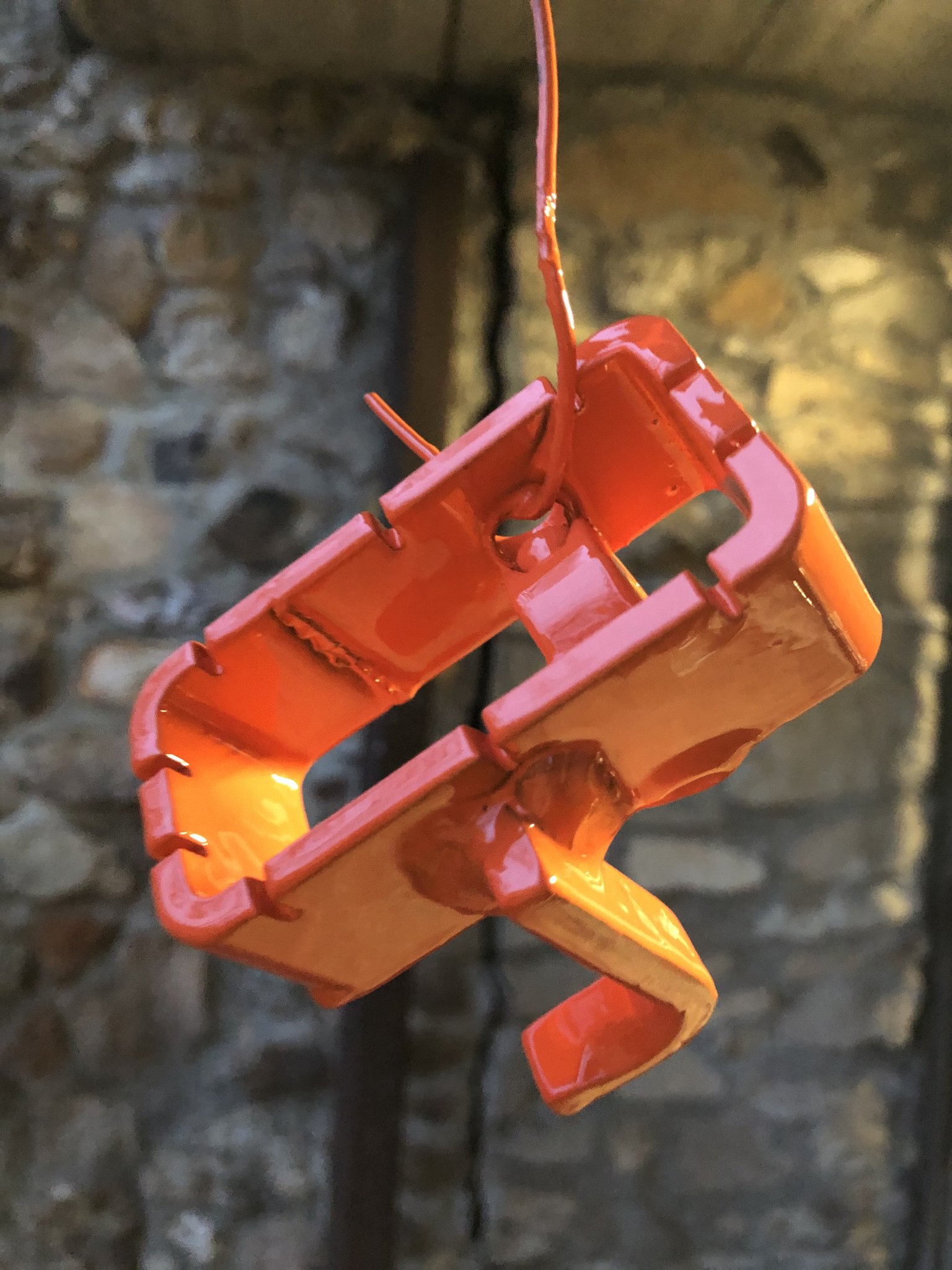

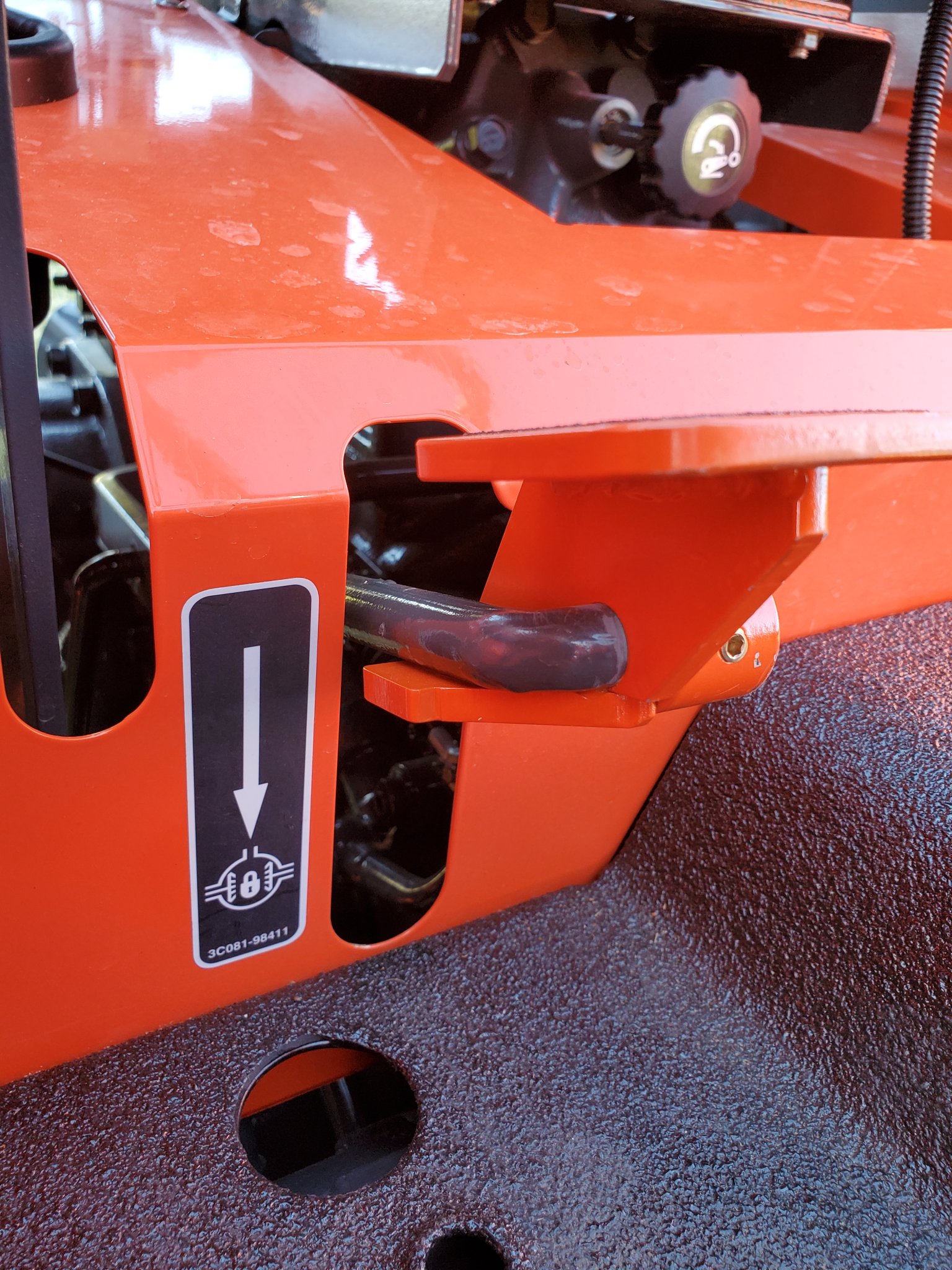

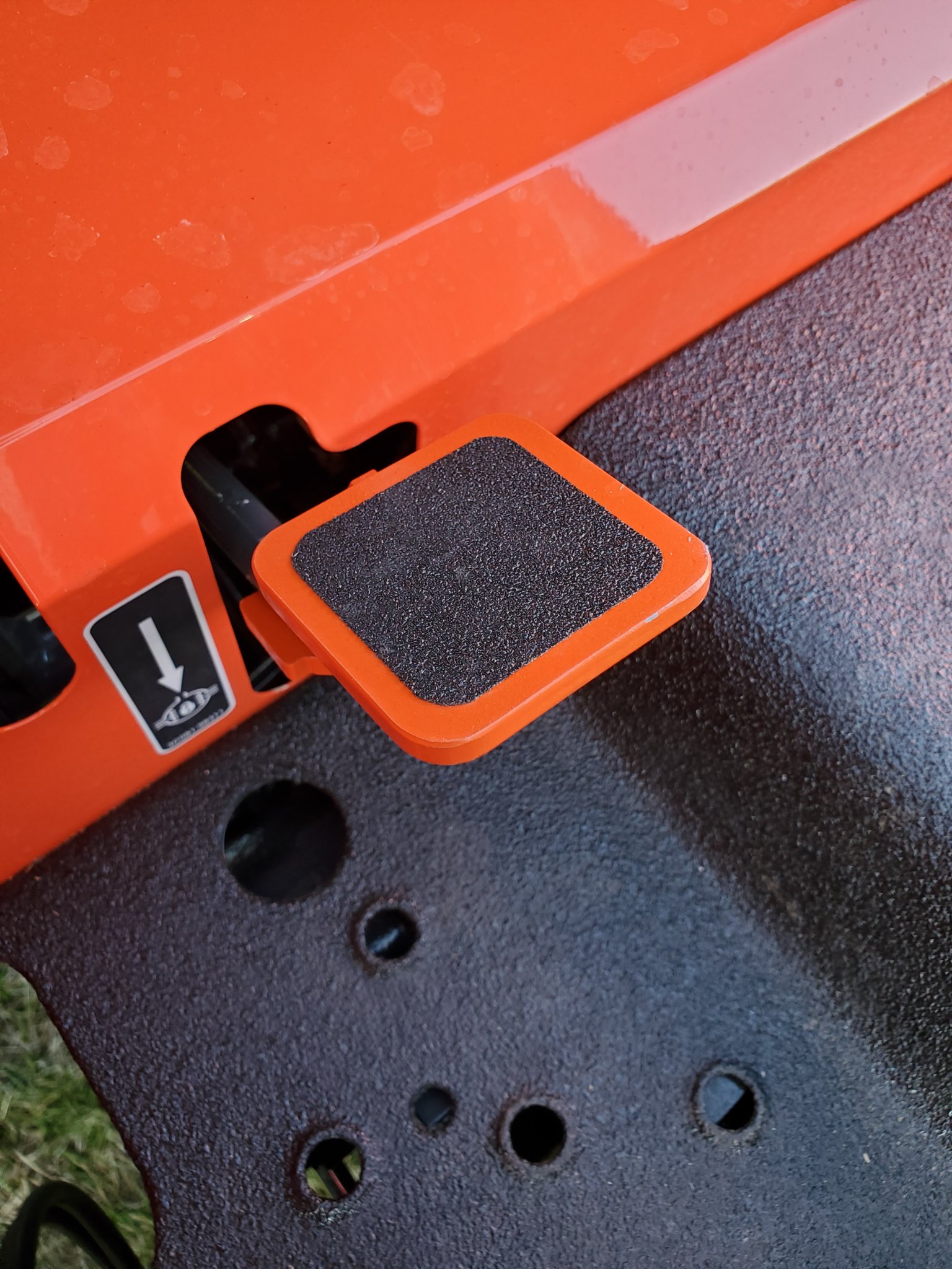

My pedal mod looks bigger in the picture than it actually is in person, and it only projects forward about 2". Trying to press down on that slick metal rod with my snow/ mud covered heel was nearly impossible. My leg cannot exert as much force in that direction as it can pushing on a brake or clutch pedal. For the record, I have NEVER accidentally stepped on the diff lock even when dancing on the platform. You can see by all the paint that is still on it.
Thanks for the positive comments on my build...it's just my Applied OCD kicking in. Attach30296_20231013_103422.png

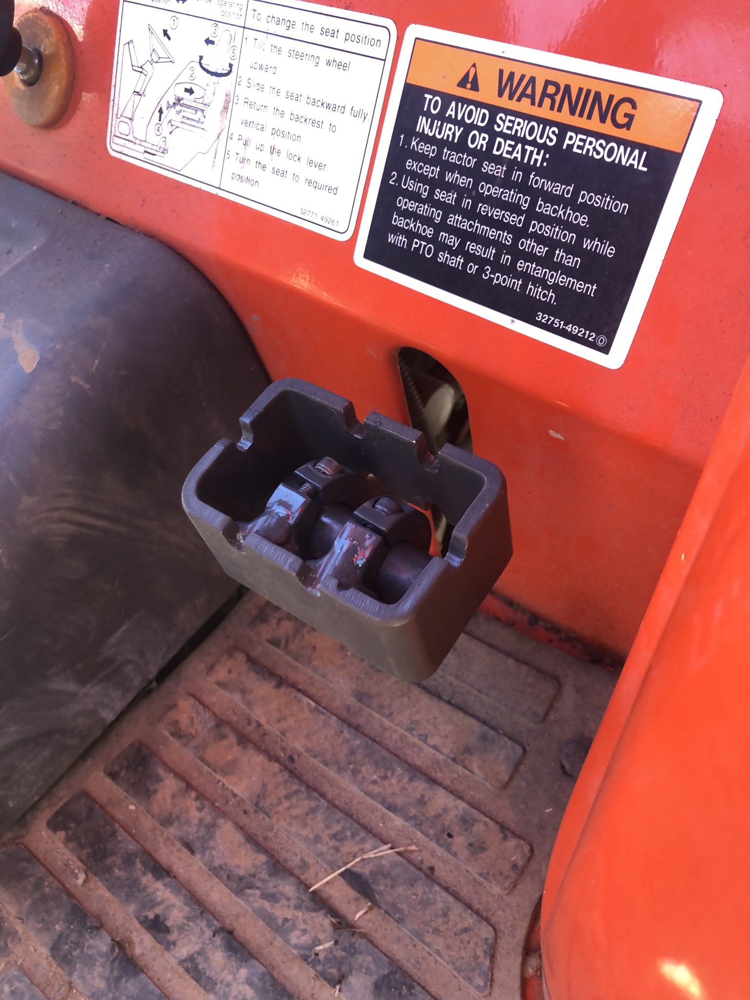

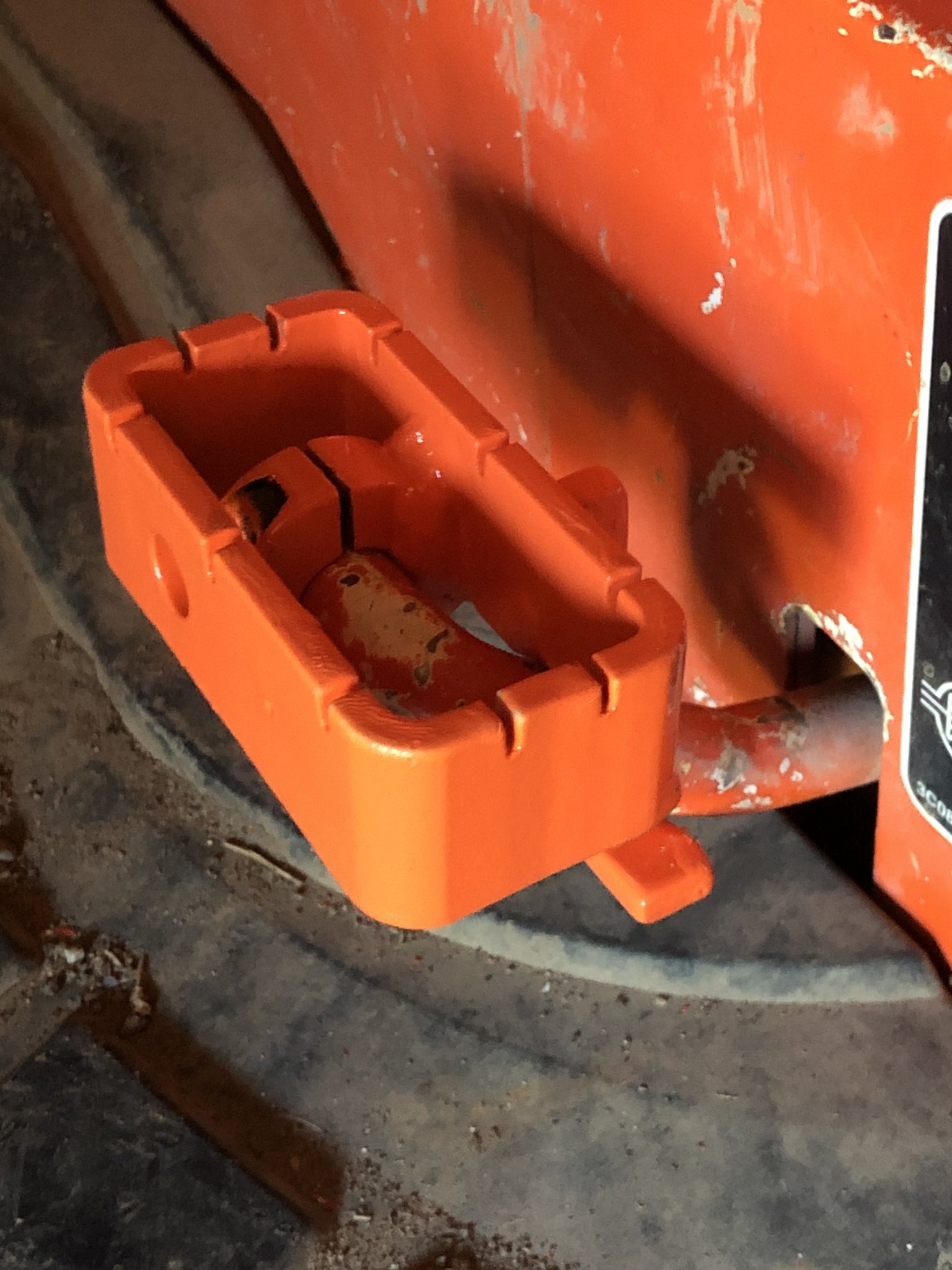

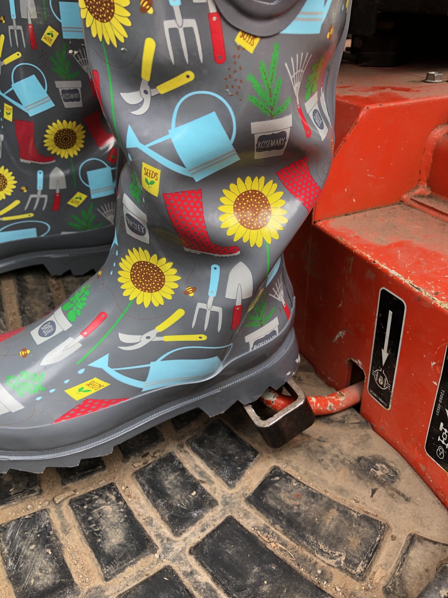

Hillside farm we use the diff locks often. Wanted to make sure my wife fully engaged in several spots of the “lawn”. Boots are often muddy when needing the diff lock. Simple rectangular tubing and split shaft collars. IMG_1813.jpeg IMG_1799.jpeg IMG_1791.jpeg IMG_1786.jpeg IMG_1780.jpeg

My point is that there are better ways to gain traction. Easier ways. Individual brakes.
Respectfully, Digging yourself out with the loader and or BH is as common as dirt. We've all had to do that.
But, If one is wearing the paint off of the floor pan because thier heel is on the diff lock pedal all the time, there are other issues:
Either the tractor is regularly driven places it shouldn't be.
Or the tractor is abused. Mud bogger, etc.
Or the tractor is too small with not enuf ground clearance for the owners regular use. Abuse.
Or the operator isn't experienced with individual brakes and alway bangs on the diff lock in any traction loss situation.
Or the rippers are too deep.
Or the operator just doesn"t know wtf they are doing and live on the diff lock pedal.
There are many reasons.
A bigger pedal on your emergency pedal, (diff lock), sure. Do it. Go ahead. But it's a last ditch tool. It's small for a reason.
Have to take the loader off to install the front mounted snowblower, don't want chains as tractor is parked on a epoxy painted floor in the garage. BH is off as I install a back blade that has a salter/sander mounted on it too. Live uphill on a 1/2 mile driveway that is gravel. Like a bigger pedal as the moon boots makes it hard to press the small pedal.

I get it. You guys are in the mud and slime and wear sexy boots like @Smokeydog. (Those boots are cool, no offense. Just having fun with it) So you make the peddle bigger. But they make them small because it's not regularly used, and it's HARD on the tractor and transmission. But everyone's situation is different.
In my use, over time, the diff lock is a last ditch effort. Like ejecting from a plane (tractor) that's going to crash (get stuck). I used my diff lock twice last winter when I got my LX too close to my driveways edge and slid into the ditch during a blizzard. 1st time it worked as I pushed out with the loader too. 2nd time I had to winch out with my trucks winch.
Anyway, if it floats your boat, or tractor, make a bigger pedal for it. There are some awesome DIY peddle add ons in this thread. But in my opinion, in most cases, the diff lock is used at times when using the individual brakes (if equipped) is the better method. And less strain on the tractor.

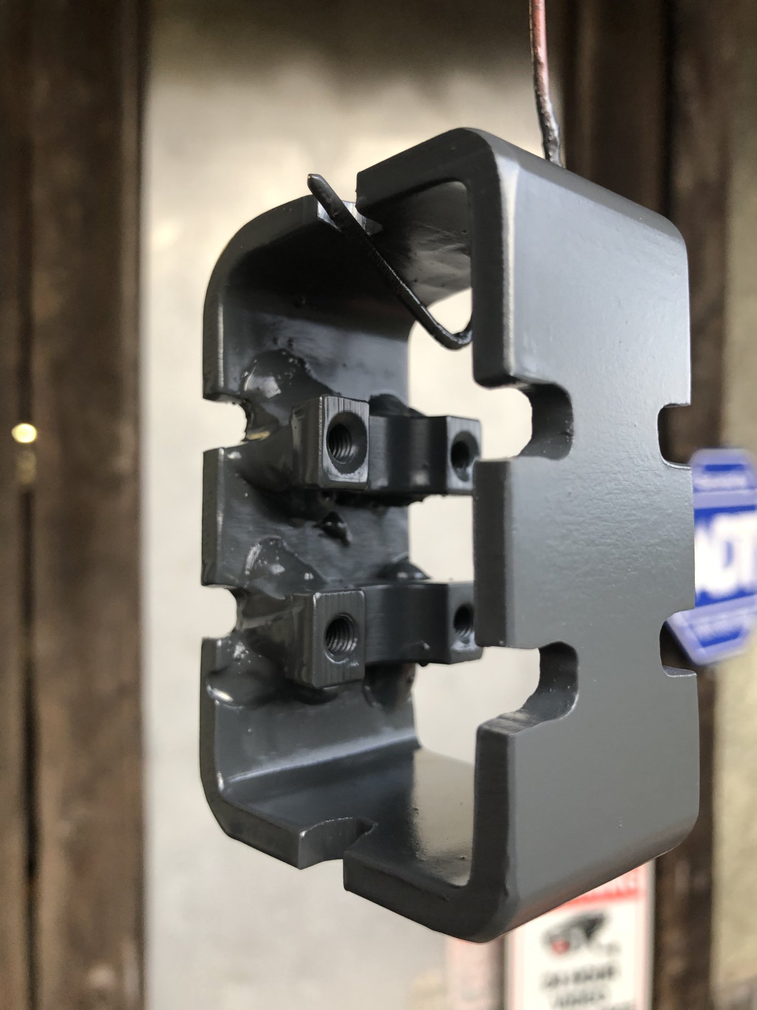

I have way more time than money, so I made my own. View attachment 113782 View attachment 113783 View attachment 113784
Hillside farm we use the diff locks often. Wanted to make sure my wife fully engaged in several spots of the “lawn”. Boots are often muddy when needing the diff lock. Simple rectangular tubing and split shaft collars. View attachment 113826 View attachment 113827 View attachment 113828 View attachment 113829 View attachment 113830
Those are F'ing sweet gentlemen!
Flawless executions, and outstanding workmanship example!!!!
I love'em both, Hell, I don't even need one, but now I wanna make one.
