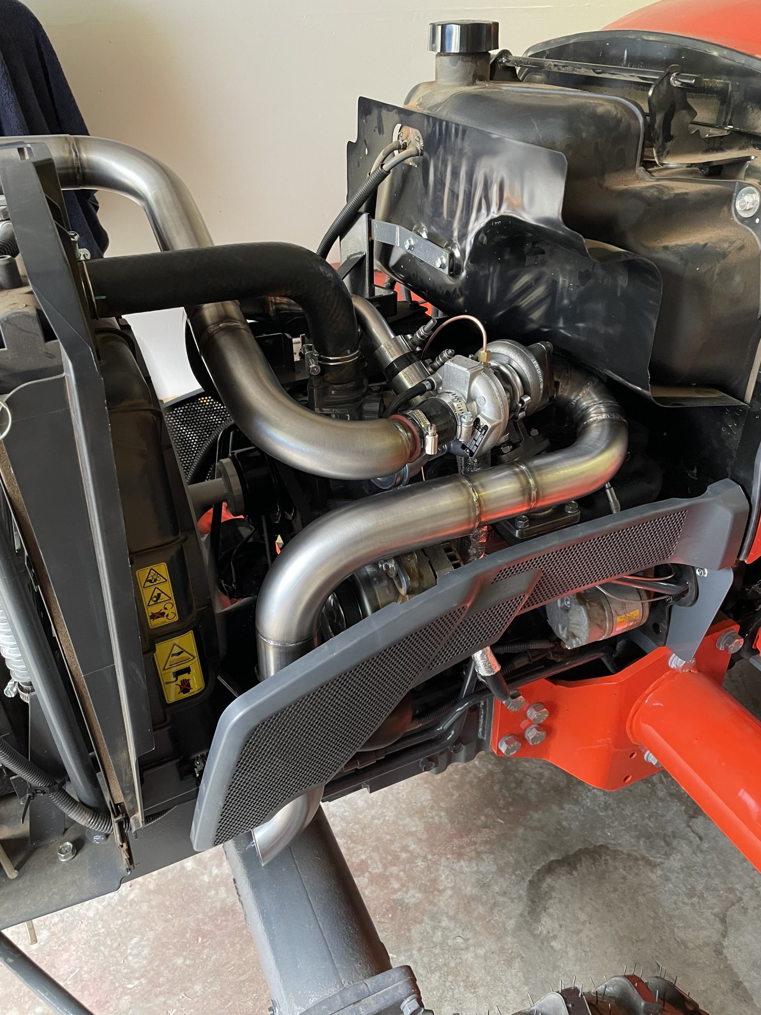

Or, you could always install one of these on your L2501 and not worry about it anymore;

I wish :love:
That would require time and money that I don’t have (n)
Installation of the Turbo system is straightforward and takes just a little over an hour. Gaining access to the fuel adjustment screw takes another hour. So roughly 2 hours total for installation.
Money? Everything costs money, unfortunately. But, all things considered, it’s cheaper than alternative tractor upgrades and a lot of everyday implements.
