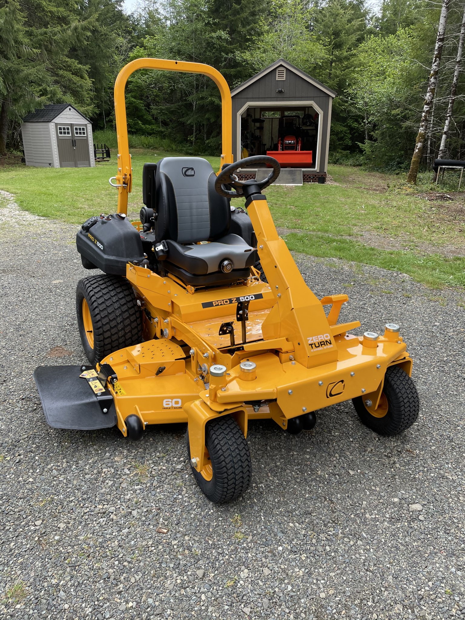

If you decide on going with a ZTR and your property has steep hills and hillsides like mine, I’d recommend something like the Cub Cadet Pro Z 560S like I have. The Pro Z does an amazing job, it’s fast, super safe and built like a tank.

That’s a sweet mower! If I could justify something like that it would be great, but I would tear up anything but a rotory cutter or flail mower on my property.
Thanks!
My property is pretty rough too. I have to replace blades every year as I move further and further into undeveloped forest with a combination of clearing and ZTR maintenance.
