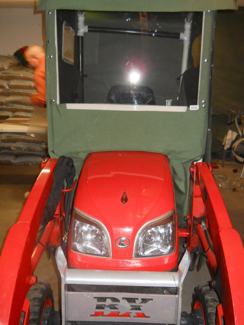

these are all great. i just used pvc, velcro and snaps the windows are lexan and the cover is a waterproof material i have, she isn't much to look at, but it works, less than 50 bucks.....

Thats actually not a bad looking cab Humpheydo! It gets the point across, keeps ya dry and I would immangine warm too. Best of all like you said under 50 bucks!

Wow, under $50 bucks.... Can you please post some more photos .... It looks really impressive. Now that it's built is there anything you would Change to improve it?
