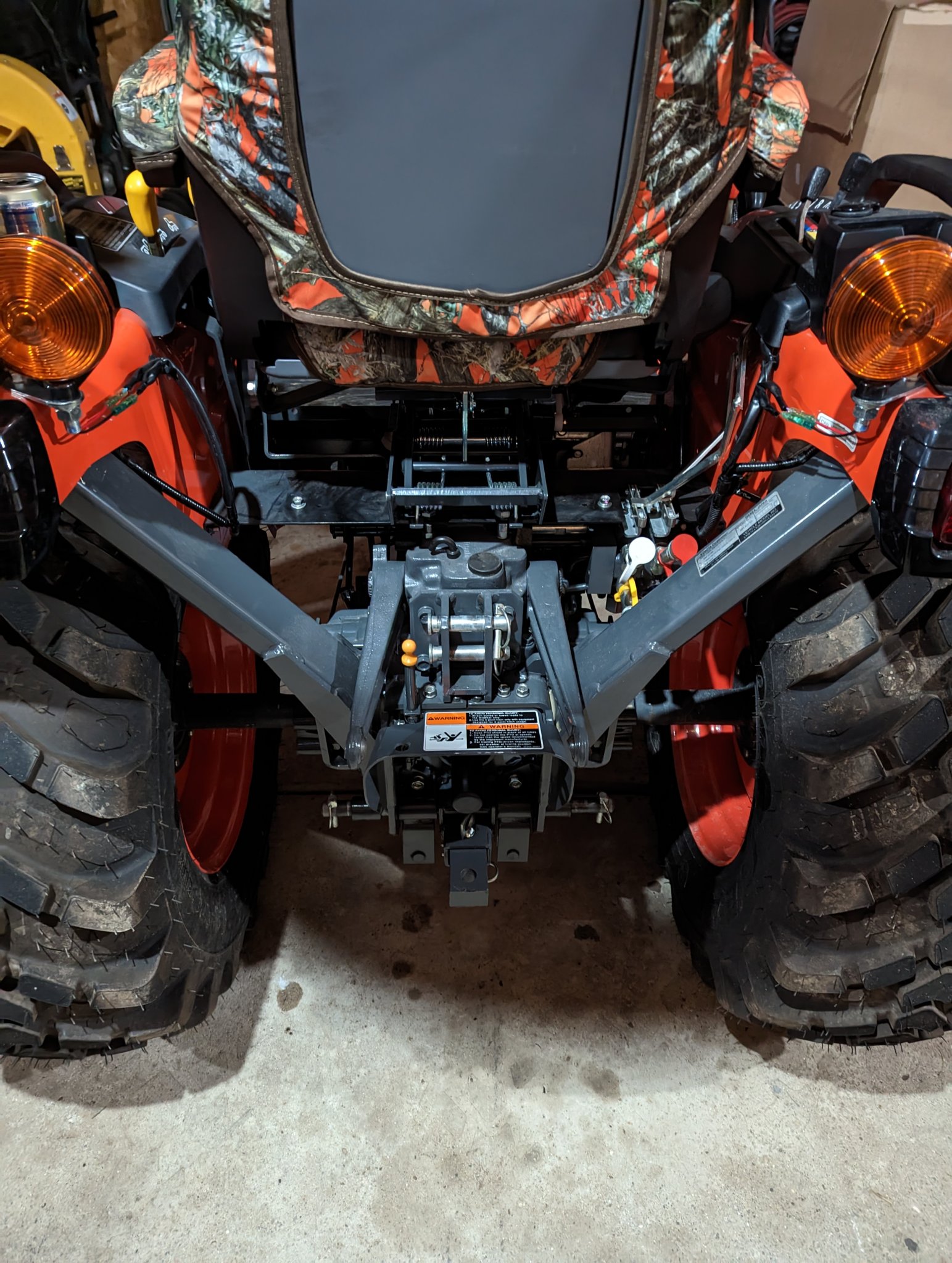

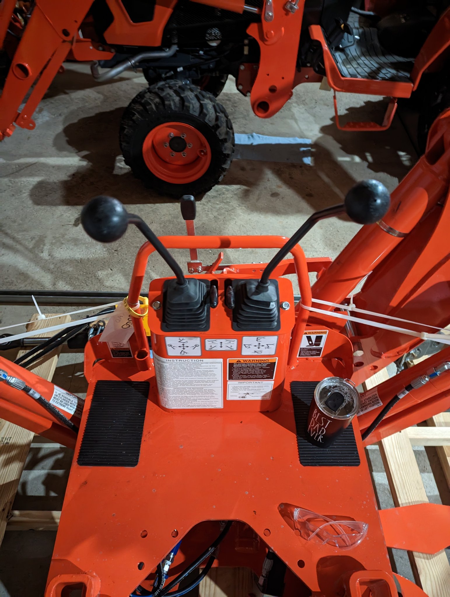

I didn't update this thread with progress and did in the "what did you do to your Kubota today?" thread. So here goes:

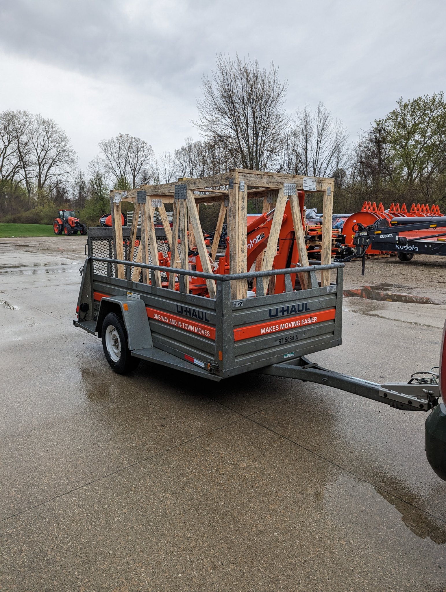

Picked up yesterday, fit in a 5x9 single axle.
Drove it to the house, maneuvered into the garage so I can uncrated it.
Installed the longer Joysticks

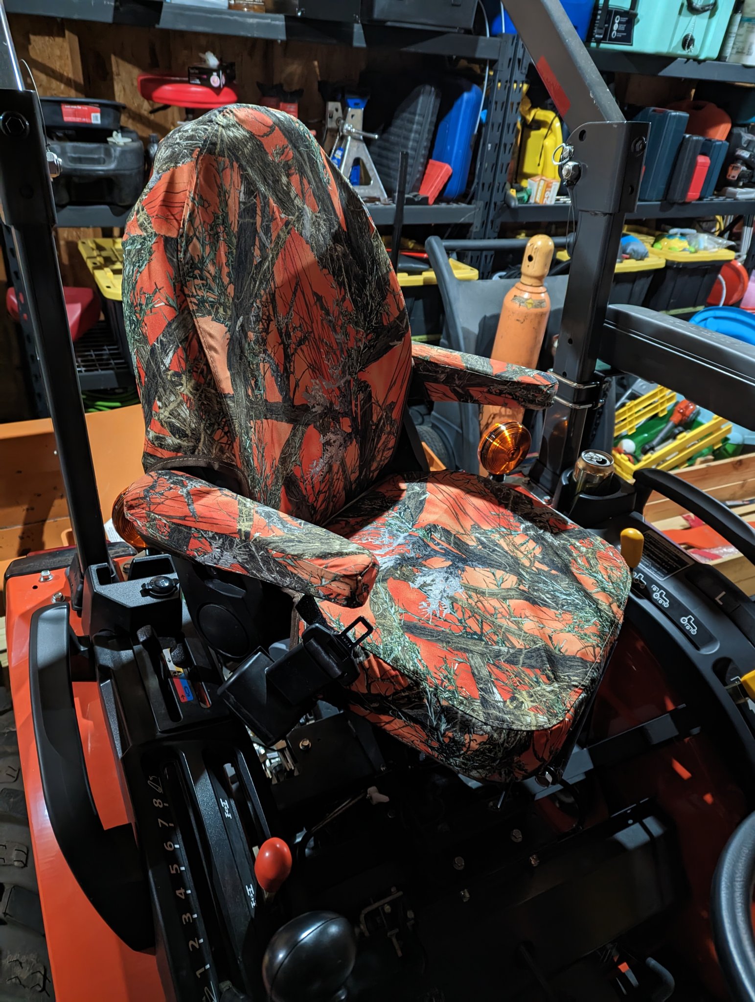

Installed the swivel seat on the tractor - if the directions were clearer for this, it would have been a lot easier. I spent 30 minutes searching for the seatbelt spacers they were referring to only to find them in the hydraulic hose washer/gasket bag.
Removed the 3pt

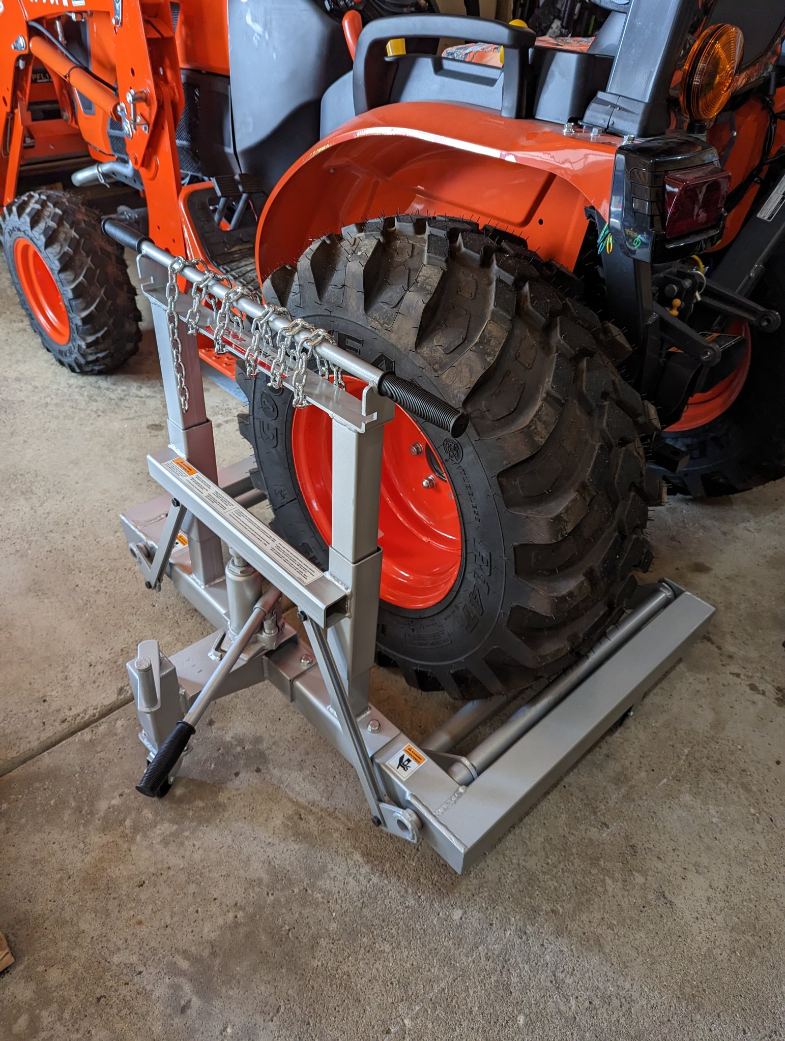

I am still in shock and awe that I bought this tire jack on eBay for $150. This thing is SOLID - weighs about 200lbs. Looking forward to removing my loaded tires with ease. PXL_20230427_194431887.jpg

I am still in shock and awe that I bought this tire jack on eBay for $150. This thing is SOLID - weighs about 200lbs. Looking forward to removing my loaded tires with ease. View attachment 101194
Went to remove my tire today and realized I didn't have a 22mm socket for the lugs... Oh well, it's cold and rainy here in MI today so I'm not too upset.
The tire jack does work very well and can lift the rear end of the tractor by itself (not that I would go that route).

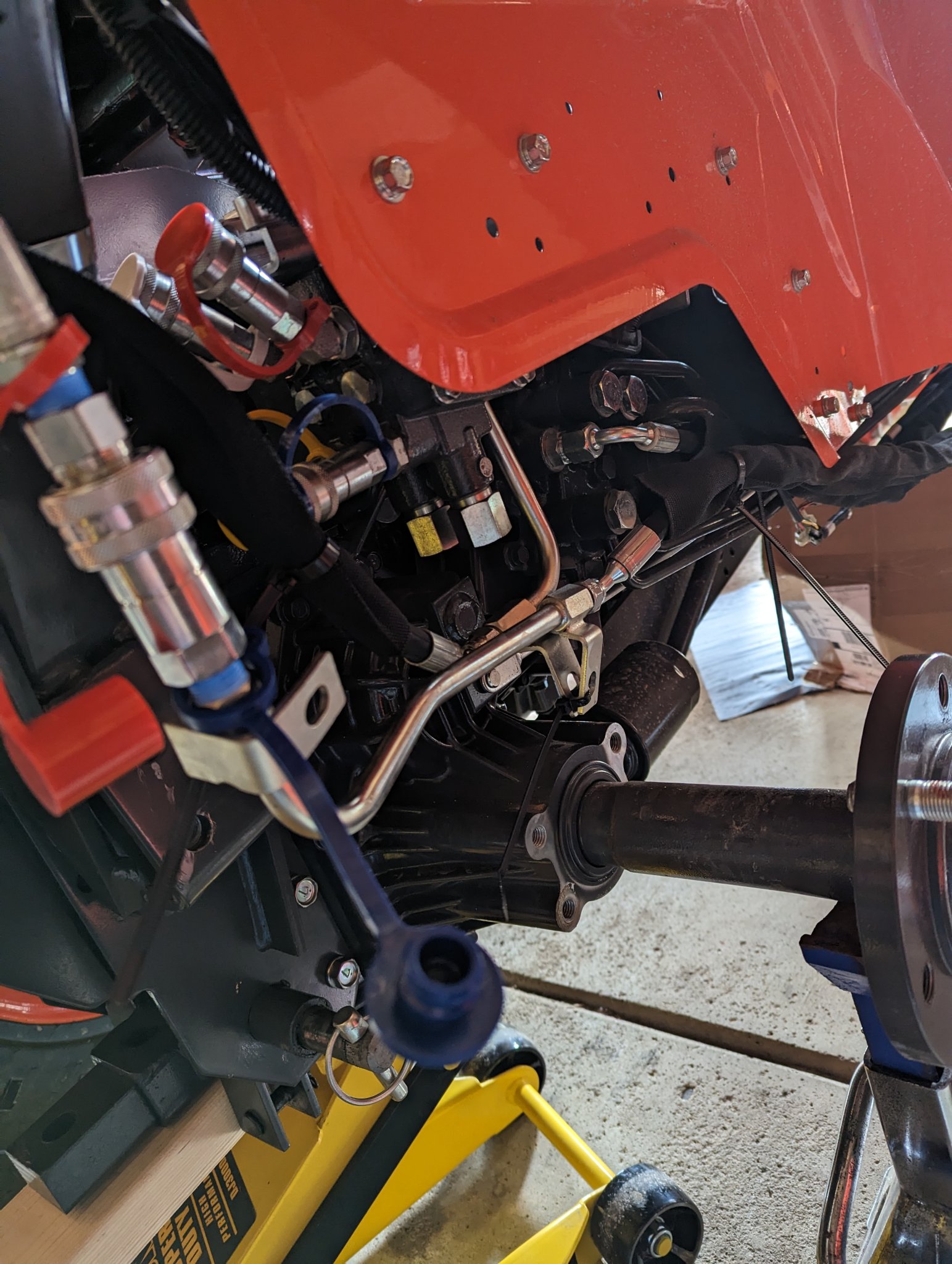

Started taking things apart today.... Installed my hydraulic hoses and went to mount the subframe to the loader frame and noticed the mounting flanges do not line up... What the hell??

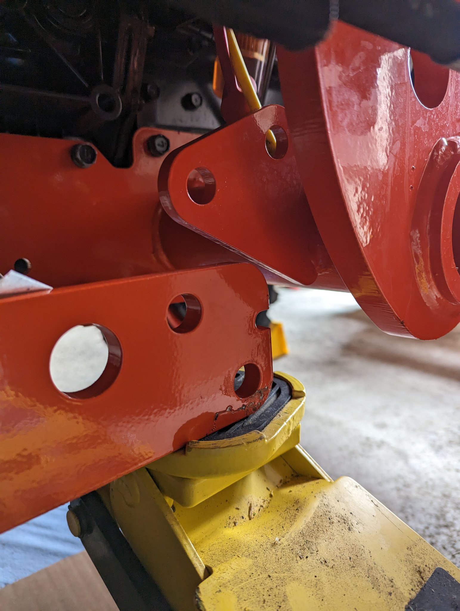

The "drivers side" flange looks fine. The "passengers side doesn't make any sense... PXL_20230429_185446312.jpg
There can't possibly be a different loader subframe for a third function kit. Did I get a defective loader frame??

For whats it's worth. From looking at a few google pictures of loader mount frames etc to me looks as if the triangular plate with the two holes is welded on upside down on the offending side.
I agree with you 100% after looking at the LA535 manual and the BH77 install guide. What a joke, must be April fools for me.
I MAY be able to talk the dealer into throwing my subframe on as an add-on to the warranty work I'm going to need now to disassemble and reassemble the front loader subframe.

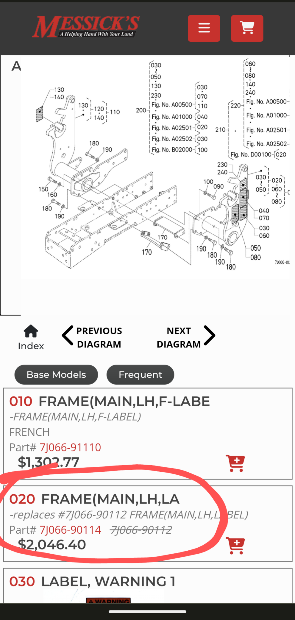

My issue is with my loader now because the damn backhoe subframe mounting flange on my loader subframe was welded upside down at the factory. I wonder if the loader and backhoe are made in the same place? If so, then I agree with your statement of moving production (preferably to Japan where quality control is infinitely higher).

Holy shit, this is a $2000 part...
