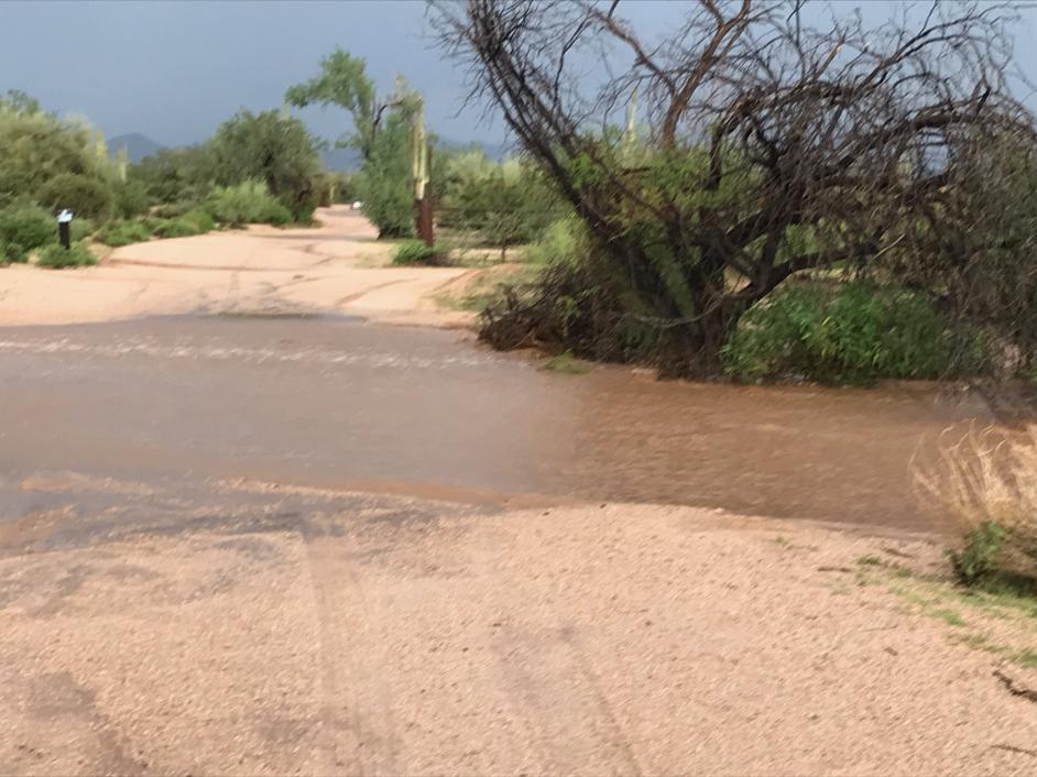

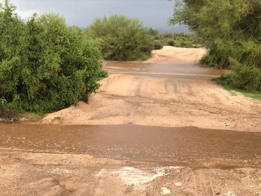

As luck would have it, we received significant rainfall today.
Are you allowed to manage the stormwater?
My first inclination would be to install culverts in the areas where water runs across the road.
RipRap along the sides where it runs parallel with the road and then a culvert where is crosses...

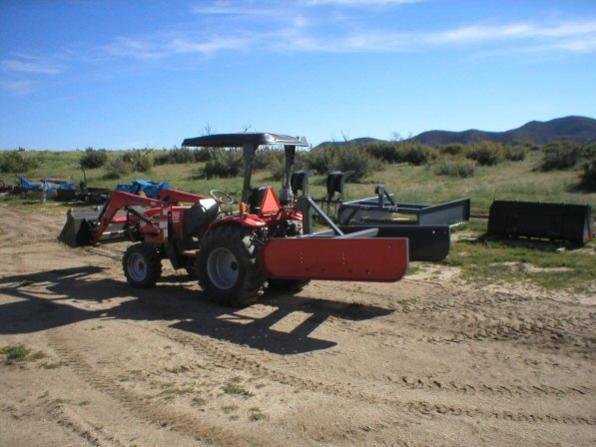

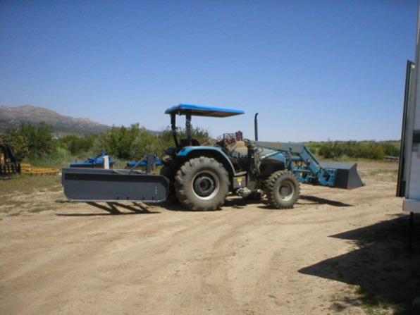

Unless you have time to burn which maybe you do, forget about anything smaller than an M series or equivalent. Will the smaller machine do the job, absolutely, but more than twice the time though.
I have a 32 HP tractor, the LPGS is 5' wide and 800lbs.
My 75 HP tractor's LPGS is 7' wide and 1400lbs.
I maintain over 1 3/8 miles of road and about a mile of fence line.
I understand not wanting to deal with the water. A lot of work and expense, so don't.
Get the right sized tractor and LPGS and just make the road smooth when needed. Make improvements later if you change your mine.
I have 3 types of implements for maintaining my roads, LPGSs, hydraulic rear blade and roll over box blades. My smaller tractor can do the job, that's for sure, but my bigger tractor does it a LOT faster and easier.
I have other things to do than just grade.
