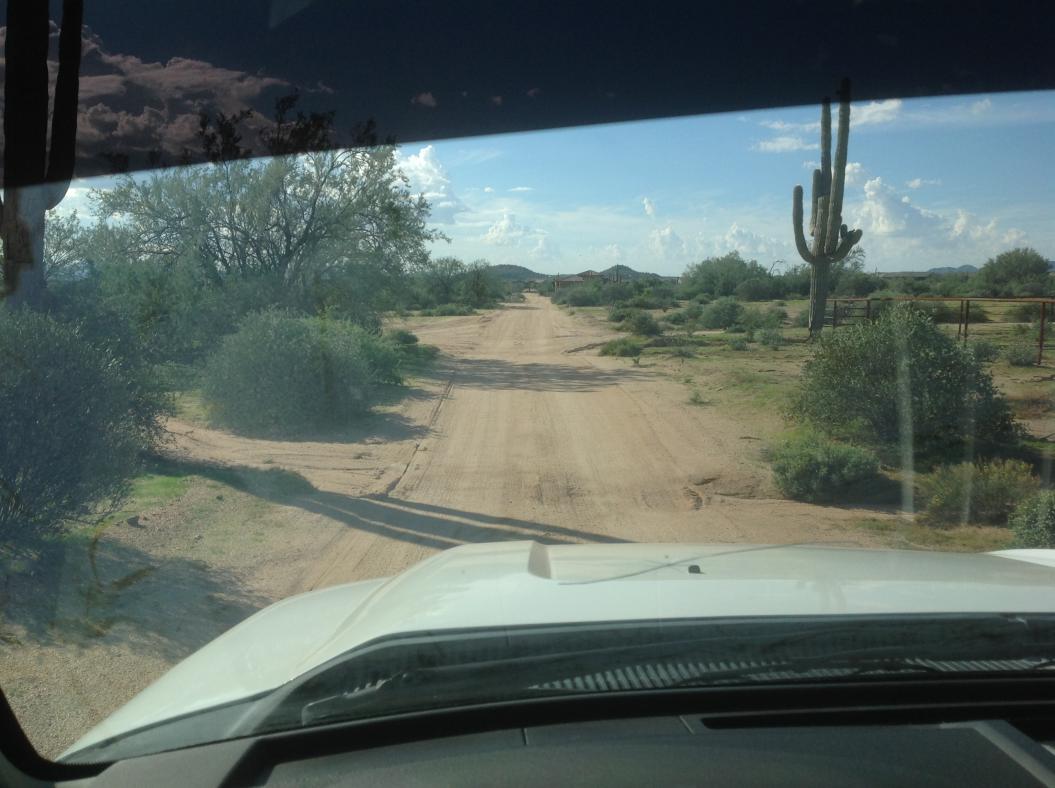

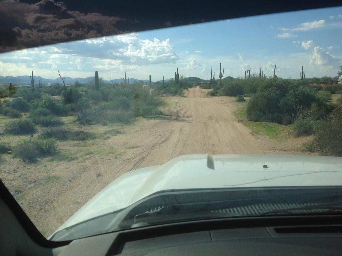

First post here guys. We live down almost a mile of AZ desert dirt road that gets washboarded when dry and also cut up when raining. The rains flows quickly downhill across the road and leaves deep ruts in some areas and excess sand in others. The ground is very hard during the dry months so I'm not sure a compact tractor box blade or scraper could cut through the surface. What do you recommend for smoothing out the road? I have my own preliminary ideas after reading through several forums and watching online videos, but would like to hear from the people here that have been there and done that.

Currently I have no tractor, just a 3/4 ton 4x4 pickup. There is little to be done about water rushing across the road, when it rains water flows quickly through the washes and any small dip becomes a mini wash. I'm thinking filling the ruts with material after heavy rain is the only practical solution. The wider washes get filled with so much sand that delivery and trash trucks have gotten stuck.

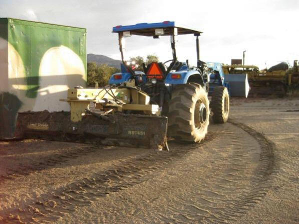

Well, to start with, nothing under 50HP in my opinion. What is considered a large compact tractor. I would be looking at a tractor larger than that myself. Something in the full size utility class. Assuming since you are asking in a Kubota forum that you are considering a Kubota. Look for something in the M series tractors. You can get by with a larger Grand L or an MX, but an M series will get the work done easier and faster.

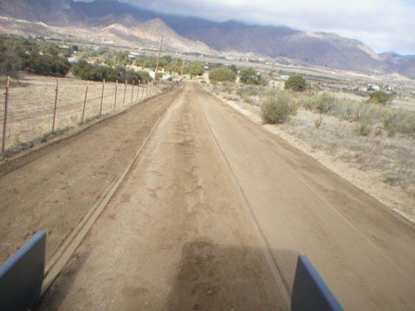

First implement to get is a LPGS. (land plane grading scraper) something up around or preferably over 1000lbs. While this is not a good implement for shaping the road, it is definitely the implement to maintain it once it is shaped how you want it. I would actually use the LPGS to start with just to get the ground all smooth and evened out. It is much easier to then use a rear blade to shape the road how it needs to be shaped to deal with the water the best that it can be without spending a fortune.
Depending on what tractor you end up with, but I would say either a 6' or 7' unit would be a good match to maintain your road.

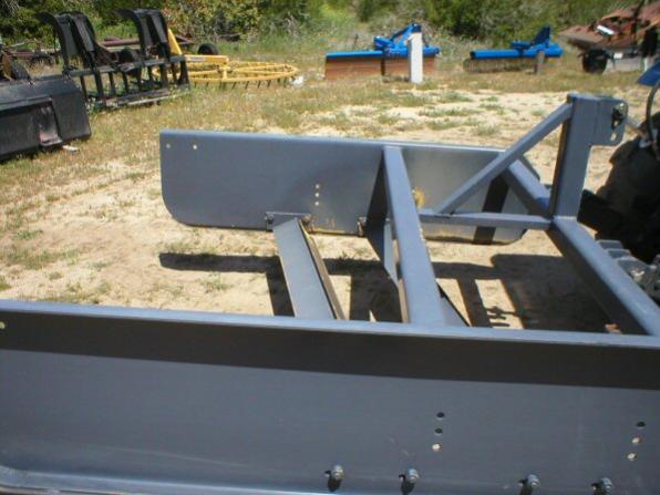

Once you get the road smoothed out, a good hydraulic actuated rear blade would be the implement of choice to get everything shaped up how it needs to be. Something 8' wide and a minimum around 800lbs. Be sure to get skid shoes with ANY rear blade that you get. They just make grading easier.
