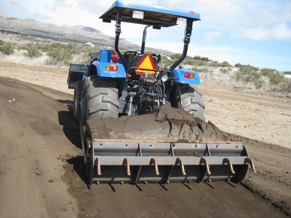

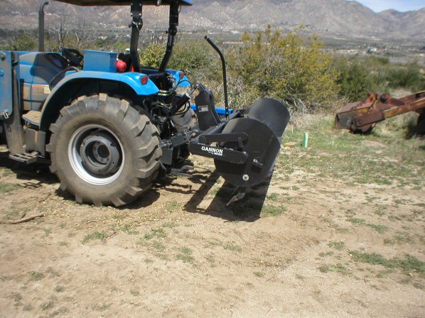

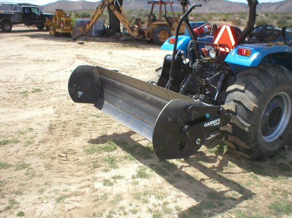

I have always been partial to ROBB (rollover box blades) Nice to have the scarifiers set in place in seconds vs stopping and doing each ripper one at a time or paying the astronomical price for hydraulic actuated scarifiers.
I believe my 1000lb, 81" wide unit was the last ROBB unit built by Gannon.
Dirt Dog has a similar unit available.
