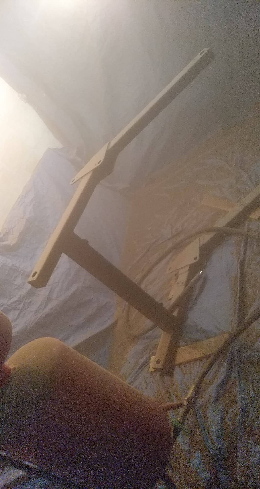

Hello.

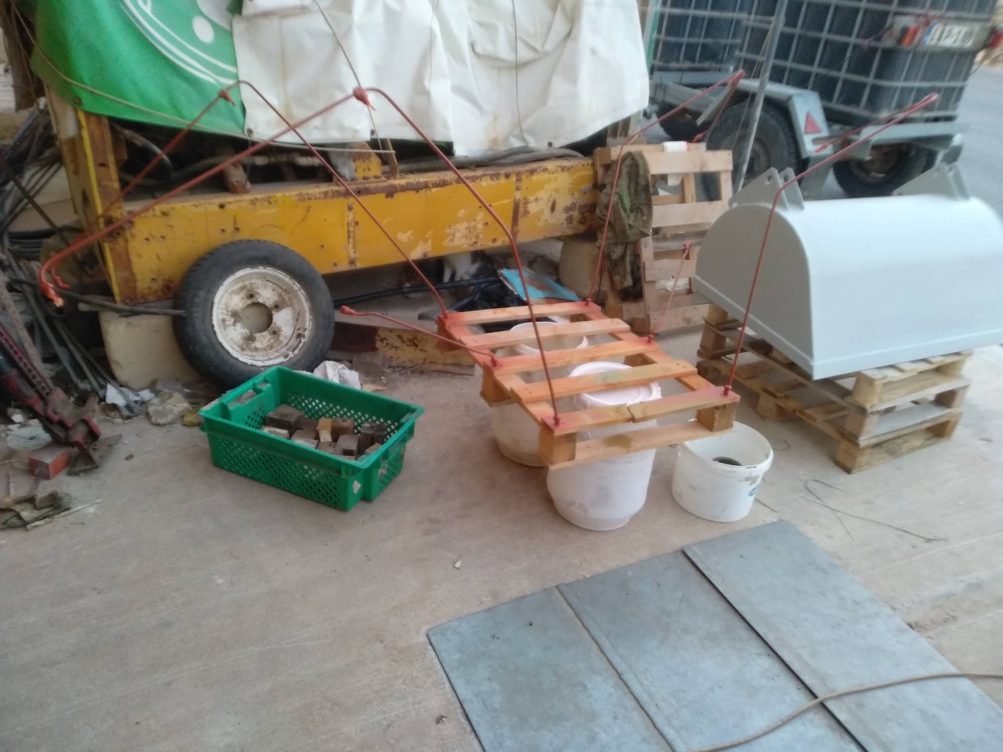

First of all sorry for the late replies. I have been very busy in real life. It has been nearly a 2 year effort to sort of come to an end. I made it a point to get it painted this summer so I started tackling it from Jun. In my little free time (after work/farm work/animal duties). Paint is alkyd big mistake as scratches easily and fades but cheap and easy to get to touch up even if orange like red fades quickly. I got to give it 4 light coats of 1 primer, 1 undercoat and 2 topcoats. Since they are oil based I had to wait a bit before applying the following coat even if most of the time here temps were as high as 40 degrees Celsius and most o the parts were left outside to dry.

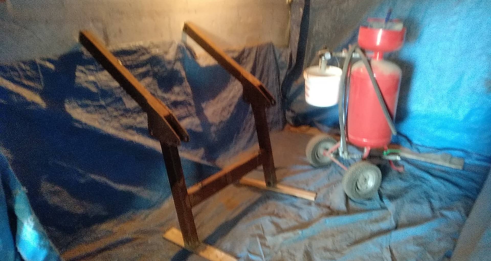

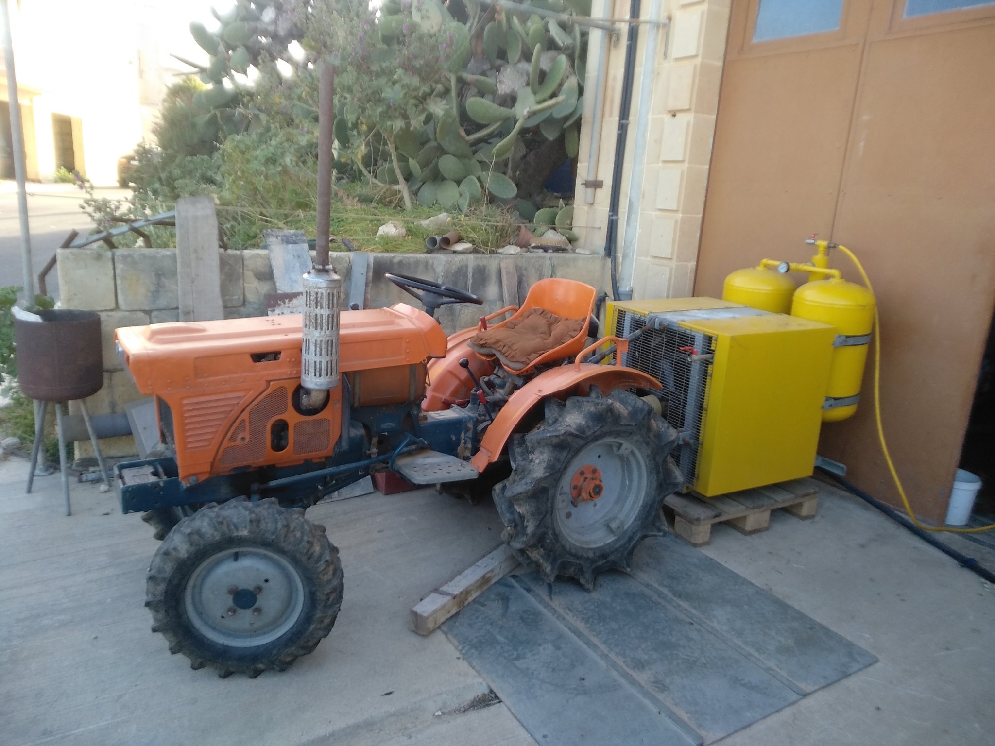

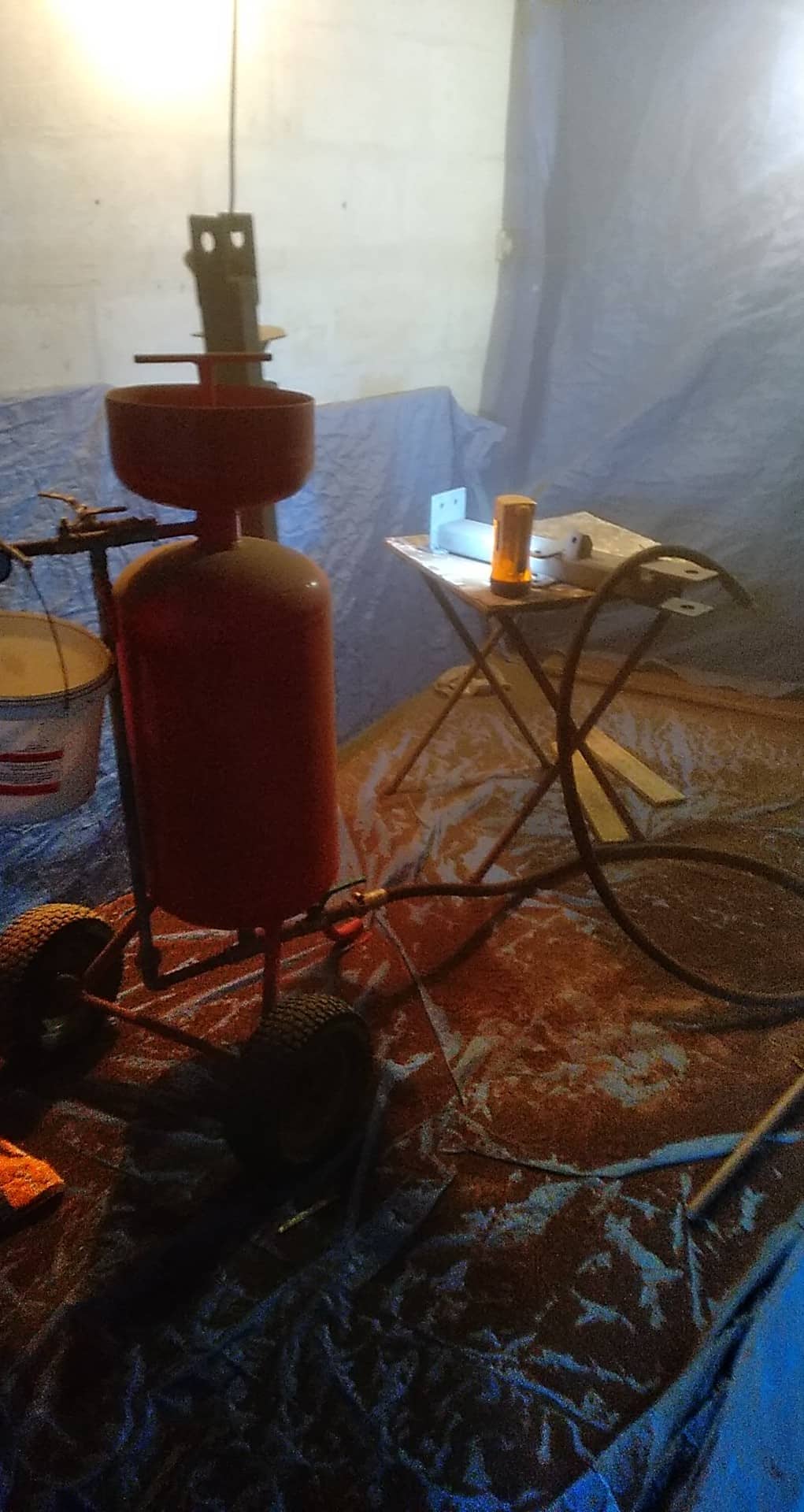

Since it was rather rusty I sand blasted most of it. 😇. All in house with own designed Pot and Compressor. It is quite a feat for the tractor to run it as it is a big bore - operated by a 15hp electrical motor. First stage compressor is almost 6" in diameter and Second stage is 3". Yes, The tractor struggles a lot but i try running it in short goes (1 to 2 hours). It is big enough to maintain a steady supply of air at about 5 bar which i think is the best for Garnet grit. It was also a never ending project :D

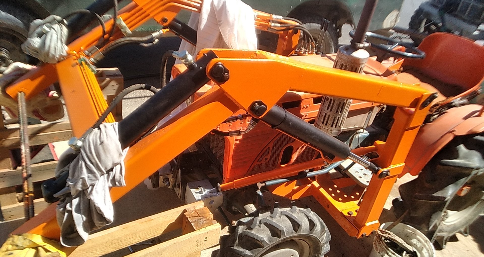

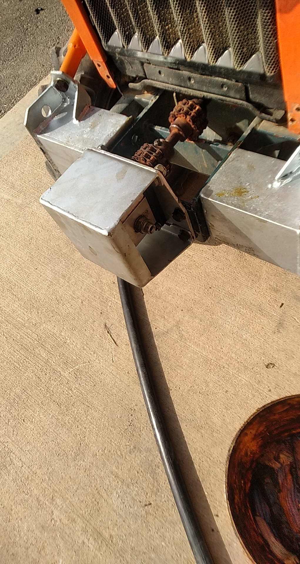

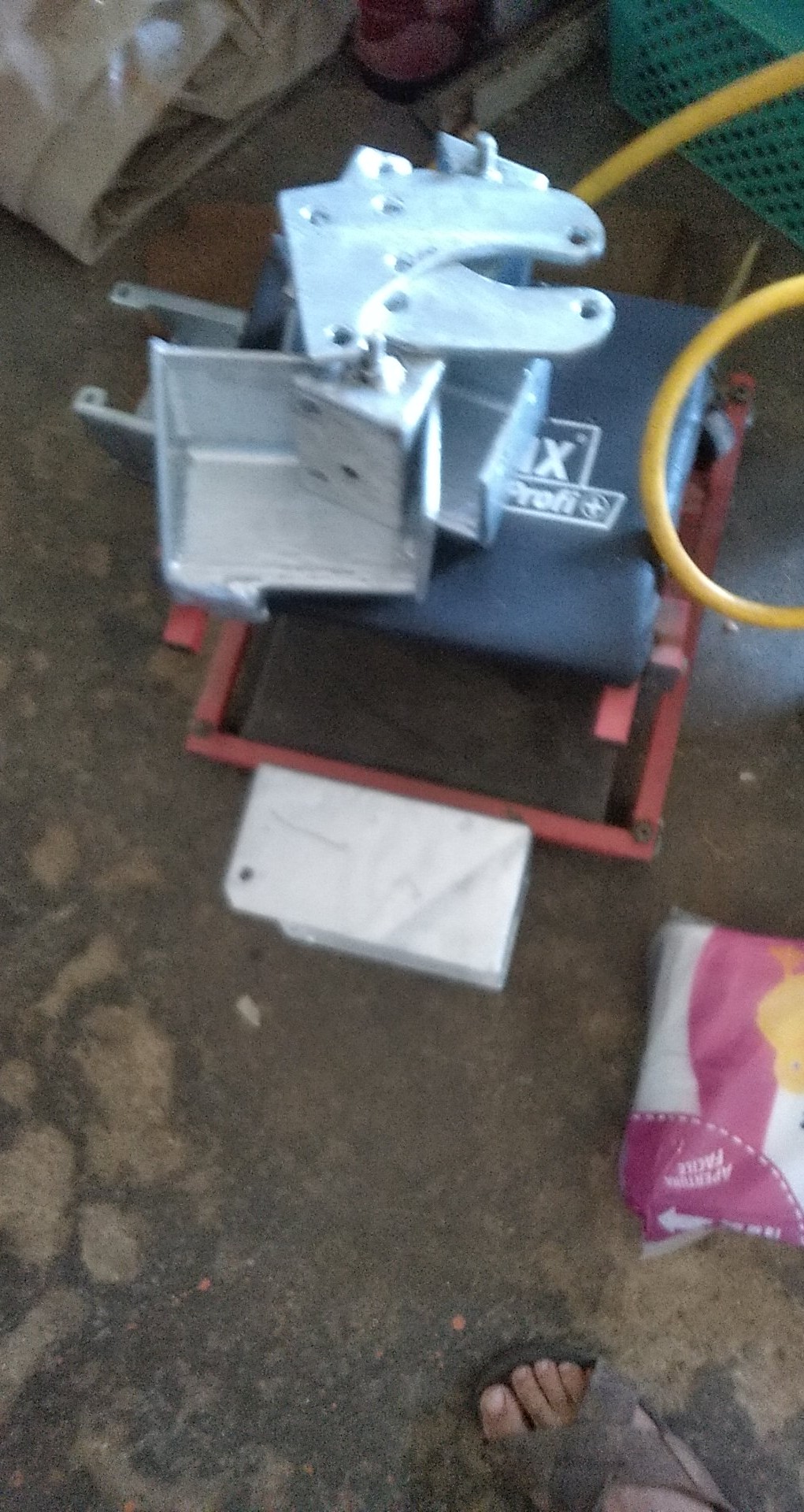

Some bits went for galv. Including pump guard which was done in haste over the weekend to make it on time to galv it. No time to test fit arm movement as they were out hanging in the sun soaking up uv rays. Sadly the guard fouled the hydraulic lines so I had to chop it :(
With regards to avoiding engine running loaded and hot due to extra stress related to pump at the front. I will detach arms and keep the subframe and tank and controller on. Just undoing the hoses from controller and screwing in plugs. Hoses are too short to add quick release. Since pump is connected by two chain couplers I can undo them and pump stays on but disengaged. I think it should work fine and Loader bits that stay on add some stability to the tractor when pulling the trailer or baler.
With regards to pump size. I think that I sent it back to the UK and the company agreed to resend me a better suited pump with no extra charge in exchange of the one I had bought . I forgot if I asked for a smaller pump. The speed of the loader is ok in my opinion and an adjust by revving up and down the engine.
I am not very technical and have no hydraulic training so it is mostly hit and miss and asking for advice here and there and online. Even with welding and spraying. I have lots of cavitation since I was very very focused on proper penetration in crucial points that I over did it ( most of the work was done with an invertor welder with 3.2 welding rods.
Cheers joseph

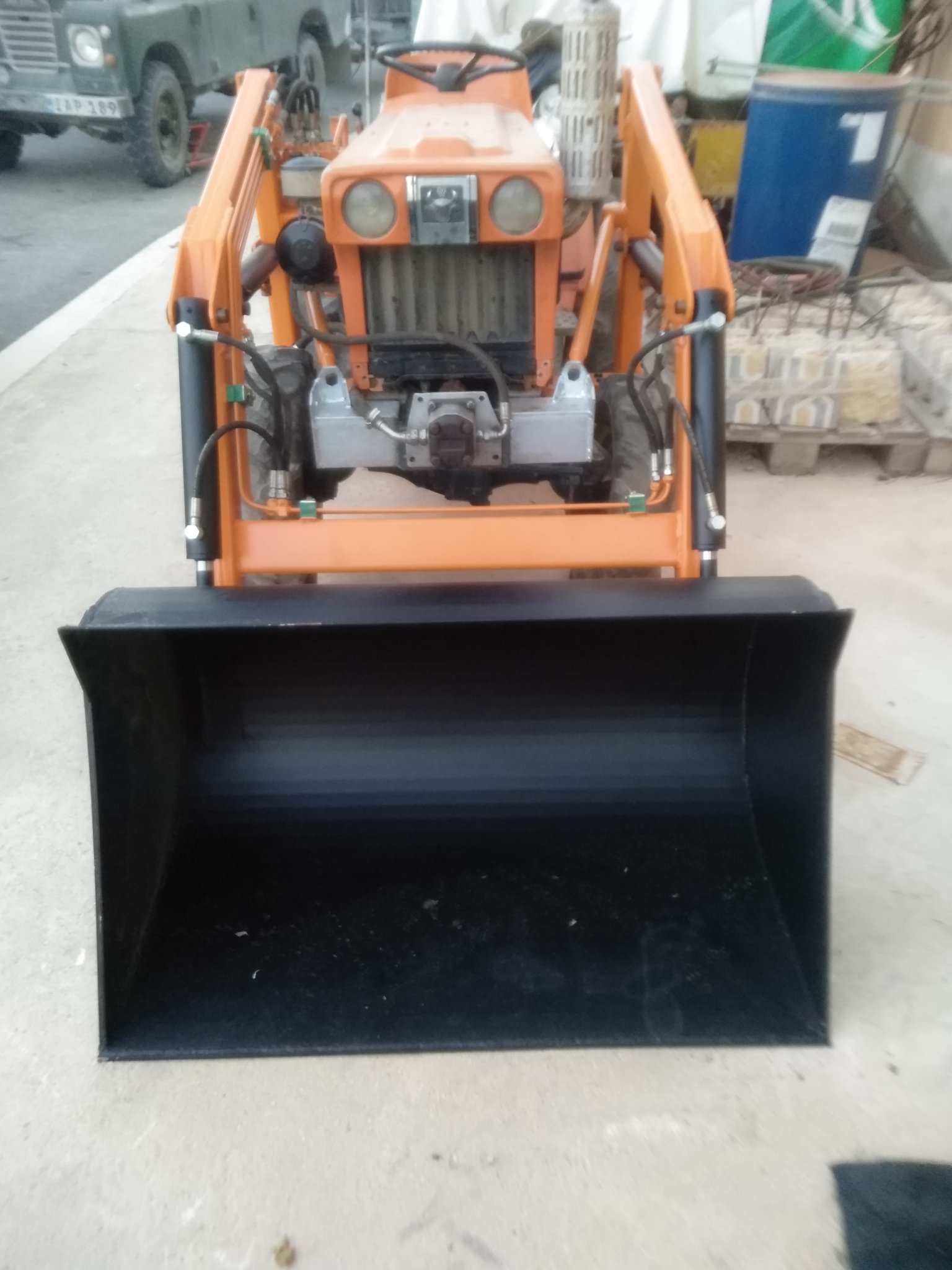

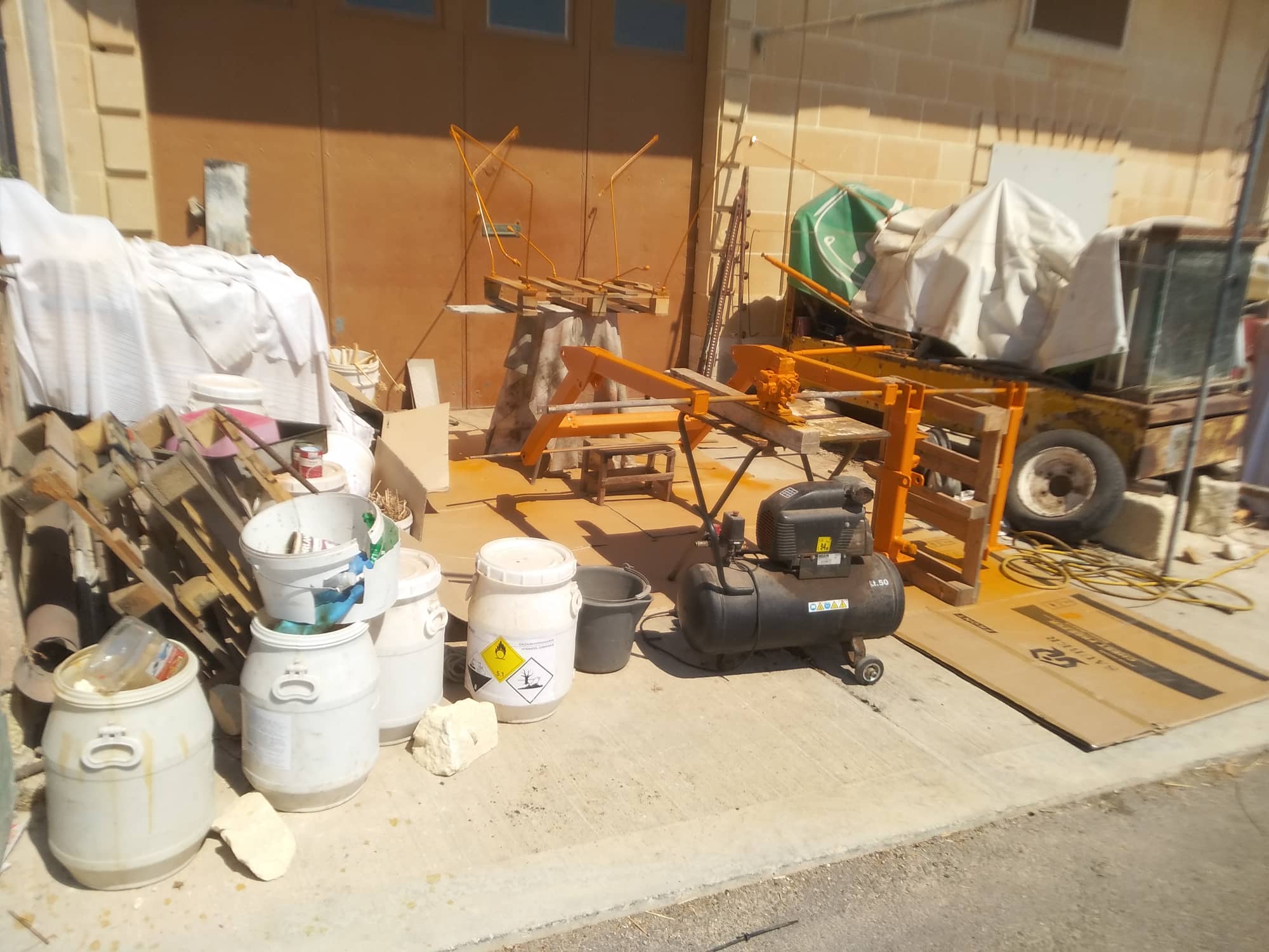

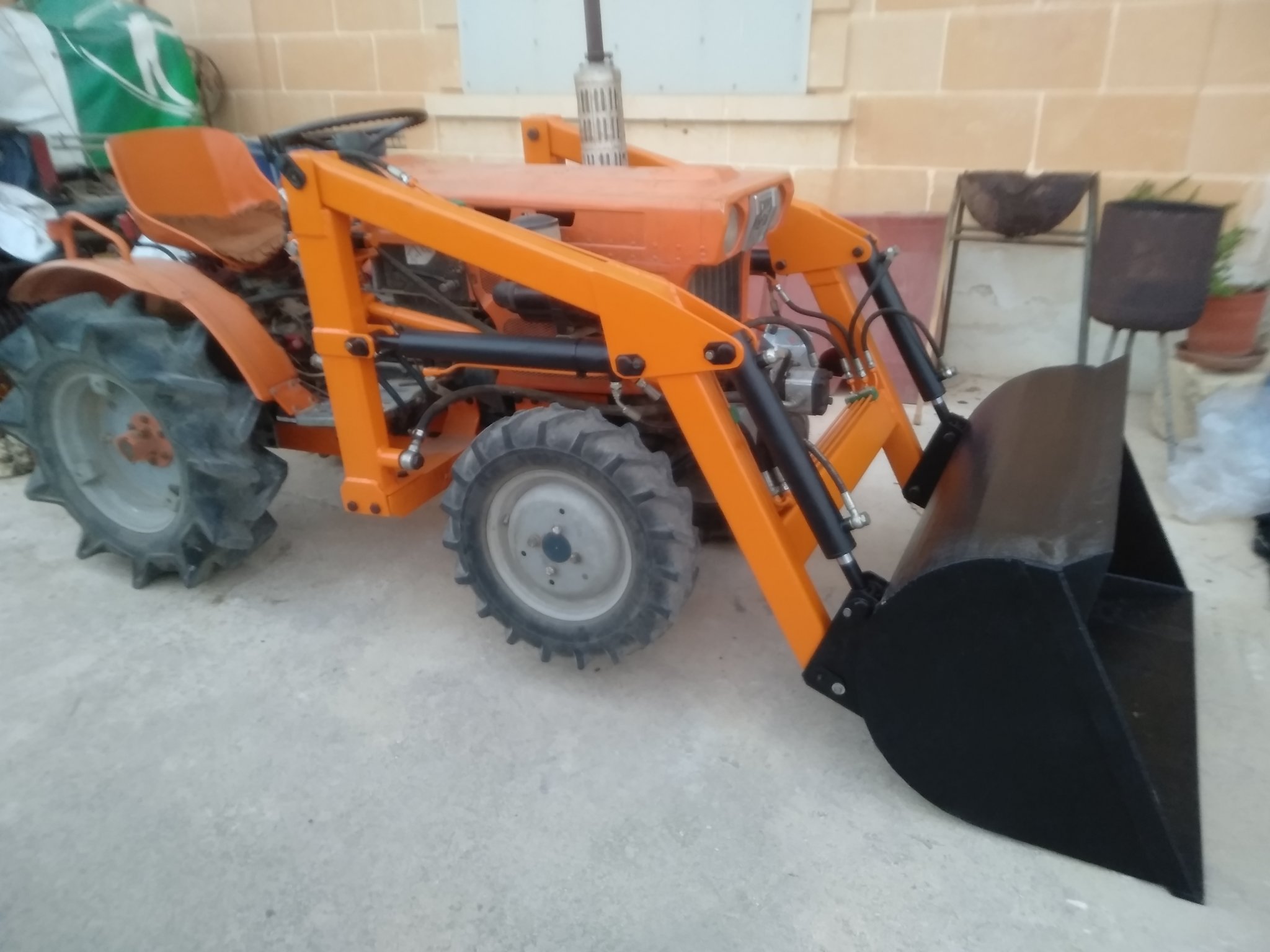

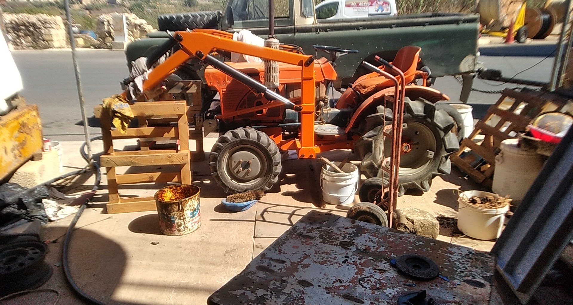

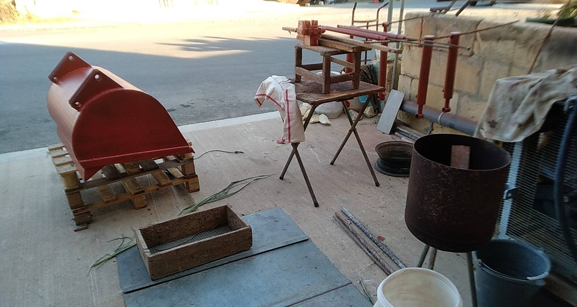

More photos, I cannot upload videos but the bright yellow thing with 2 upright tanks in the background is the PTO driven compressor. I need to paint up the modified guard and install the bucket and off to play :)
7,860
3,095
Nicest homebuilt FEL I've seen.
Well done!
