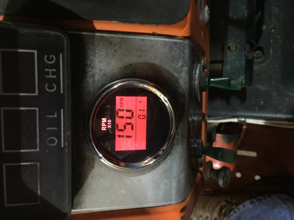

Good morning all, since my B8200 HST has an alternator and not a generator I no longer have a tach. I purchased a digital tachometer and a proximity hall sensor.
https://www.amazon.ca/ELING-Universal-Digital-Tachometer-Backlight/dp/B0755JF9FK
https://www.amazon.ca/Yosoo-NJK-5002C-Proximity-3-Wires-Normally/dp/B01LX0J9H4
I have installed the proximity sensor that take a reading off the engine front crank pully. With all the wiring connected I turned on the ignition and the tachometer lights up with all 8’s then goes to 0 RPM and 0.0 hours. Then start the engine and the RPM stays at 0. I attempted to follow the instructions for adjusting the tachometer readings by pressing the button on the back, went through all the settings in increments of 50 from 1-300. No change, 0 RPM.
The proximity sensor was bench tested and once the engine is running the led on the back of the proximity sensor is on.
Any ideas of how to test the tachometer on the bench?

You guys are correct about a magnet. I had installed a magnet glued to the pulley at the correct distance from the proximity sensor prior to the original post. I have now also noticed the hour meter internal to the gauge is also not counting. I am good no to try and contact the seller to find out if the gauge is just faulty.

An update.
After a couple of emails with the seller of this tachometer, I got enough information to hook it up properly. I asked what type of sensor is required for this tachometer and learned that it needs an AC signal to work. The proximity sensor that I tried supplies a square wave DC signal, so it wouldn’t work. So, to get the proper signal YouTube was my friend. The “W” tap off my alternator was not there. I opened up my alternator and connected a wire to one of the coil ends before the diodes and bingo, a working tachometer.
This was really easy to do after having enough information to actually connect it up.

The tachometer has a setting button on the back that I needed to adjust. The instructions said to set the tachometer to the number of poles in the alternator. Once the idle speed displayed was between 600-800RPM, I was at the correct setting. Full factory throttle displays 2700RPM.
