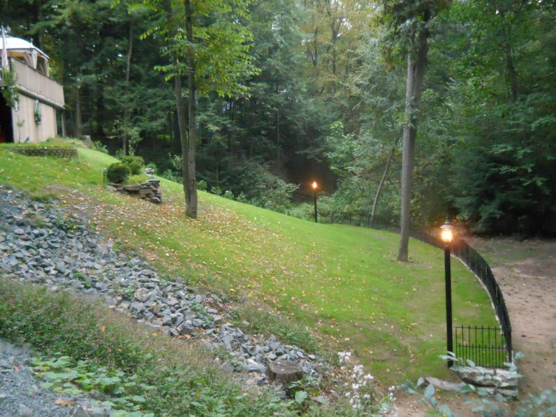

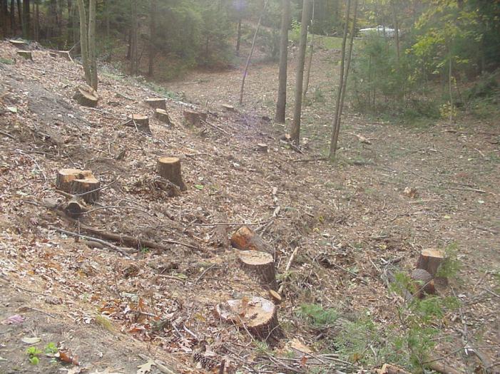

Wow, Humpheydo, that's an inspirational before and after! Look great. And Bcbull, it's cruel to talk about 72 degrees in December (actually, we hit 50 in Maine today -- what a "winter"!). Thanks for the replies -- my backhoe can definitely cut through the frozen layer of soil, but I was afraid I might be overworking my machine. On the other hand, the guy from the dealership who delivered it said I should "drive it like I stole it", so he was encouraging me to just go for it and not baby the machine.
