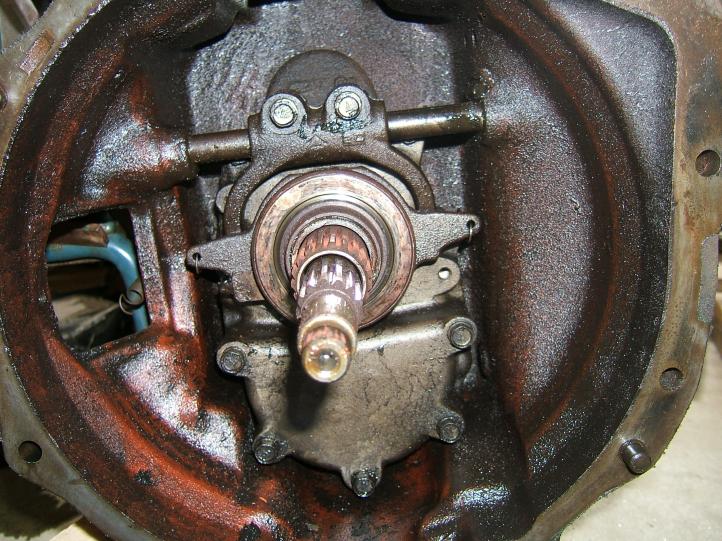

Well, "SLOOOWLY" has turned out to be slower and more involved than I had originally hoped. After looking at all the pieces and metal shavings on the bottom of the casing I decided to take the rest of the tractor apart back to the fly wheel "just" to see what I might find. It fought me the whole way but I got it apart.
What I have learned:
The PTO engaging gears were pretty chewed up - accounting for some of the extra metal in the case. Lucked out and was able to trade some spare parts with a friend that had an extra set $$$ saved.
The steering was loose so I had already planed to service it while the tractor was down. Three bolts were loose on the steering box, one ready to fall out.:eek:
Had planned to rewire the tractor anyways. Now with everything apart it will be easier.
Now the shocker! Looks like I am in for some clutch work also :mad: and $$$. Need to replace the PTO clutch plate, (something got between the flywheel and clutch plate and chewed it up, explane's the PTO gears), through out barring, resurface the flywheel, replace the bolts that the
through out barring rides on when clutch peddle is depressed and maybe the hub clutch release.
Questions:
The
hub clutch release, should there be any play up/down - side to side if any? I have a small amount.
Kit, nut& bolt item # 35290-14600 = $67.36 each and need three. (Colman Equipment)
PTO Clutch plate #382560-14450 - $93 (ebay).
Through out barring # 38430-14820- $33.24 (ebay).
Any idea where I can get them cheaper?
Also, anything else I should be doing while I am this far into this simple repair and eating my Ramen noodles for dinner?
I will be servicing the breaks, changing some O rings and oil seals, and is there anything else in particular that I should not over look?
I really hope NOT to be tearing into this tractor this far again as long as I have it which I hope will be for a while to come.
